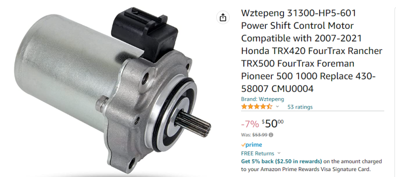

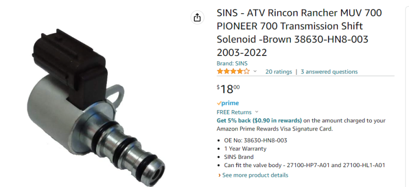

My Honda Rancher TRX420 gets stuck in whatever gear I'm riding in after 20-30 minutes. It has an electronic shift.  It started several months ago but is getting more frequent.  If I turn the engine off, put it back in neutral, and restart it, the gears will shift properly for another 10 minutes or so.  Any ideas?
You should try to diagnose the problem before fitting parts. Since it fixes it for a bit by switching off and on again it sounds to me like it will be an electronic(PCM) problem, rather than a mechanical or electrical(wires, switches,,electric motor) problem
