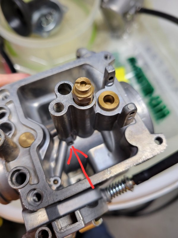

I took the carb back off, and cleaned it again this time soaking all the parts overnight. Once installed, it started much easier and idled great. However it still stalls if revving the engine above 1/4 throttle.

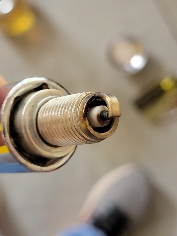

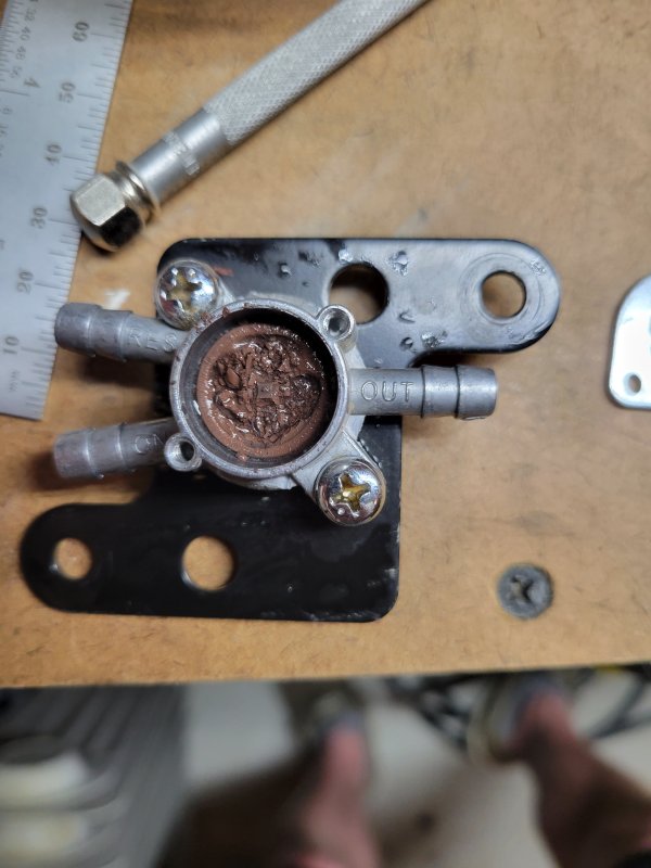

I'm going to check the spark plug, and remove the fuel filter. Beyond that I'm stumped as the idle/air adjustment screw is blocked off from the factory. I'm sure I could remove the cover and adjust it but this was a running quad so I'm hesitant to think it needs a carb adjustment.

Does it die as soon as you open the throttle to 1/4, or does it start to rev and then die after a few seconds ? And it does die right out does it ? The engine stops running ?
At 1/4 throttle the things controlling the fuel are the main jet, the emulsion/discharge tube, and the slide and needle..  Check the short discharge tube(if it has one), which sits on top of the emulsion tube is there, and the right way up. Check the needle is held in the slide.
If it takes a few seconds or more to die out though it could be because the fuel level is going low in the bowl, in which case it could be a blocked filter or float needle jet.
I think I would replace the plug and fuel filter and see if you have adequate fuel flow to the carb. It still sounds like fuel delivery
