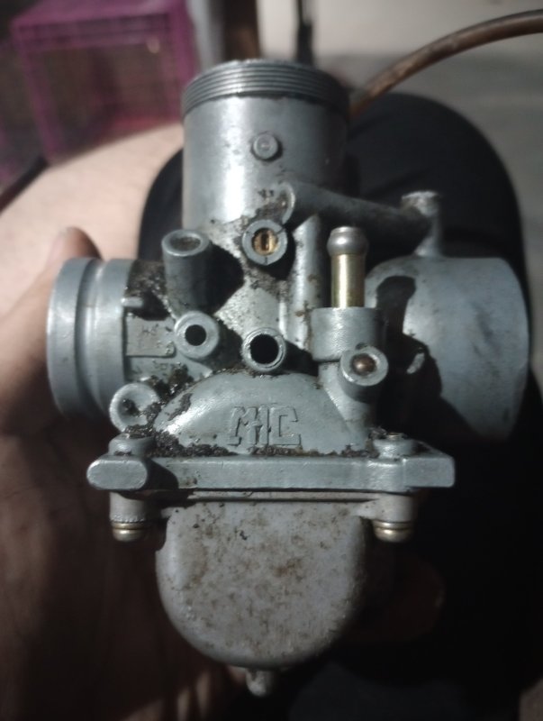

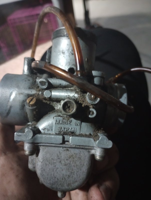

It's flooding fuel leaking out on the ground between riding it I think the needle isn't seating iv have it apart and cleaned it and tried messing with the float arm now it will run until u put the air box back on and it's blowing fuel in there and choking it out
