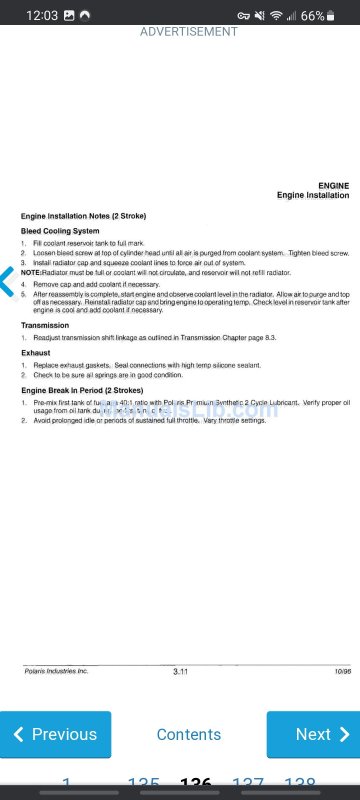

From the manual posted it said the bleed screw was at the top of the cylinder head.
Yeah, if it has one I would think it would have to be in the cylinder head somewhere!
