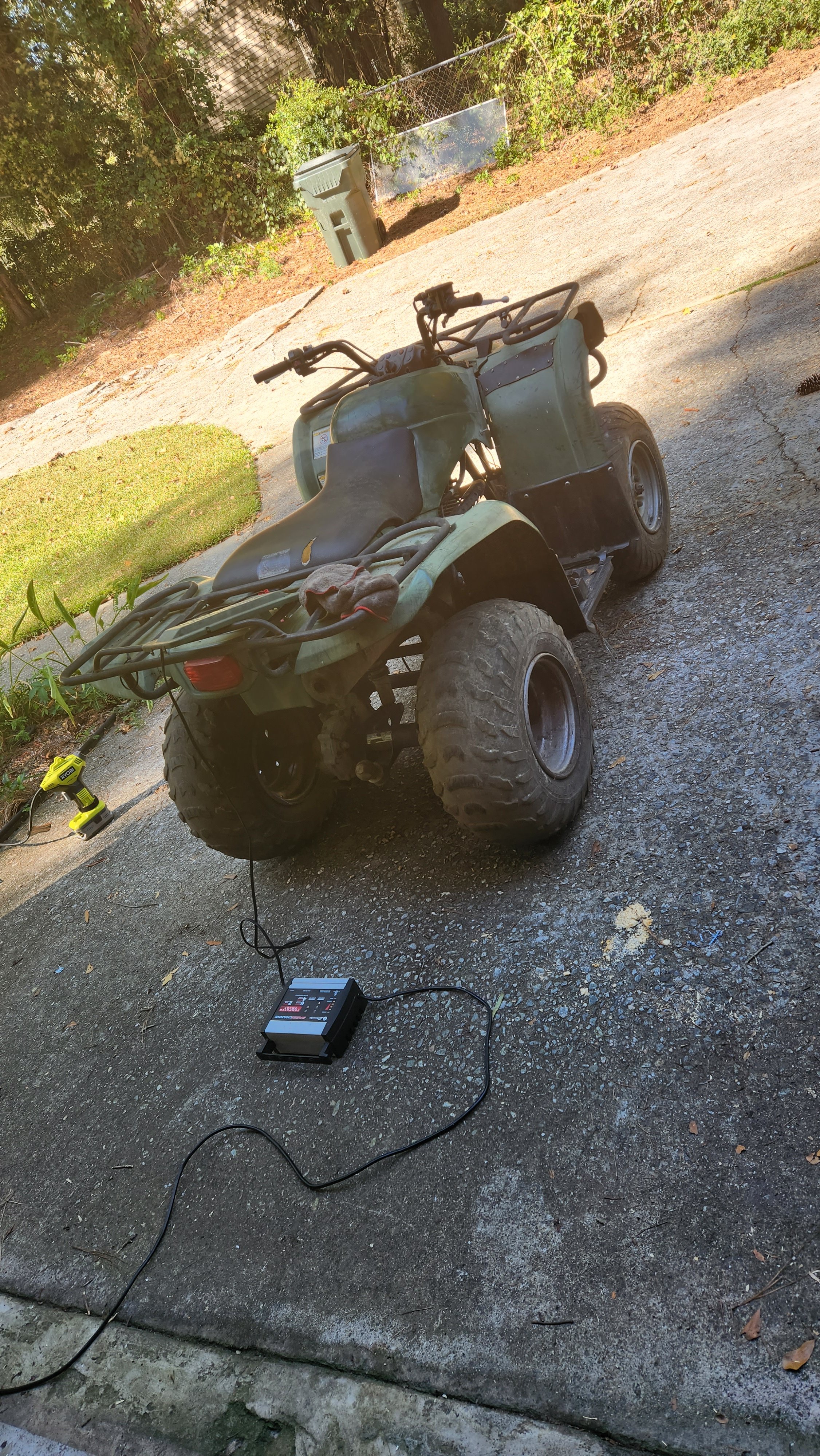

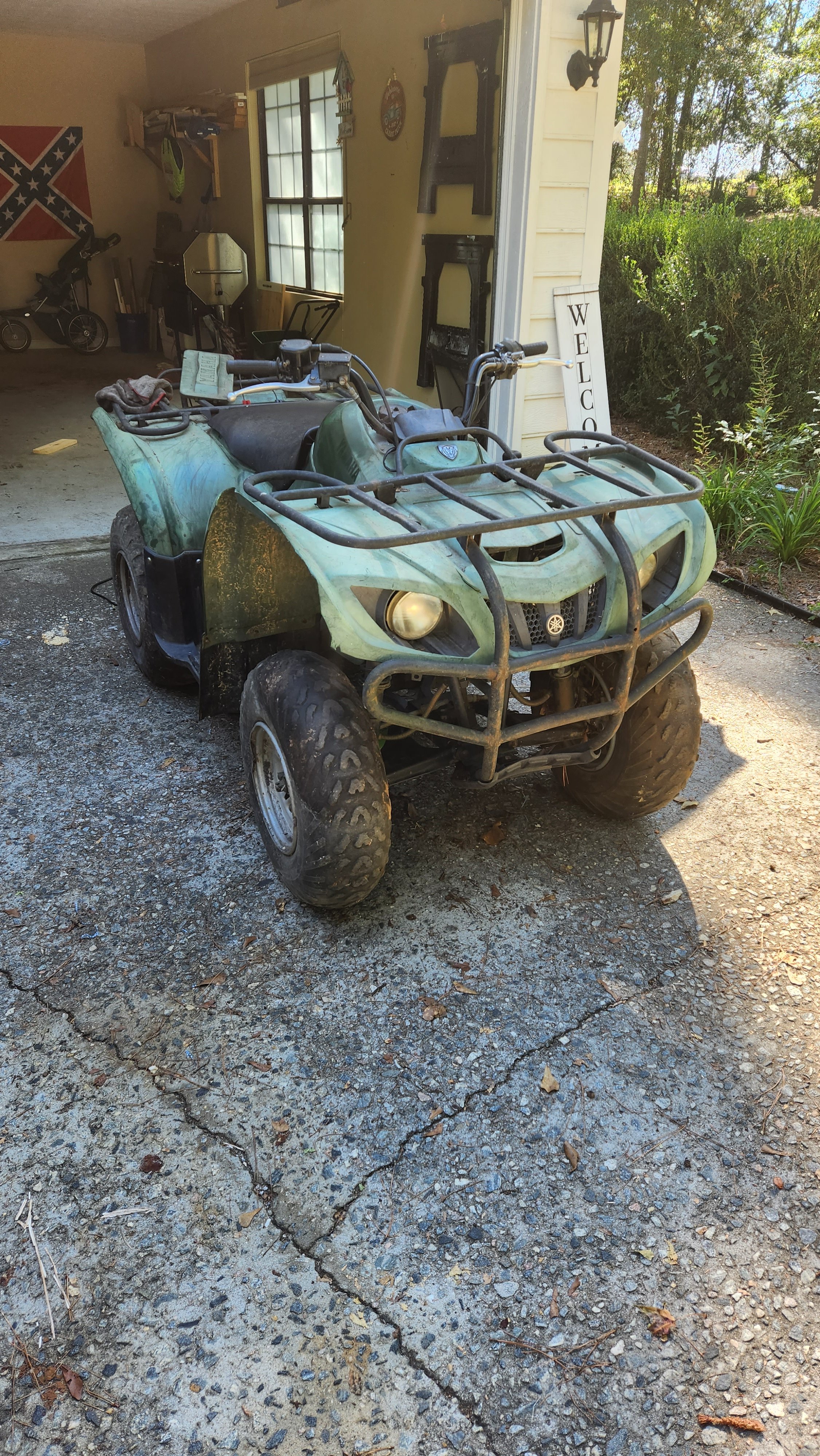

I have a 1988 Quadrunner 250 2wd. My brother in law sold it to my son for $20...had been sitting outside for several years. Got it home and had it running in about 30 mins. Ran it a bit and then went to looking at the carb as it was having trouble idling. Was getting it pretty close, then started losing spark...Also, it wouldn't start up every time...only about 1 in 5 tries. Anyway...now, it has what I can only describe as "intermittent" spark. I can get 1 light spark right when the start button is pressed and sometimes one when it's released...but none while cranking. 🤷♂️
