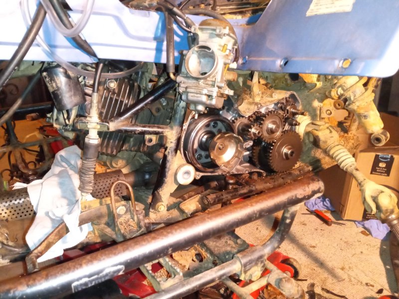

So I pulled the stator cover off and pulled the flywheel (which I should add to get at the stator cover I have to remove the rear tire and a arm as well as remove the bolt through the front of the engine. And the exhaust system has to be removed to pull the cylinder as the exhaust guard is bolted to the side of the timing chain tensioner. Stupid setup. Glad the king quad doesn't have that.
So I got everything apart and the flywheel off. New timing chain (nice and tight now) put the head back together and flywheel but it is quite hard to turn the engine over. I can but with difficulty. When the valve cover was off it seemed to spin much more freely. Before I tear everything back apart and start again any ideas on what it is?

So I have come to admit my wrong and in the event anyone else is suffering a similar issue.
I put the starter gear on backwards lol I switched it around and now everything is working as it should. Putting the stator cover back on now and we will see if she will fire up then
Good you caught that , glad to hear everything is working. We have all been there, look at it this way you wont make that mistake again, its part of the learning process. Good luck, and keep us informed.
