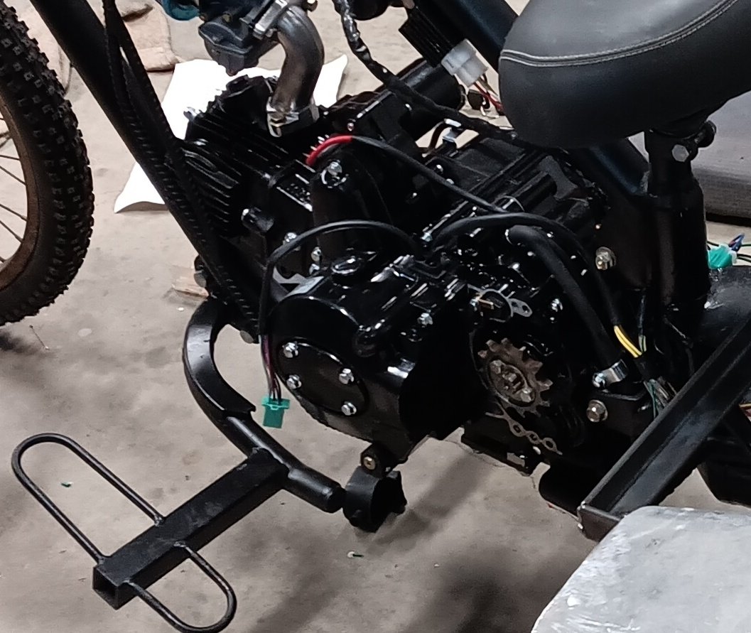

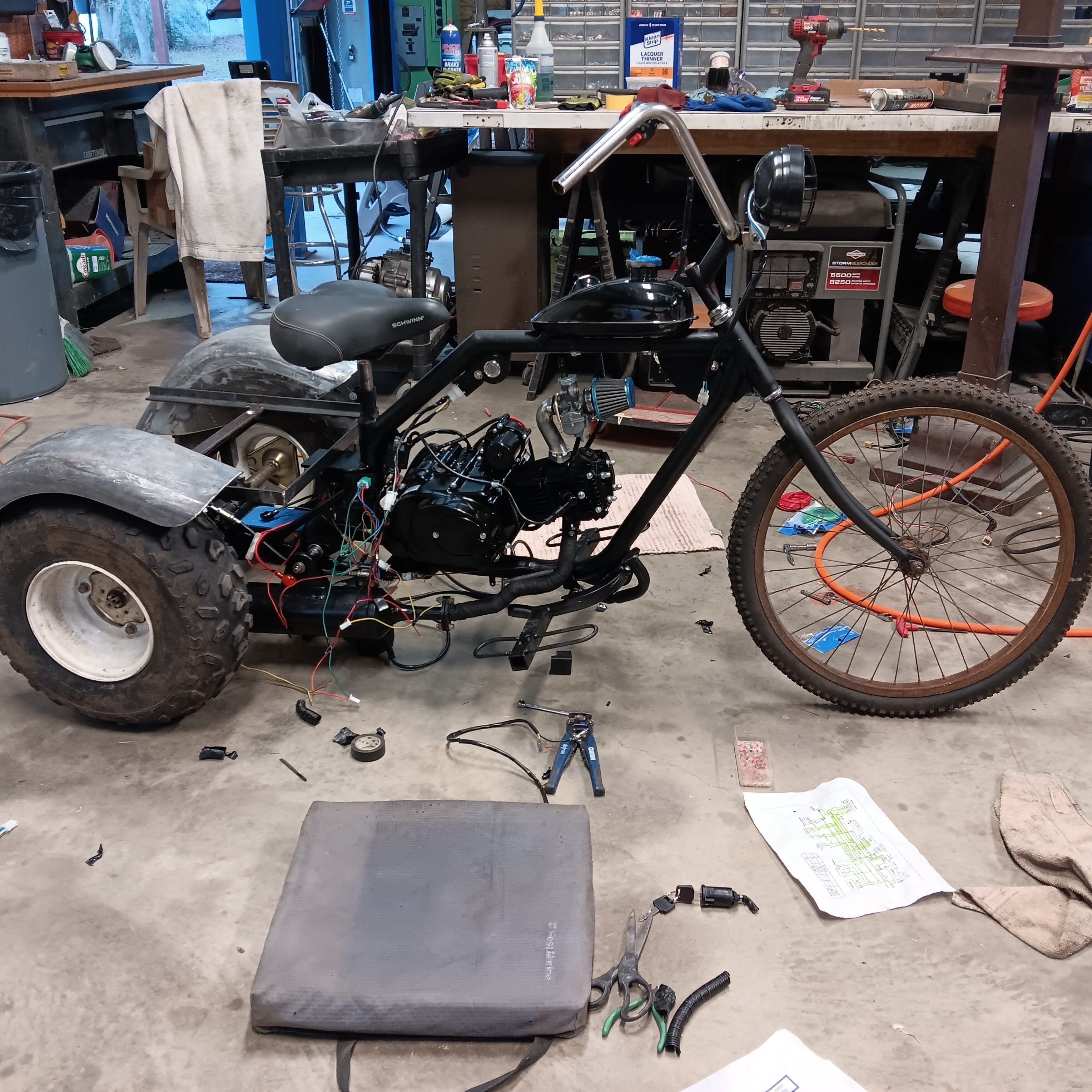

Hello guys, I hope I am not invading your space, but as you can see the current state of my project here it's not but about 50% ATV. I am hoping that some one here can point me to a wiring schematic that I can reference since the "Complete wiring harness" i purchased from Amazon did not include a diagram of any kind.
The ones that I am finding on line vary greatly but none show the connections for the separate 5 wire connector coming from the motor.
Can someone tell me where these wires go?

I gotta say though that you need a better front wheel. The spokes in that aren't going to be strong enough, and the wheel bearings aren't good enough for that use either.

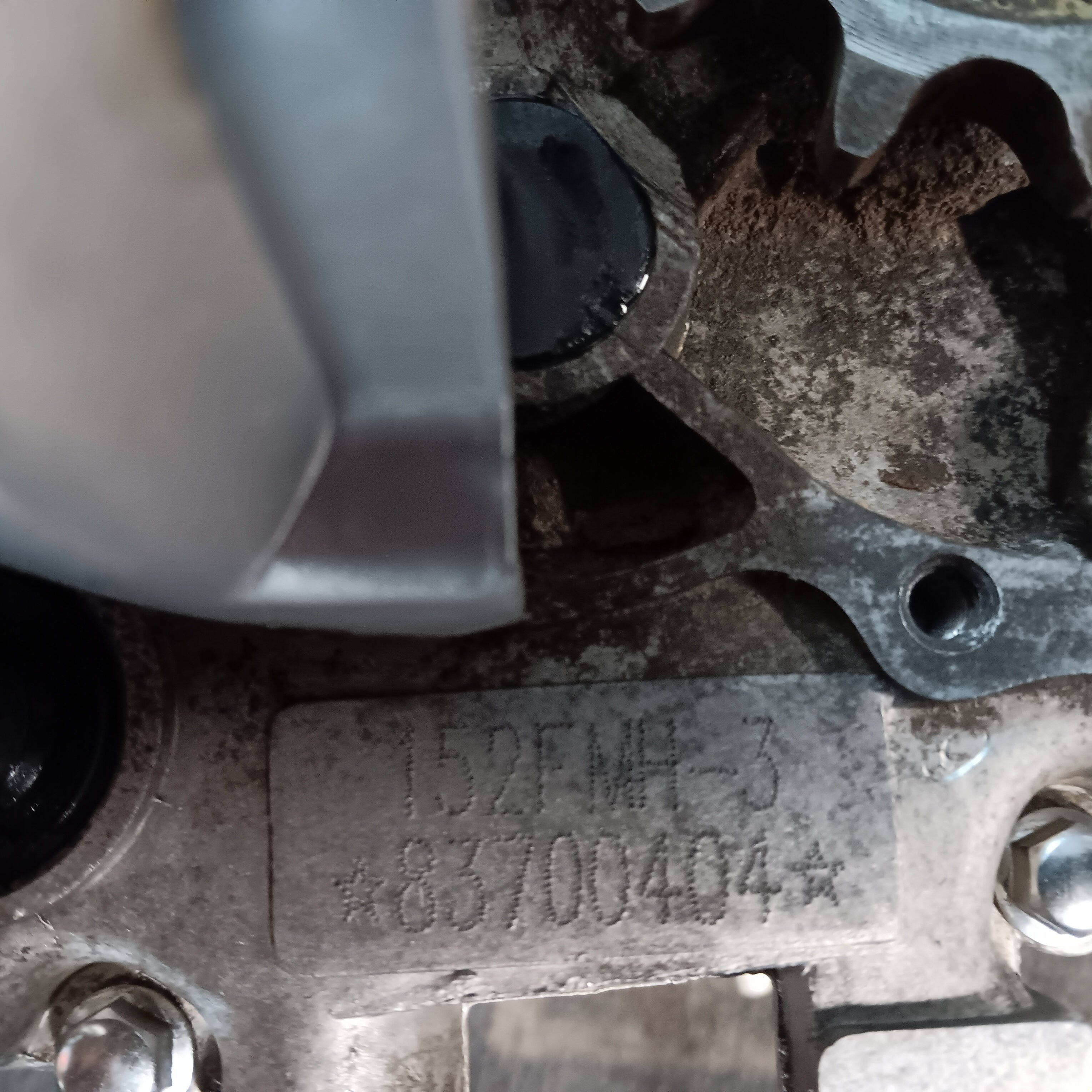

The engine came from a trashed ( literally pulled it from a trash pile ) Kazuma ATV , here is the only number that I have found but cannot find anything to reference it to...
It does have an electric start, and I think I have figured out the five wires coming out of the stator but have no idea what the other 5 wires from the green connector go to.
About the front end... yeah, I realize that it is probably a little light, but it is what I had. besides, I'm 75 years old and won't be doing any jumps or wheelies. If I can find a smaller springer style front end at a swap meet, I will change it but until iI get it running this is a low budget project.

The other wires coming out of the motor next to the stator wires are the ones I have questions about. They seem to be coming from a molded black cylindrical object that is held in place with an anchored clip and they are:
Green w black stripe
Blue w/ red stripe
Purple
 Pink
Light green w/ red stripe

The other five wires.. The only thing I can think of they could be is gear position switch, which you could check by using a ohms gauge while shifting through the gears. Most of those little Chinese engines don't have anything like that, but it's all I can think of. If it is a gear position switch that will narrow down the model the engine might have come out of considerably.

I found it's a Lifan engine and they can come with gear position switches for neutral only, or, that indicate each gear, so that is what it will be. I haven't found a wiring diagram with your exact colours but if you put 152FMH-3 into google you will find plenty of leads to those engines, and if you put "Lifan 152FMH-3 gear position switch" you will find other people talking about them.
