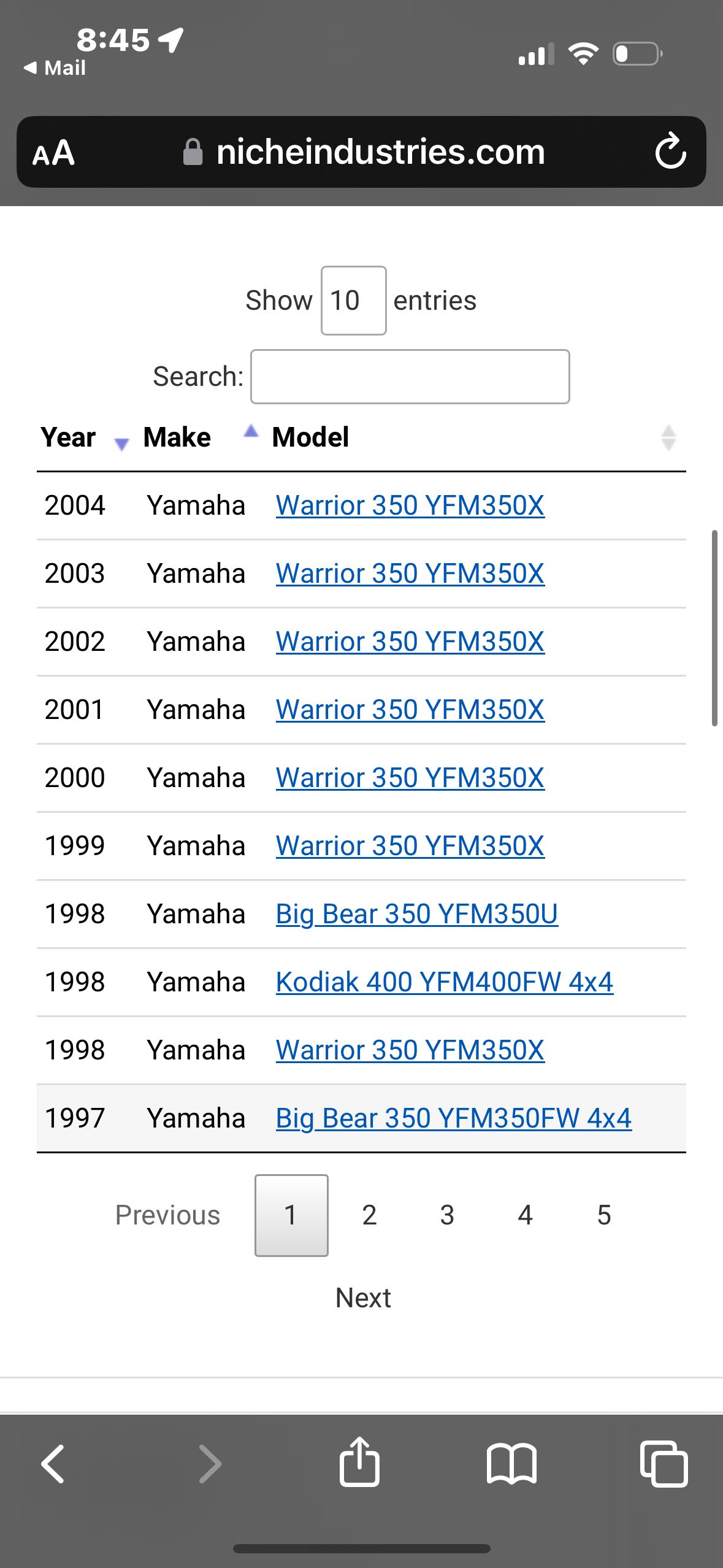

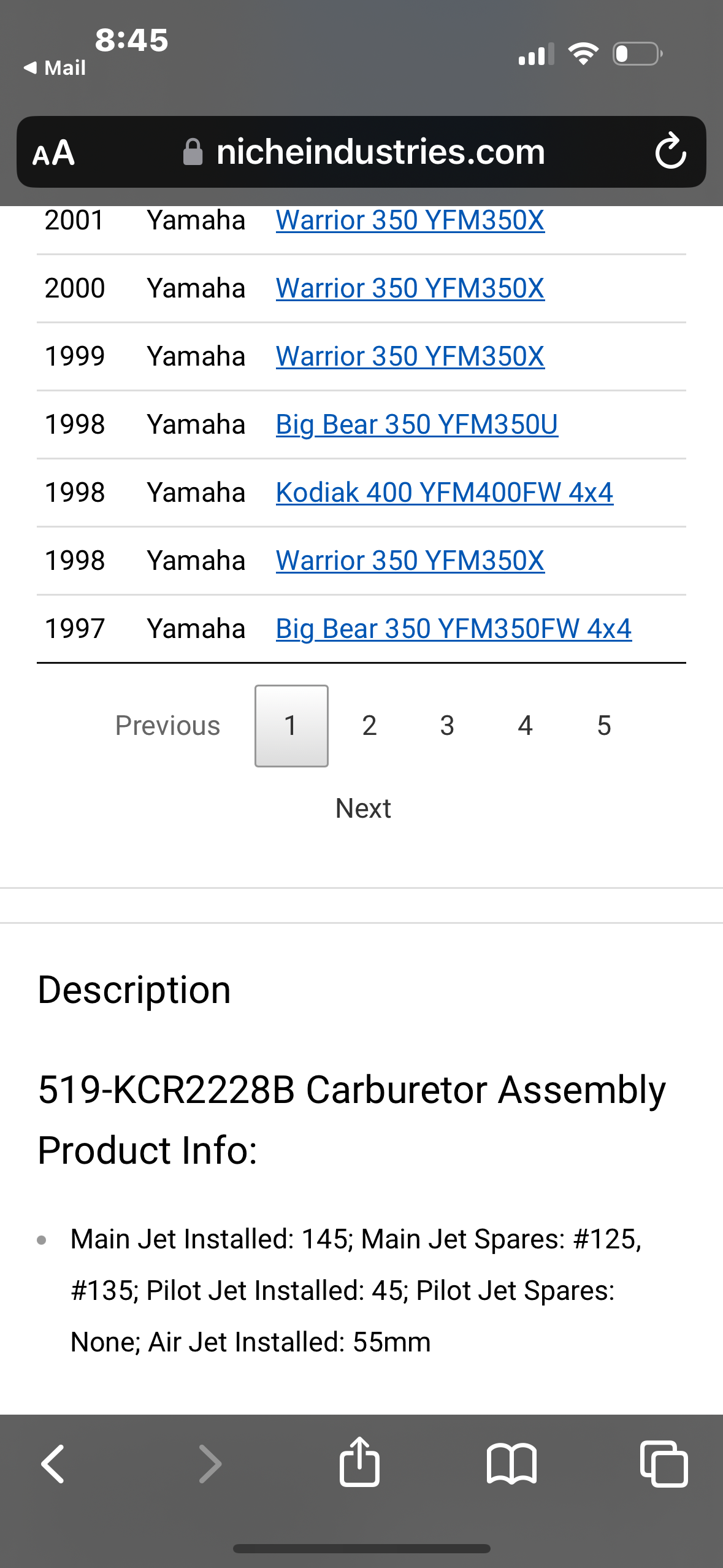

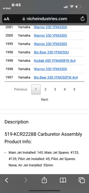

Thanks for all the info! I think I just realized something… mine is one of those odd 1999 but VIN says 2000, and the site doesn’t list a 99 carb. The 98 carb came with a 145 nozzle installed!! The one that came out of my old carb was a 105!!! Are the nozzles interchangeable? Can I take the original Mikuni one and put in my Niche one?
Not sure what you are calling a nozzle. There is a long brass tube the main jet screws into the bottom of, and at the top of that tube is where fuel discharges into the air stream. The tube is mostly called an emulsion tube. The slide needle drops into the emulsion tube. You can sometimes change the emulsion tube, but it has to be matched to the slide needle to work properly. Sometimes the threads are different on the jets and/or tube.

I think he is referring to the main jet size , you may be too rich, what do your plugs look like. If you are referring to Niche Cycle on Ebay they sell Mikuni carbs, since it came with the different jet sizes it is for many applications including the rare carb on your Kodiak. Is it a Mikuni . I would try installing the 135 and see if it helps and go down from there. Was it bogging with your old carb? I wouldnt throw my old one away.
Yeah I think you're right. I suggested those numbered parts were main jets earlier.
DTLB..  Those are called main jets, and service manuals and parts places will all call them that.. If you read on the internet about tuning your carb, they will mention main jets. That's them.. So you know.

Oh..  The jet threads need to match the emulsion tube threads, which needs to match the carb body threads, so you have to be careful if changing parts from one make to another, and, not all jets are measured the same way, or numbered with the same system.. You need to check them by eye or gauge to be sure they do seem the same measure.
