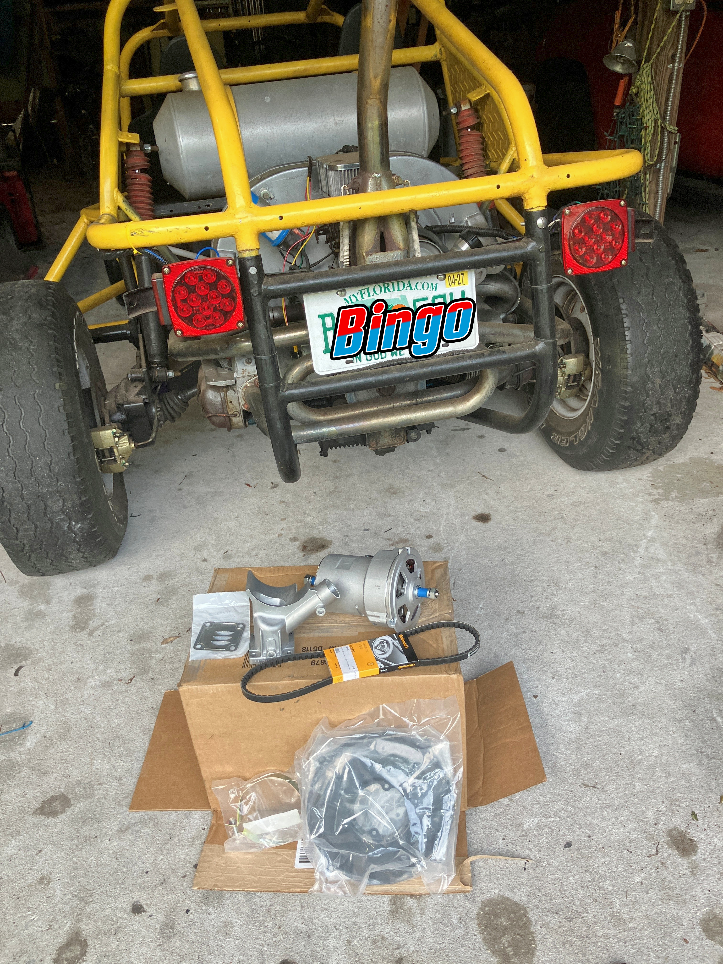

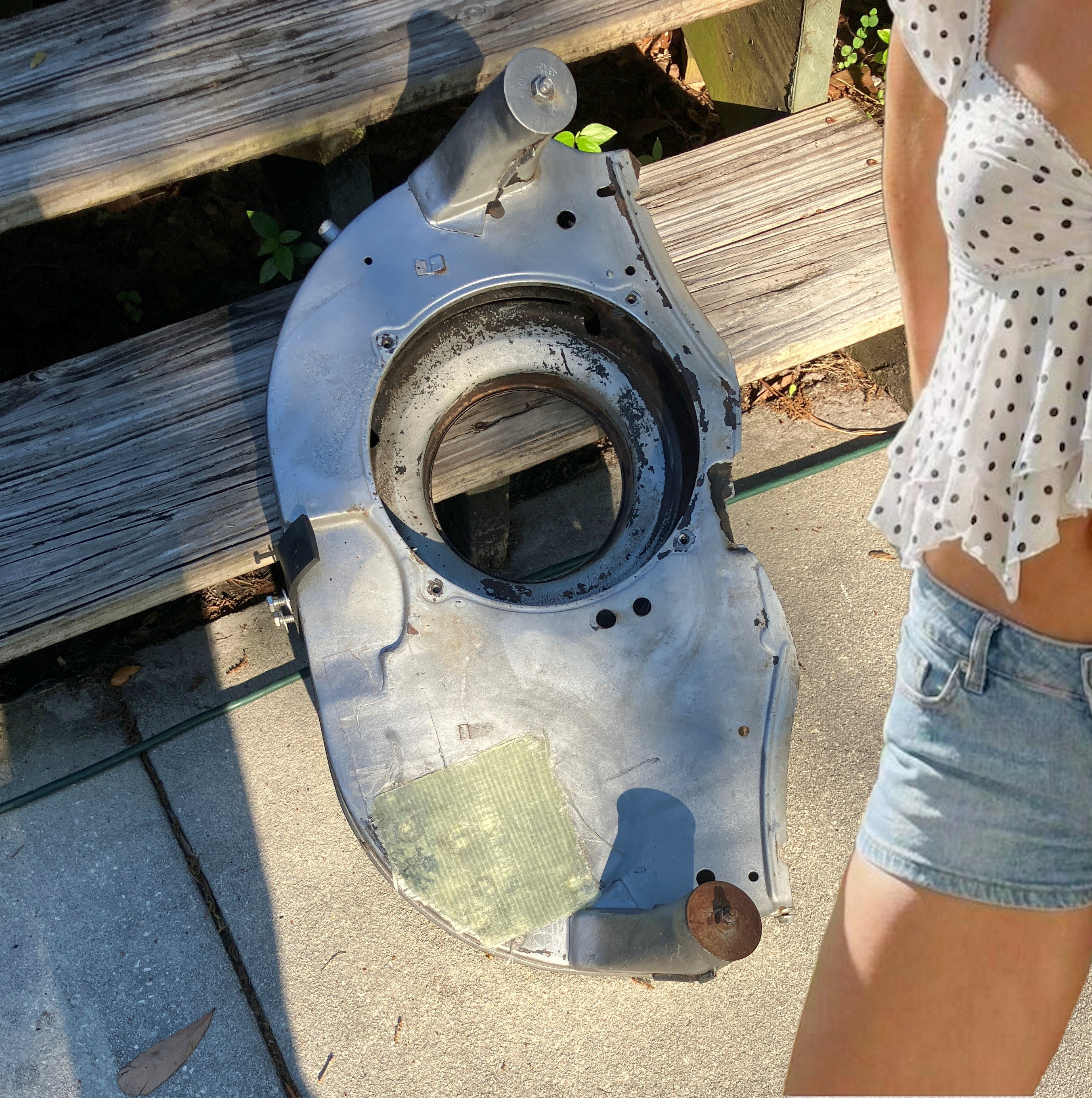

My sand rail VW motor air housing had some metal fatigue and multiple holes where the Ignition coil was mounted . Others had remounted creating several holes/
I recently installed an Alternator and removed air housing.  I  used an epoxy patch kit to cover and reinforce the area where coil was mounted.  THe kit worked great. Just exposed the fabric patch to  sunlight to cause curing.  After 24 hours I was able to trim /sand and paint. You can see the fiber glass patch cloth in picture before I painted.  It was very ridged when i pushed on it and did not flex.
image.thumb.png.ed475790a1ae2cc42a0d32b4e597f2a3.pngimage.thumb.png.d30474a4cdf9bc2a57b69a460709f2e2.png
I have had that kit in my 'Stash' for a year or so.  Just keep it out of sunlight.  each patch is maybe an 1/8 in + thick. I sanded area until it  was bare.

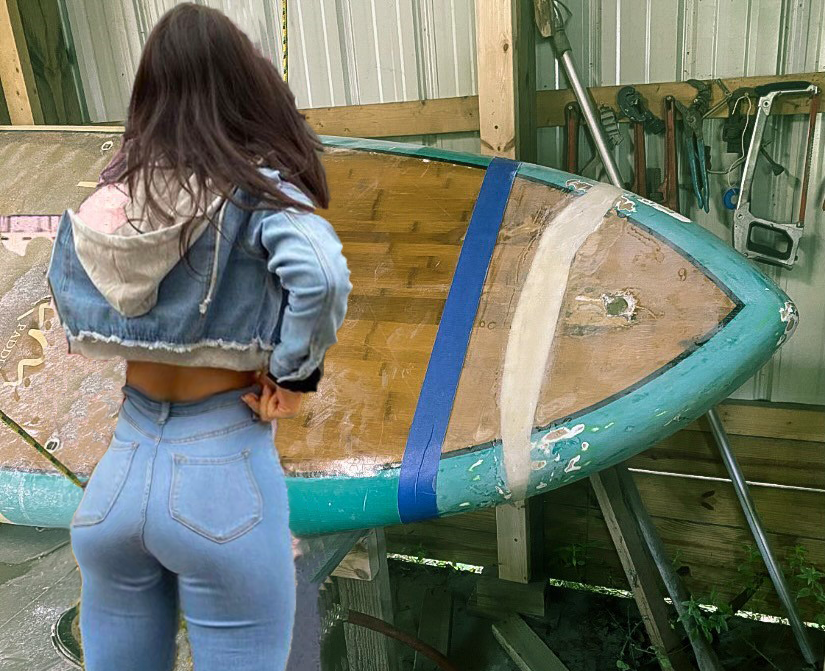

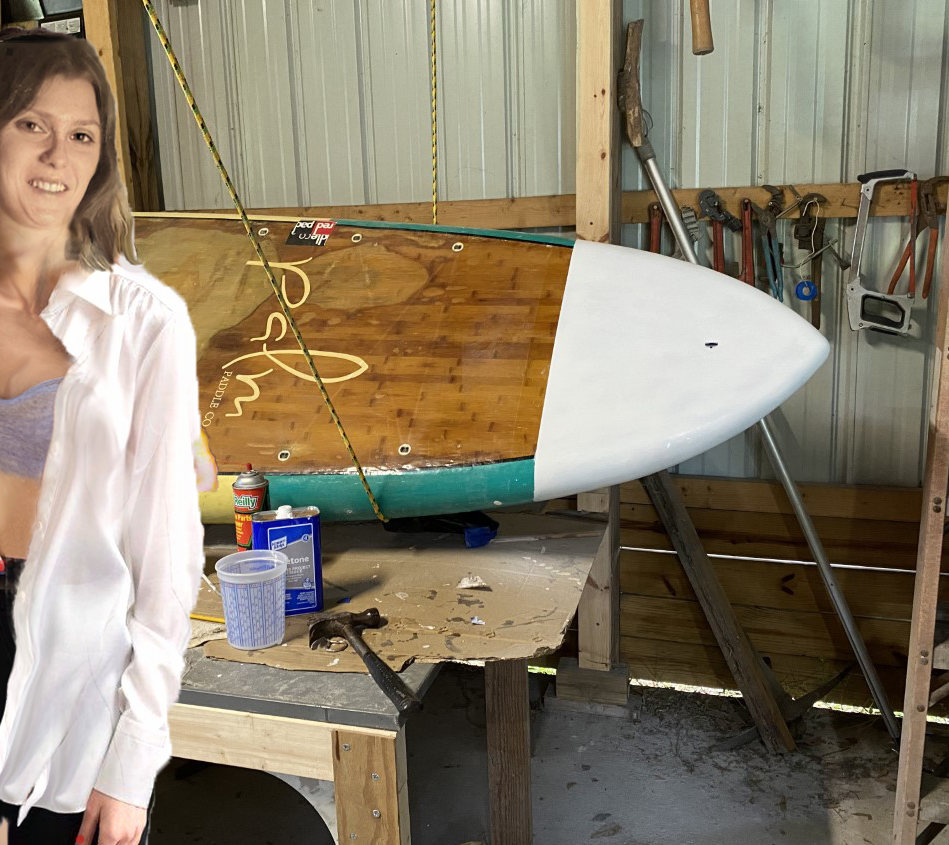

I repaired my cousin's paddle board a year or so ago.   The entire nose broke off.  Here you can see I reattached with two layers of fiberglass cloth .   I use West Marine Epoxy because it works and It's dummy proof for people like me.   Also they help me with questions and suggestions.
Final  finished....I feathered in the area where the fiberglass reinforcing cloth was with filler that is available. It sands easy for a smooth finish.
