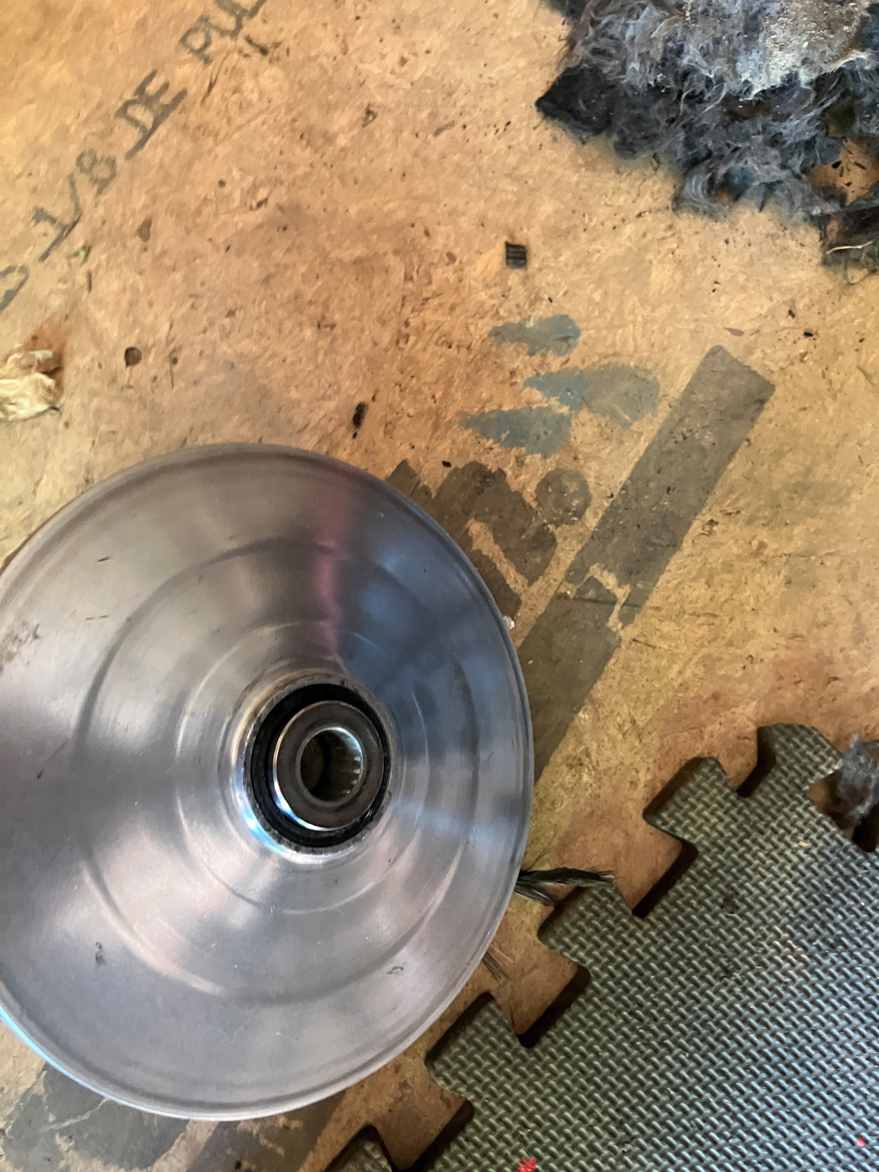

I had no low end power intermiiantly om yamaha 700 sxs.  I replaced the belt with an aftermarket and rebuilt (cleaned and relubed) primary and secondary clutches. The new belt lasted about 4 miles  and belt exploded into shreds.  Admittedly i went through some heavy mud during the four miles.
Guys told me the aftermarket belt will not take the heat.  However, the primary had a 0.04 in smooth grove. in it (see herewith).  I replaced the belt wit an OEM and replaced Primary clutch (got from EBAY).  Runs great now.
Don't know if this adds to the wisdom file for your problem.
