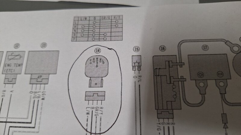

While wiring in a set of reverse lights I discovered the diagram is wrong concerning the shift position switch.  It is shown as LHNRP but its backwards, PRNHL
L/W and R/Y wires close on reverse, not L/W and GR/G. Found out the hard way and had to re-do it.
Diagram is Alterra 600 LTD
