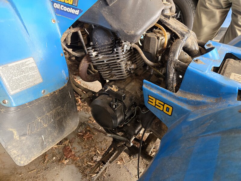

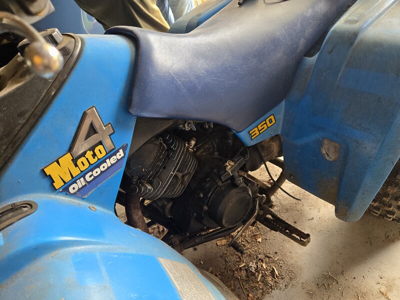

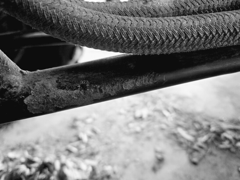

1987 Moto4 350 4x4 (possibly?) Requesting Help!!
Popular Now
By hengstserepair
Nuetral: Runs as expected
Forward: It slips. It seems to only transfer power to the wheels on a smooth surface and going slightly downhill. When shifting into forward at idle, there is a clacking sounds during the transition. Shifting back to nuetral works just fine.
Other Notable Symptoms: There was old oil in the vbelt and when I was tuning the carb, it starting blowing out of the CVT cooling vent at the front of the quad. Made quite a mess. There is positive crankcase pressure due to piston blowby, that I have not decided whether or not I am going to fix (customer budget dependant). Since the oil was old, much darker than the new oil that is in the crankcase, I am thinking it seeped past a bad seal while it was sitting for years. The oil that was in it when I first got it had gas in it.
Thoughts: I am thinking maybe there is an issue with the clutch. I worry about the old oil intermingling with the dry centrifugal clutch. I was thinking my next step would be to take the cover off of the clutch and inspect it.
