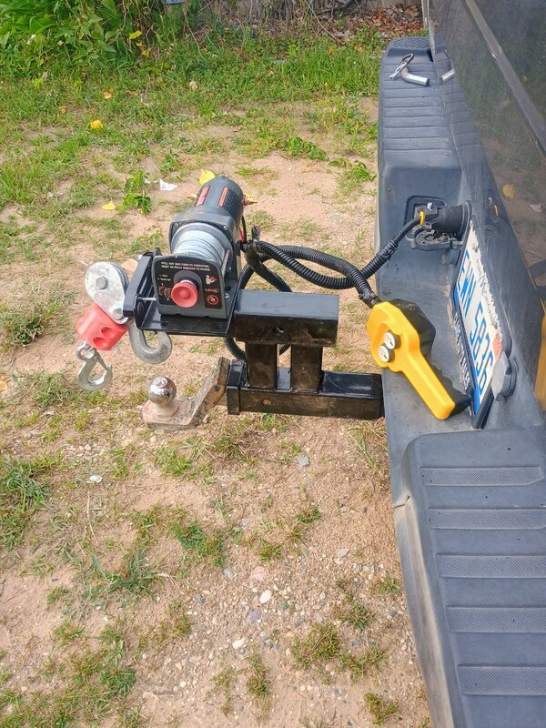

I have 3 atv's 2 have winches , the problem I sometime have is loading onto the trailer if the bed is wet or of frosty. there have been times the winch is needed. but , what to do if the w/o ATV  or any other perhaps dead ride needs to go onto the trailer . 99.5%  of it came from harbor fright.
Wow....That is a nice reciever hitch set-up.   I'll need to look for that..  BTW the Winch rating  os based on  using the mechanical advantage of the block.

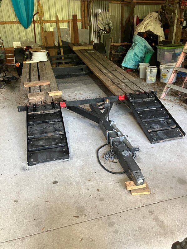

If i have an embankment to load from, I like it from the rear.  However, the ramps  I made are designed to load from the front with the trailer hitch down.  The ramps are 3 inch angle w  2 x 6 wood.  since taking the picture I painted them and trailer wood with skid / anti slip paint.

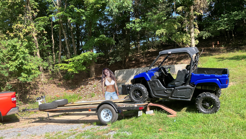

Here you can see unloading on an embankment at the cottage in the woods.  I have a web-belt winch at front of trailer (the trailer was a boat trailer in a previous life).  This probably not smart as if a down hill ramp were to flip the SXS would be at a picaros angle.  The trailer is high sitting on the level.   I don't like rear mounts as I am chicken.  Working by myself is always a challenge.LOL
The picture helps a lots to understand your problem. painting with  skid / anti slip paint should help.  I have a 16 ft trailer with side bars and ramps.  So far I have not ran into the problem you have.
The SXS is easy too load as I can engage the 4X4.   Its my VW sand rail that wants to go crazy. When loading from the front . I back him up on the trailer and when the front wheels are on the ramp the rear wheels want to spin and slide sideways     OMG 😵‍💫!   the grip paint should help and now I have a portable  electric winch I can hook on at back of trailer and pull his as* on!

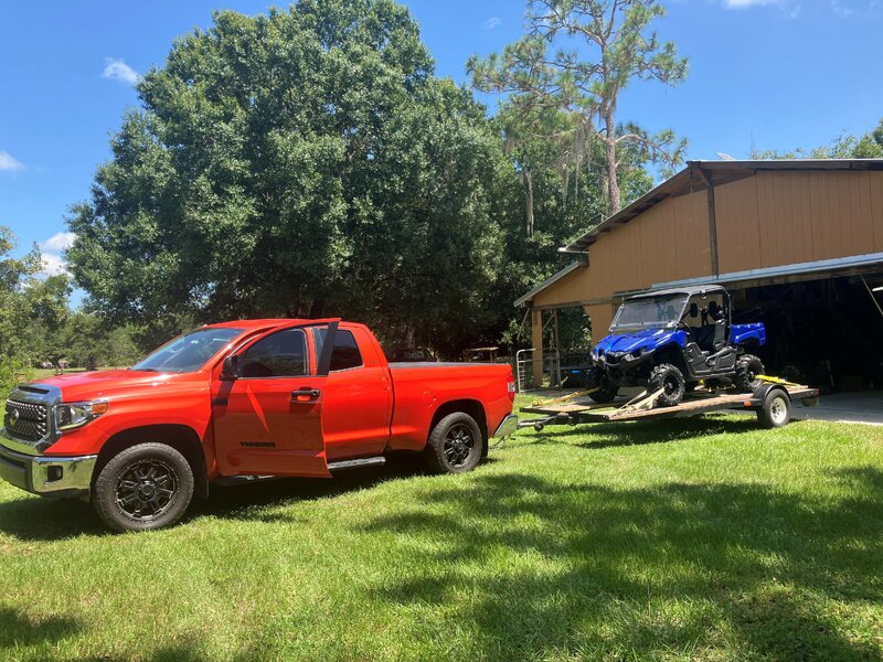

The SxS and the ATV will both fit on the 16 ft trailer ..Barely!   I have not tried it yet...here is a pic of th e SXS on the trailer...  You can see he takes up a lot of space.  Tried to load a picture of me on the trailerimage.thumb.jpeg.3cab092cb76b9b893c67d6cc5591f1ed.jpeg

The  "snatch block" on the winch line  can be used as you did to  change direction the winch pulls, or to  double the pulling power of the winch..   By  the way,  winches are usually rated pulling with a single wrap  on the drum, not by whether the snatch block is used..  As each wrap loads on the drum  the pulling power reduces.. A winch  rated  3500 # at   one wrap  may  only pull 500#  on  the  last wrap  of a full drum.

That is interesting about winch capacity and spool diameter....good info!
