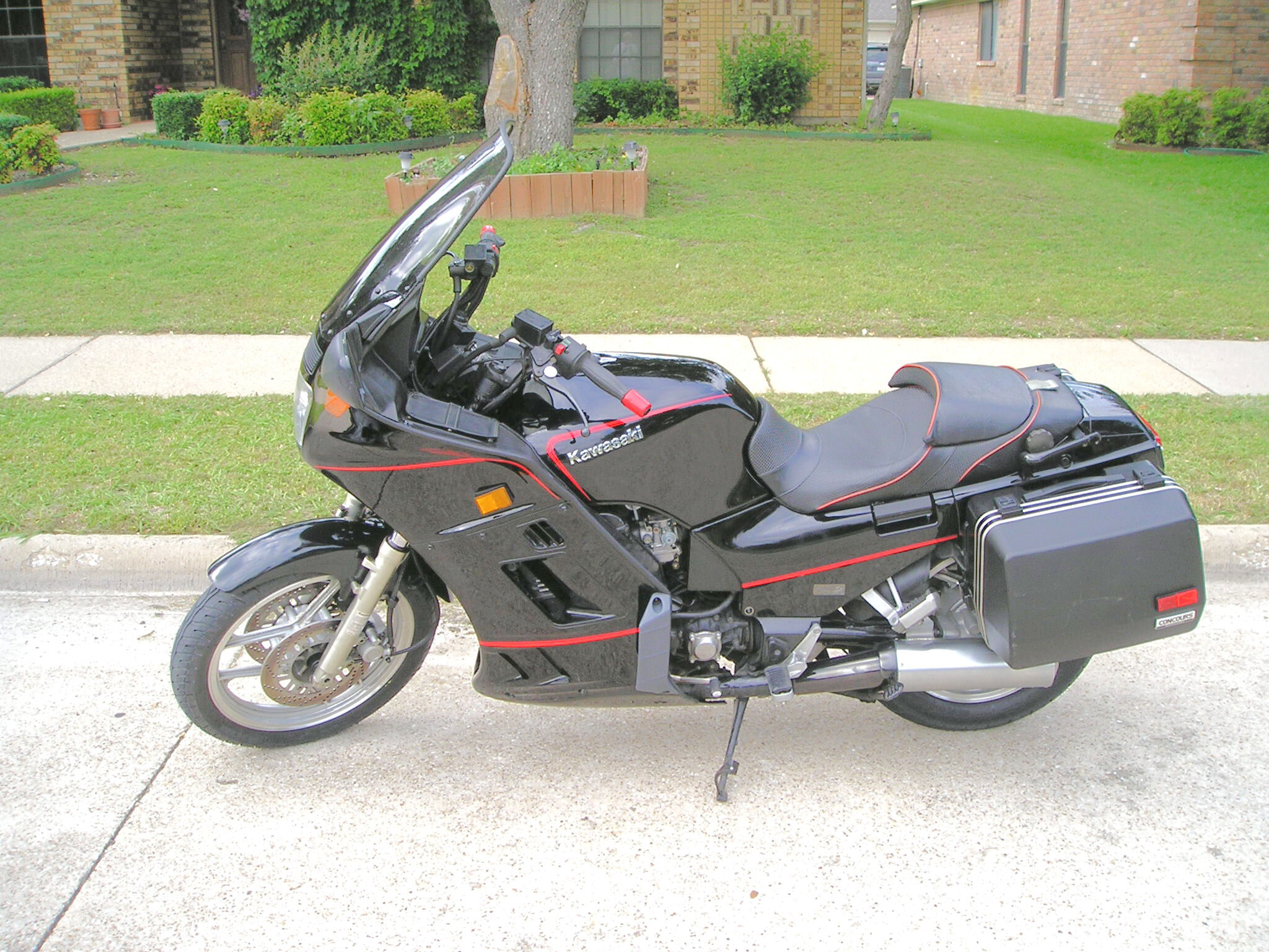

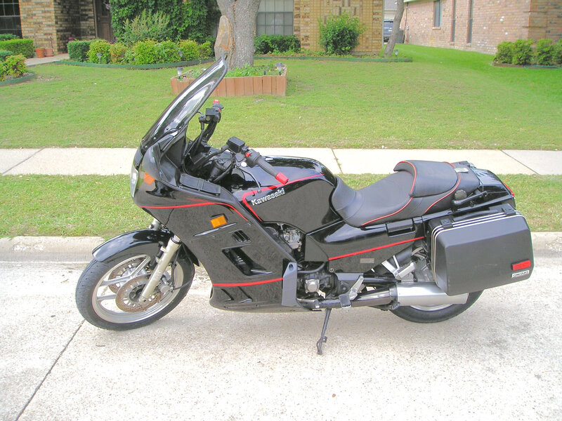

Sorry Stupid question here... On My Kaw 1000 motorcycle my tech used mercury columns (He was old school but handsome guy) to set my four  (4) Carbs.   agh ..is that applicable here.
This is not my 1992  ..don't have pic available on phone...Its a beast at 600 lbs  and 7.5 gal fuel tank. Saddle height is high for my crotch. This one is 1992  but with a lower seat.    He fell over on his kick stand and A guy had to help me get him back up.  Very eembarrasing.😞
