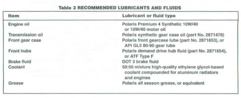

This is where I'm confused the front hubs when I checked them where almost dry so I have Polaris on demand drive hub fluid its very thin and blue in colour part # 2871654 Is this the right fluid for my year of bike 1998
This is where I'm getting confused again on the quick reference chart it tells me I need transmission oil Polaris synthetic gear case oil part # 2871478 I need this oil and where do I drain it and put it in the bike Is it at the rear of the bike in the middle of the rear end ?There is a small aluminum dip stick I can see and it is a little bit low on the stick I may just add some rather than change it because the oil looks clean on the stick
Then quick reference chart it tells me I need front gear case oil Polaris front gear case oil part # 2871653 or API GL5 80-90 GEAR LUBE WHERE DOES THIS GO IN MY BIKE ??? I think I found it under the front wheels in the middle of the bike Its a small housing where the front drive hubs hook up Not sure if I use the same oil in front gear case as the front hubs the newer model bikes use the same oil in the front gear case as the outside front wheel hubs I think
