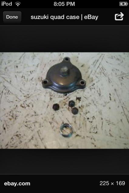

I dont know how helpful this but this is what it is. [ATTACH]1808[/ATTACH]
Then those three nuts screw onto three threaded bolts almost protruding from the case.
Chances are the threads on the nut stripped BUT there really is no way to tell unless you remove it. If its the nut just replace the nut with another one thats the same size. ( after cleaning the threads first. ) If its the stud ( thats the threaded part that the nut goes onto ) then it will depend on how the stud is installed into the case. If its threaded into the case it might take a little fiddling to get the stud out. I usually put 2 nuts on the stud & tighten them against each other, then back it out. If its stripped, that little trick might not work if there isnt enough undamaged threads. A pair of well placed vice grips will do the trick. Be careful not to snap the stud off in the case!! If it seems very tight you may need to apply some heat to it to get it to move. Carefully, it can be changed. Now....if its a pressed in stud with or without a head on the inside of the case, then you might have a pretty big problem on our hands. Good luck with it. Let us know what you find & well help yah along if needed.
Humm. This is the part where i get confused. It is a stud. And the nut goes onto it. Then the stud does into the case. However when i was looking up pictures of the oil door? For the filter i saw some that were with nuts and some that were with bolts. So that makes me think
The the stud screws into the case.
If the stud screws into the case you might also be able to replace them with the right length bolt needed. Make sure you put thread sealant on before installing, just incase they are thru-holes into the case.
