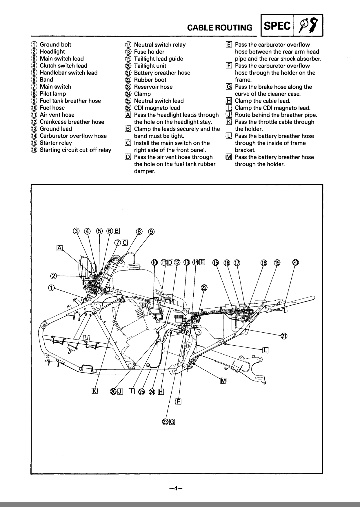

You clearly have power from your battery, it's just a matter of isolating why your ignition switch isn't turning things on.

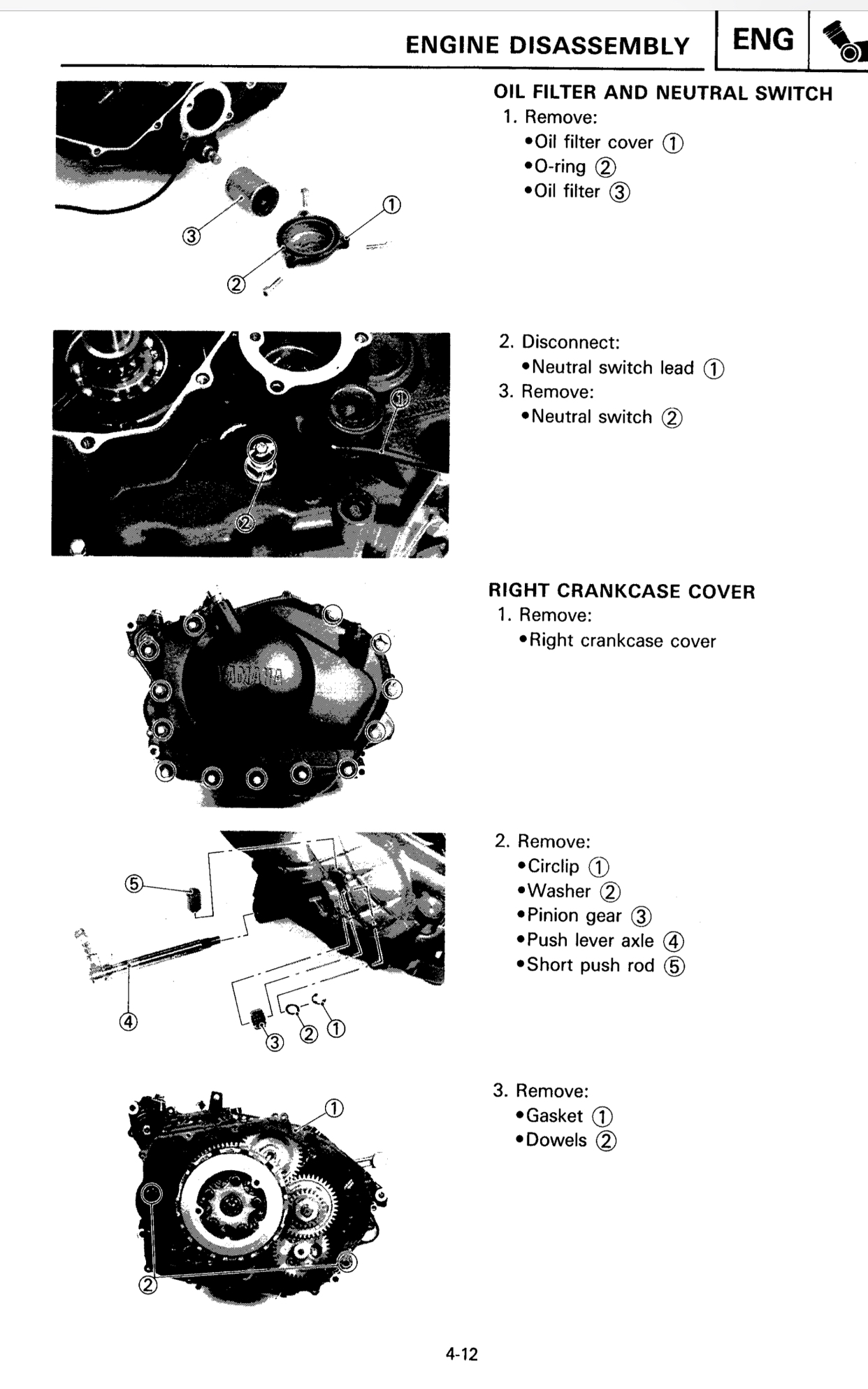

Should be on the bottom of the engine near the shifter, there is a sensor. And also a relay near the fuse block and start relay. Take a look.  I attached a few pages form the manual of a warrior that should be similar.  You can also find the manual to that bike on this site in the upper right tab and go to downloads.

If you don't have the neutral light on when it's in neutral that bike will not start.  Probably either a faulty neutral switch or a broken wire.   That neutral switch has to be grounded in order for the light to come on.
