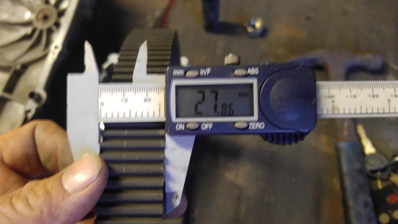

Third picture you posted is the cover for the CVT. You can download a free service manual which has all the specs and guides in it for free at countrycat.com , look under technical section. You will need the year and model to download the correct manual.

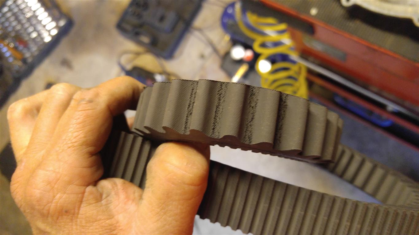

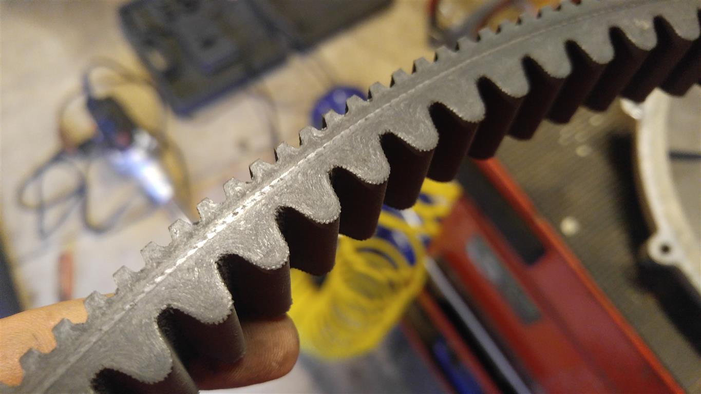

My pictures are from a 2010 366, similar design, only difference will be the part number for the belt. I replaced this belt because of the cracks on the inside of it. Width was still good, and no glazing on the sides.
If this is slipping, you would hear it squealing, if your not hearing a squeal, I suspect you have the wrong oil in the quad and its your wet clutches slipping. If your not sure of what oil you used, change it out to the right stuff.
