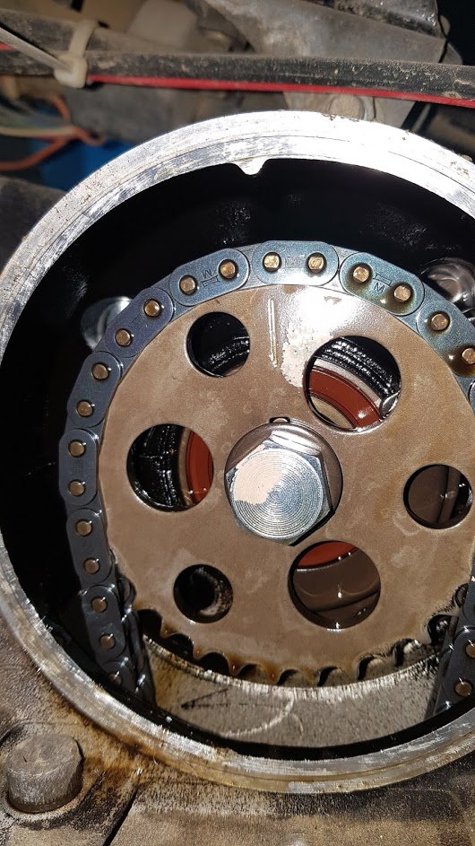

I inherited a 89 Big Bear 350 4x4 and it does not run very well. Carb is very dirty, I'm pretty sure it causes the hard idling and stalling. I haven't had time to clean it but just before leaving my garage I decided to check the timing. At TDC, it seems a little off, like less than 1 tooth. Can this also be a cause the hard idling and stalling?

I think that the timing is ok based on that pic.
