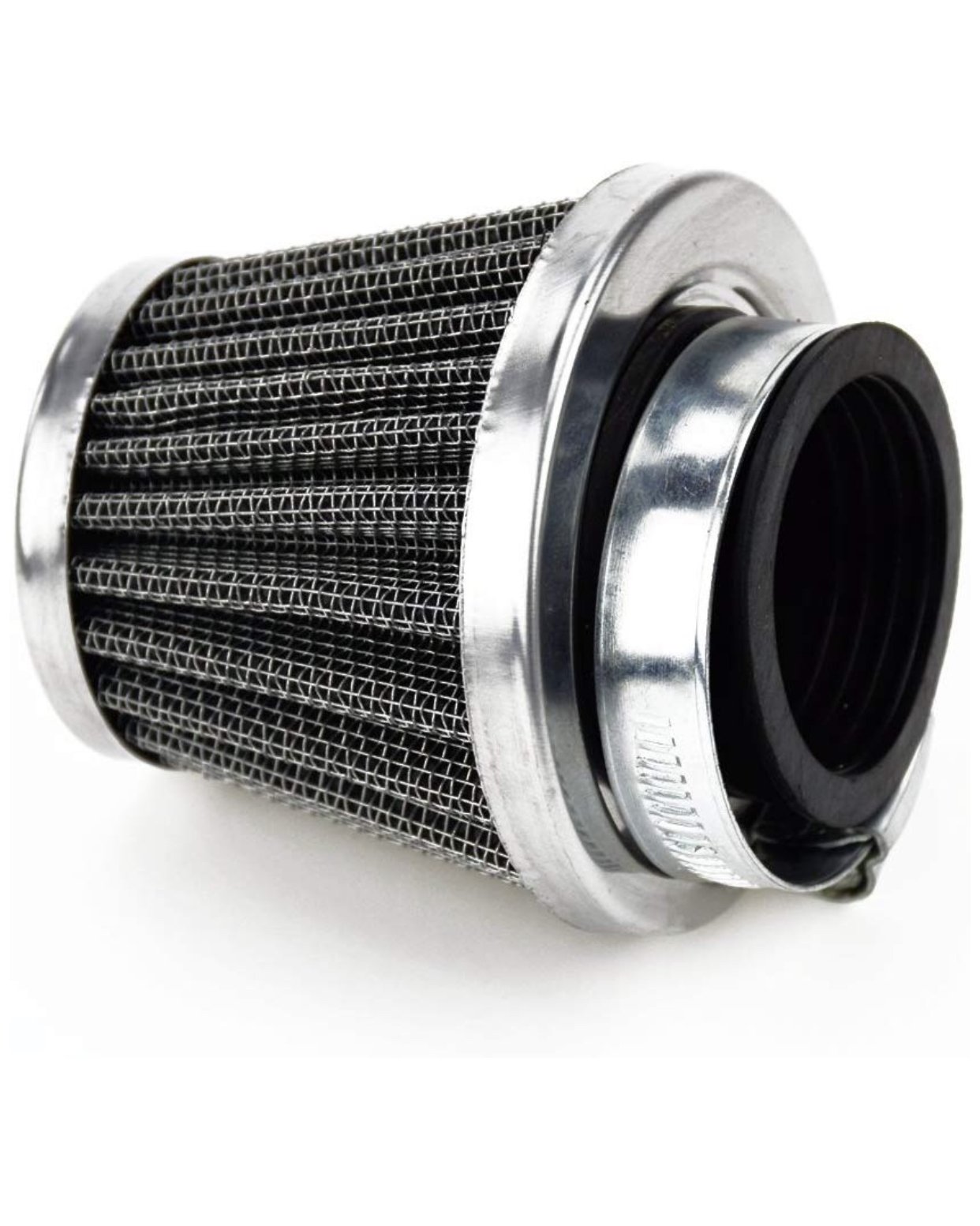

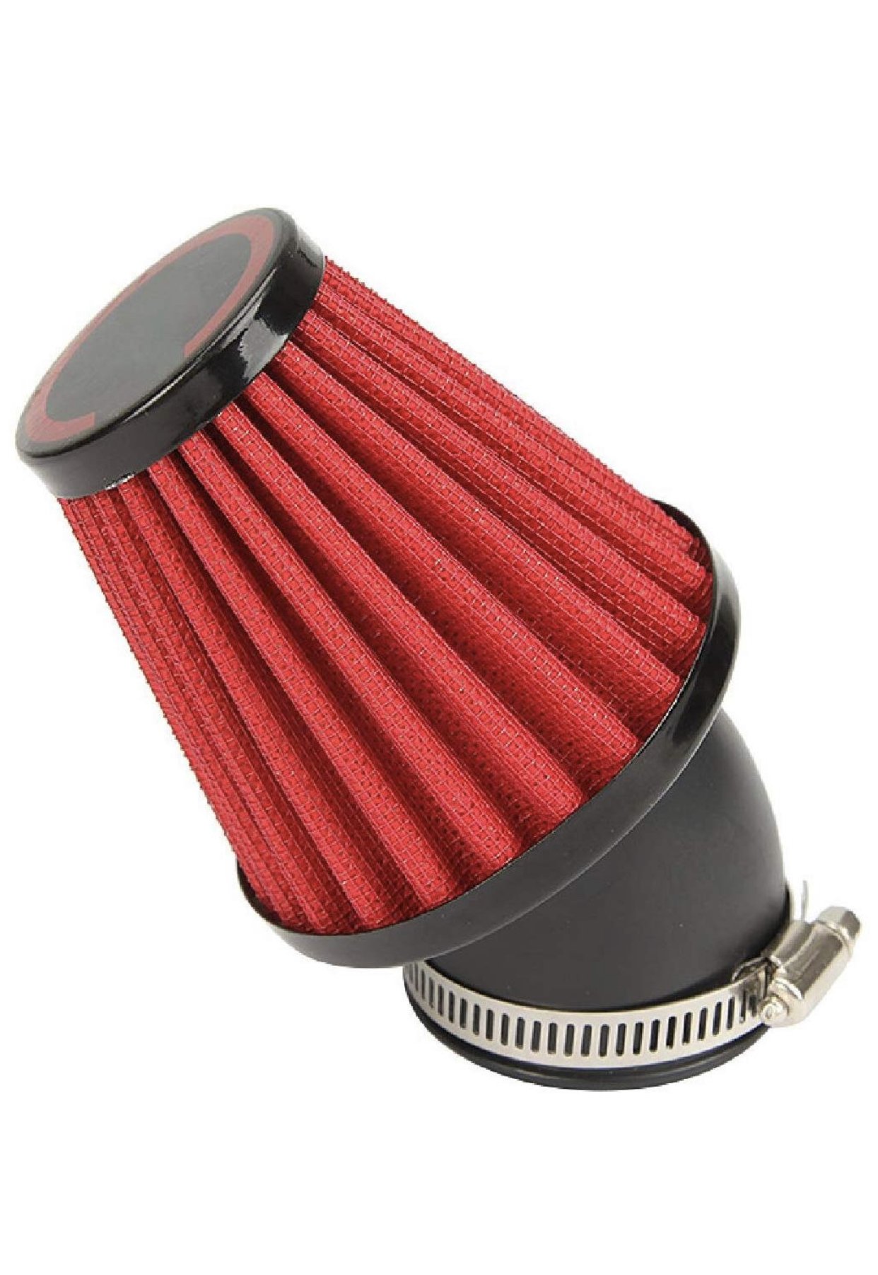

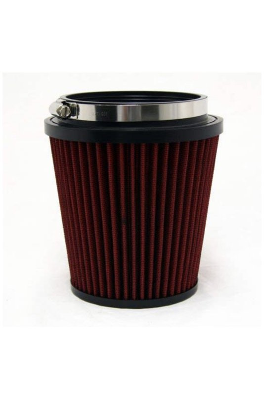

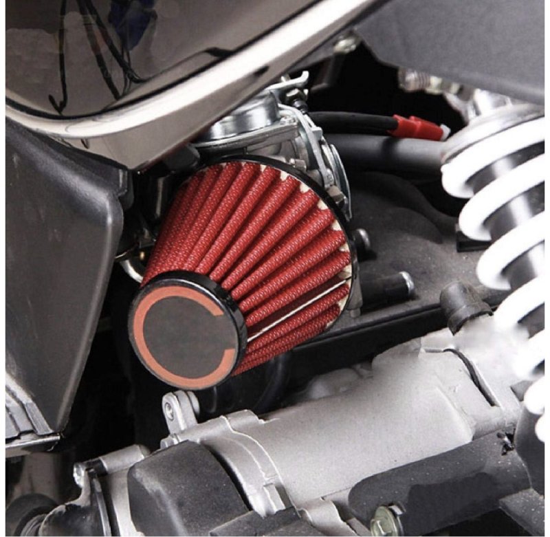

I would look into a universal one. I attached a few pics for you.  They are on amazon. I’ve used on on my 90 cc Polaris and it worked great.
