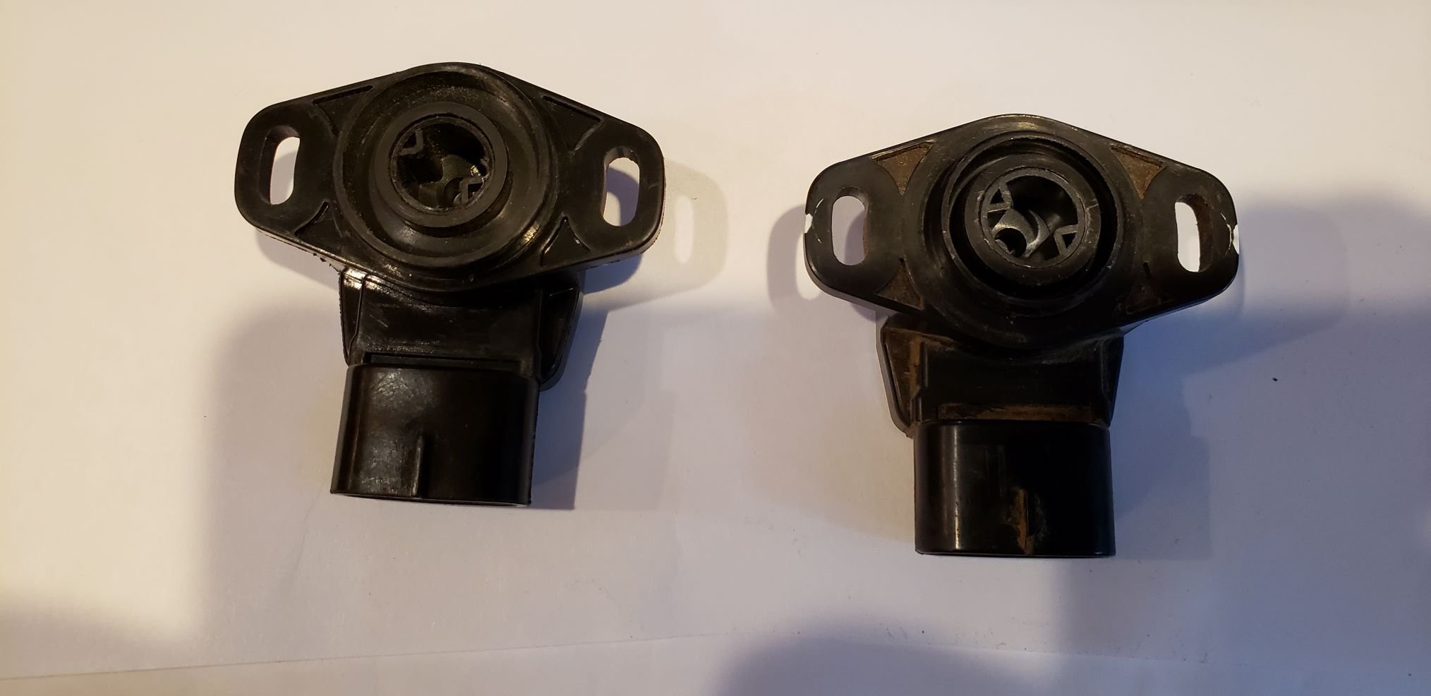

TPS on  Polaris  SPORTSMAN  500 efi 2007 shows as bad original part number is 3140173 bought the replacement part it came in as 3131705 the diameter of the ring on the face is 26 mm the original is 18 mm any thoughts on how this "factory" replacement parts fits as i cannot get it to go in?

It can’t be the right part. There has to be a cross reference issue etc. I would double check your numbers.  18 to 26 mm not clicking. The TPS is a very temperamental part so  should get numbers re checked and the calibration tool as well from Amazon so it’s installed properly.
Post a pic I’m curious to see what it looks like. I’m curious about the dimensions. We may be talking about thickness (26mm) of the sensor and not the circumference?
I guess  you would have to see the dimensions of the part to be sure
It looks like it will fit.  Only way to be sure obviously is to try it.
But i would measure it first before you slap it on and see what the numbers look like.
Quick question. What’s the part number on the original one.
Frank i tried it it does not fit wondered if i was missing something, maybe something  that needed to be taken off first, that is why i wanted to know if any one knew something i did not
So I’ve looked everywhere and it all comes up the same. The old number is superseded by the new number. The old part is roughly 0.7 mm or 3/4 of an inch in diameter and the new one is 26mm or 1.02 inches in diameter. Very strange.

Ok that would make sense. I was wondering about maybe possibly spacer.  But did the spacer come with it ?
Also how thick was the spacer ? I know that the shaft coming out of the throttle body is only so long?
Lastly did the new sensor have any paper work that mentions anything about the spacer? I would reach out to the Polaris via email and let them know about this problem and the aggravation it’s caused. Pain and suffering damages of not being able to ride!!!!! Lol.
