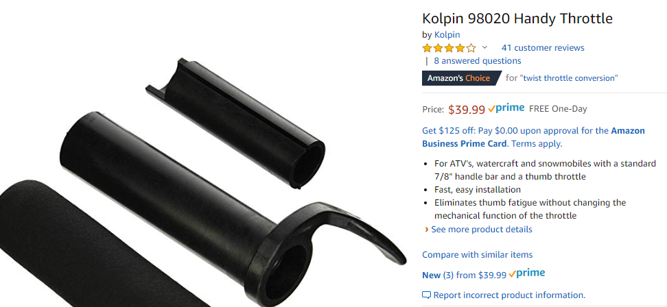

You can get a simple attachment like this:
Kolpin 98020 Handy Throttle
Handy Thumb Throttle Converter THUMB PUMP SNOWMOBILE ATV THROTTLE ADAPTER
or a full conversion from Motion Pro or other like:
https://amzn.to/2XxyFHo
