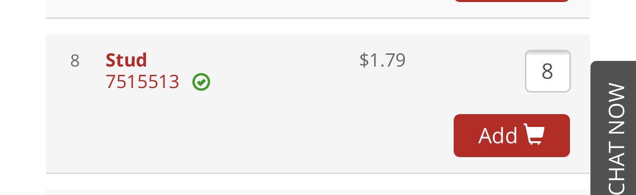

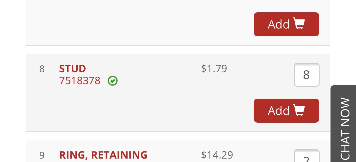

Ahhh ok, now i see what your saying.  Well you can cross reference the stud part numbers on www.partzialla.com and compare and see if the same numbers come up.
My guess is there would probably be a difference in the thickness and even the length.   I looked up the part numbers and they do look different.
I was not sure on the 19 model, you said 19 general?

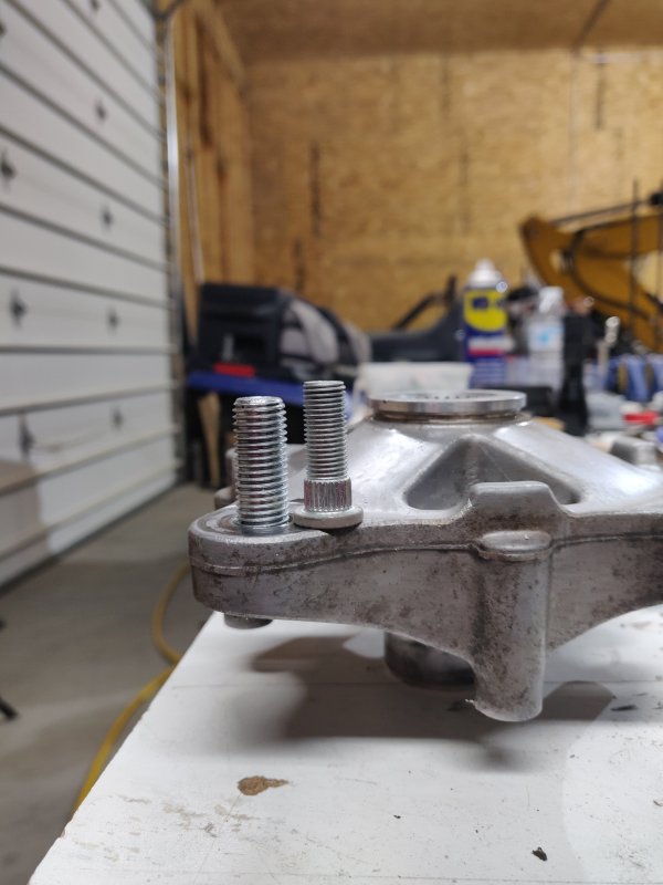

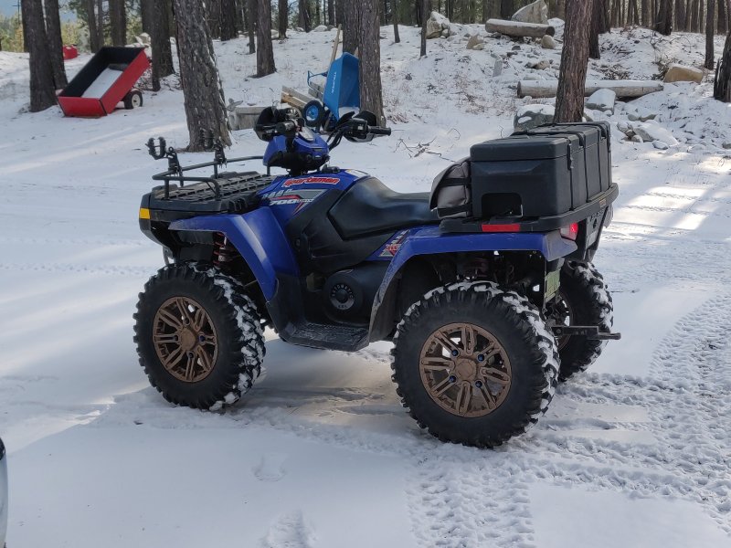

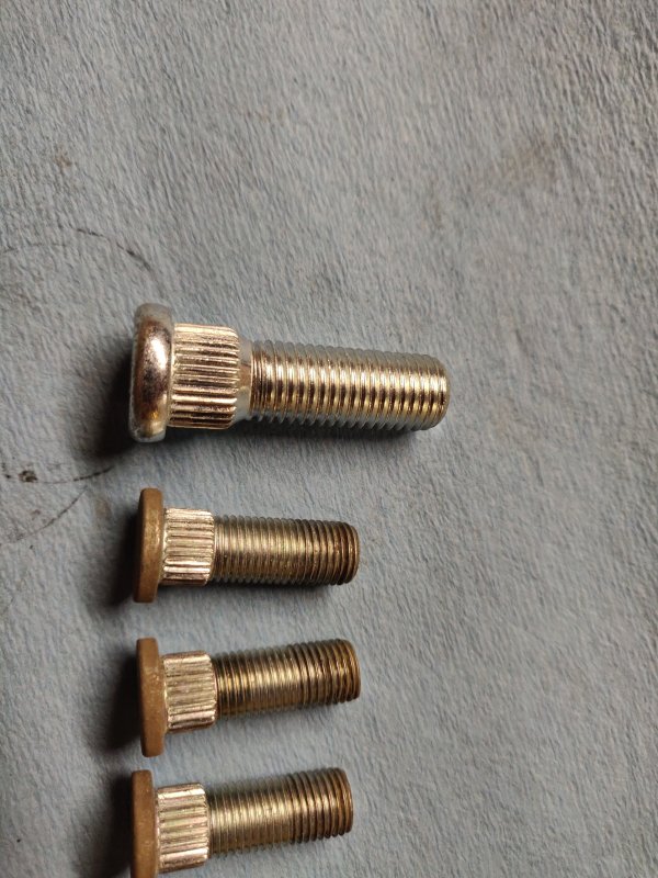

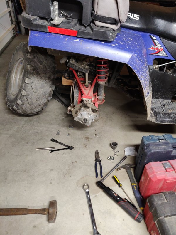

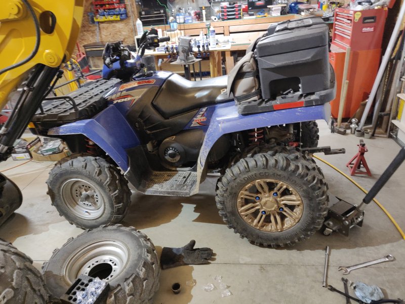

Okay guys. Got things figured out and wanted to share it with you so if you guys wanted to upgrade your rims on your quad, it is totally doable.
So I had 2019 Polaris General tires and rims, I purchased new studs from partzilla, 2.99 each, I then punched them out, the old studs.
I used a 17/32 drill bit for the new studs. I built a wooden jig that the hub sat in, and used two 2x4's to lock it in so it wouldn't spin with the drill press.  I didn't have a press, so I used hardened washers, a stack of them, just enough to get a full nut's worth. I bought a new set of lug nuts, but for setting the studs, I bought two nuts. Half way through, I changed to the new nut. I used my impact and seated them right in.
Threw the wheels and tires on and it looks awesome.
