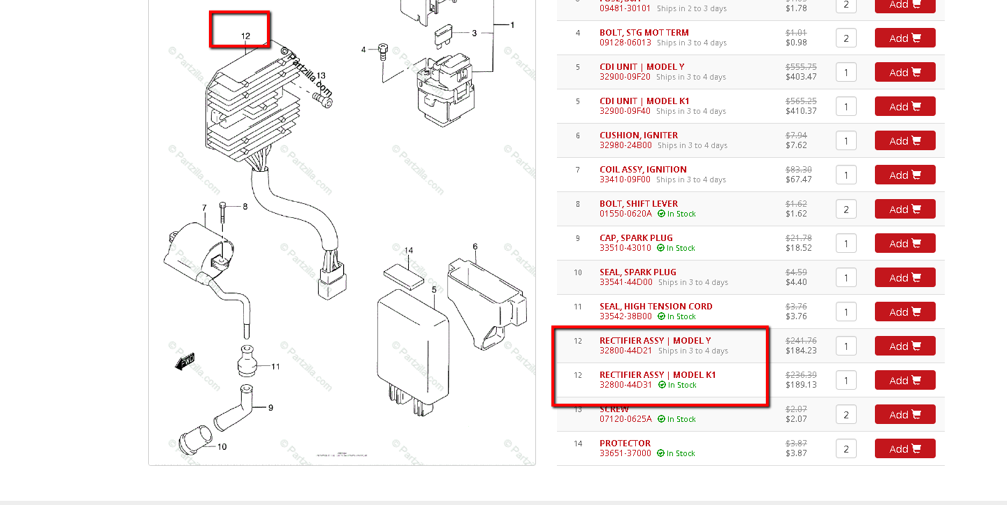

this is the parts diagram...would be nice if there were something more as to what is Model Y and Model K1

I went with the 21 as it IS a quadmaster...
