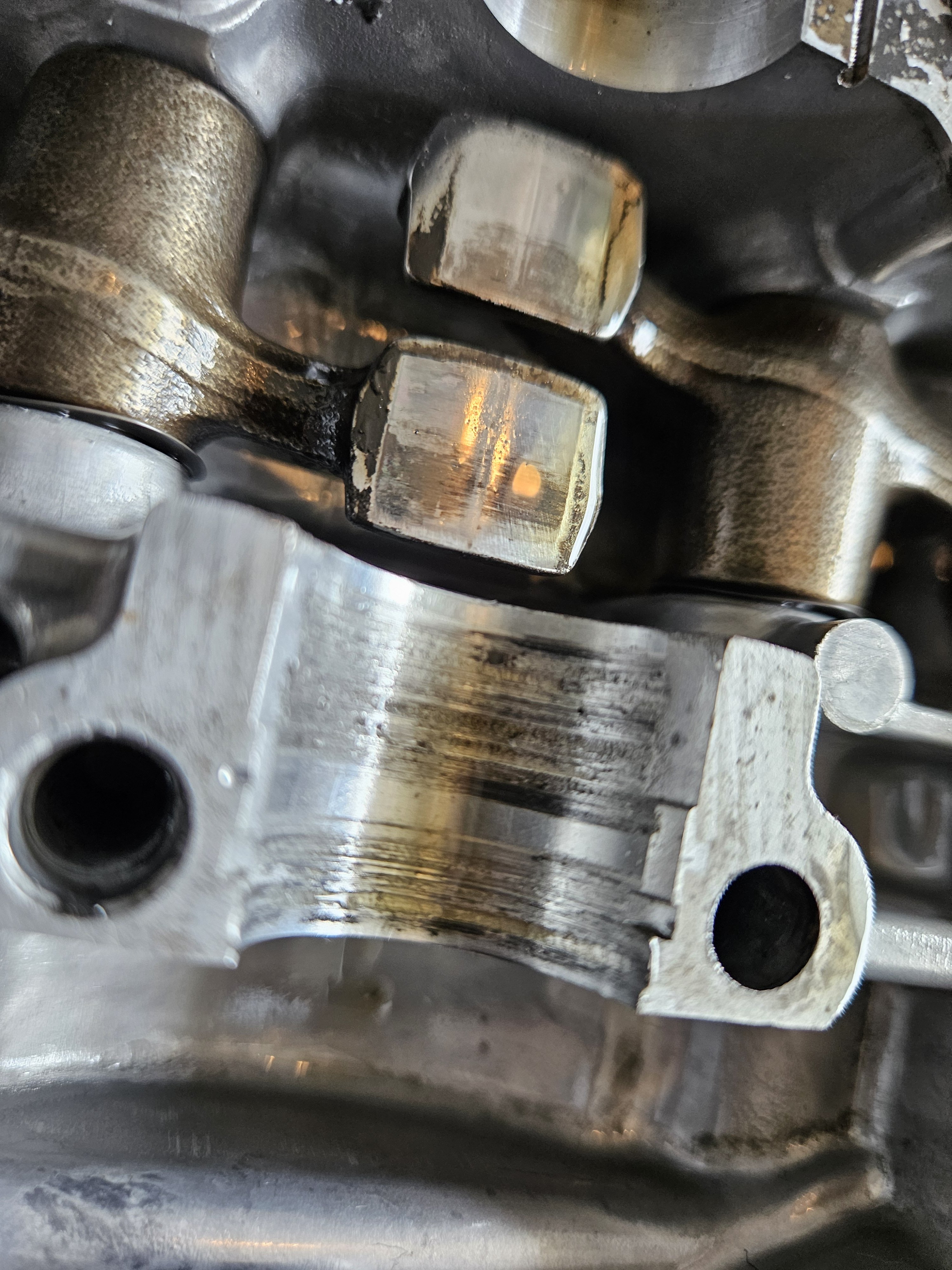

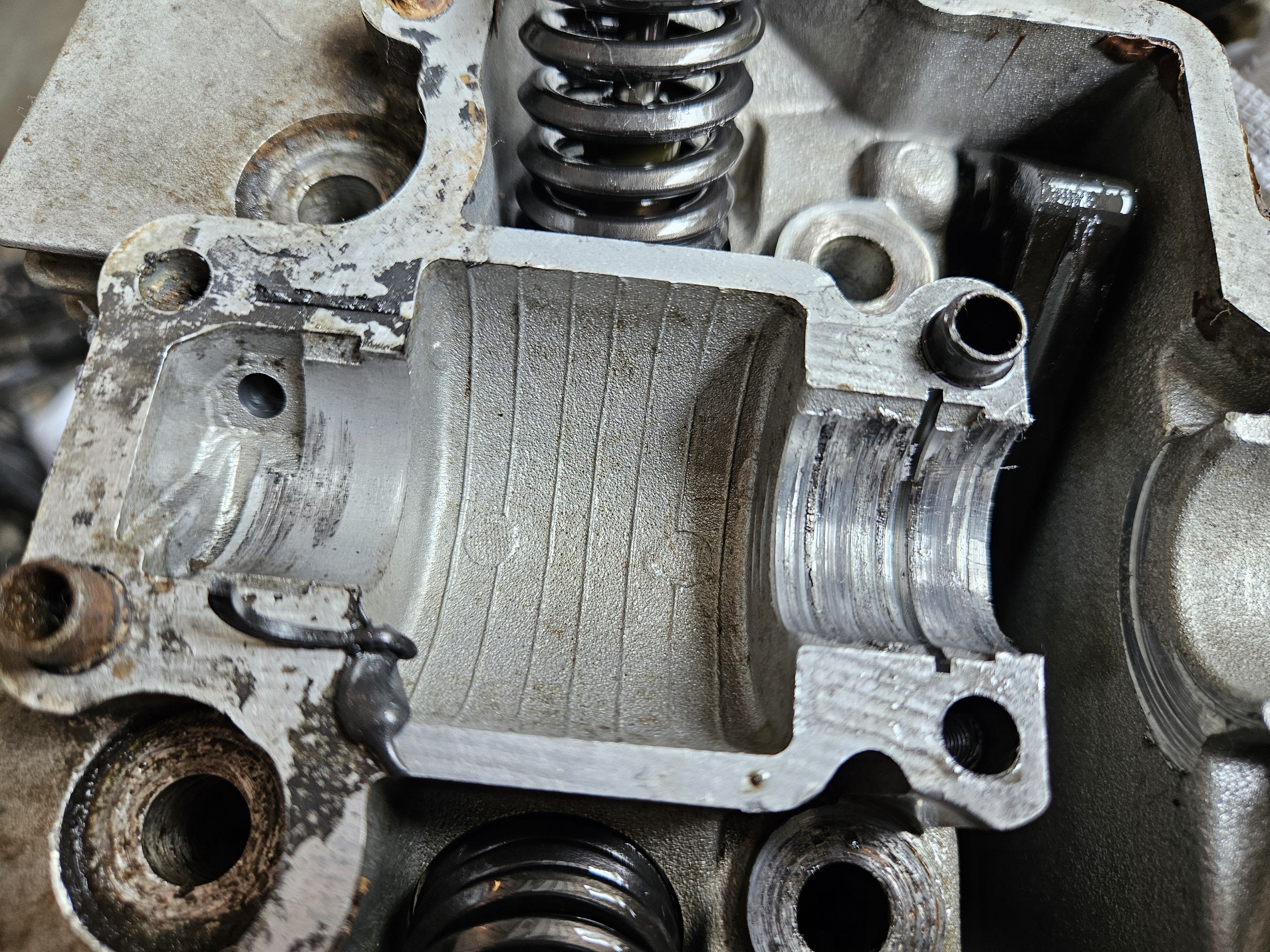

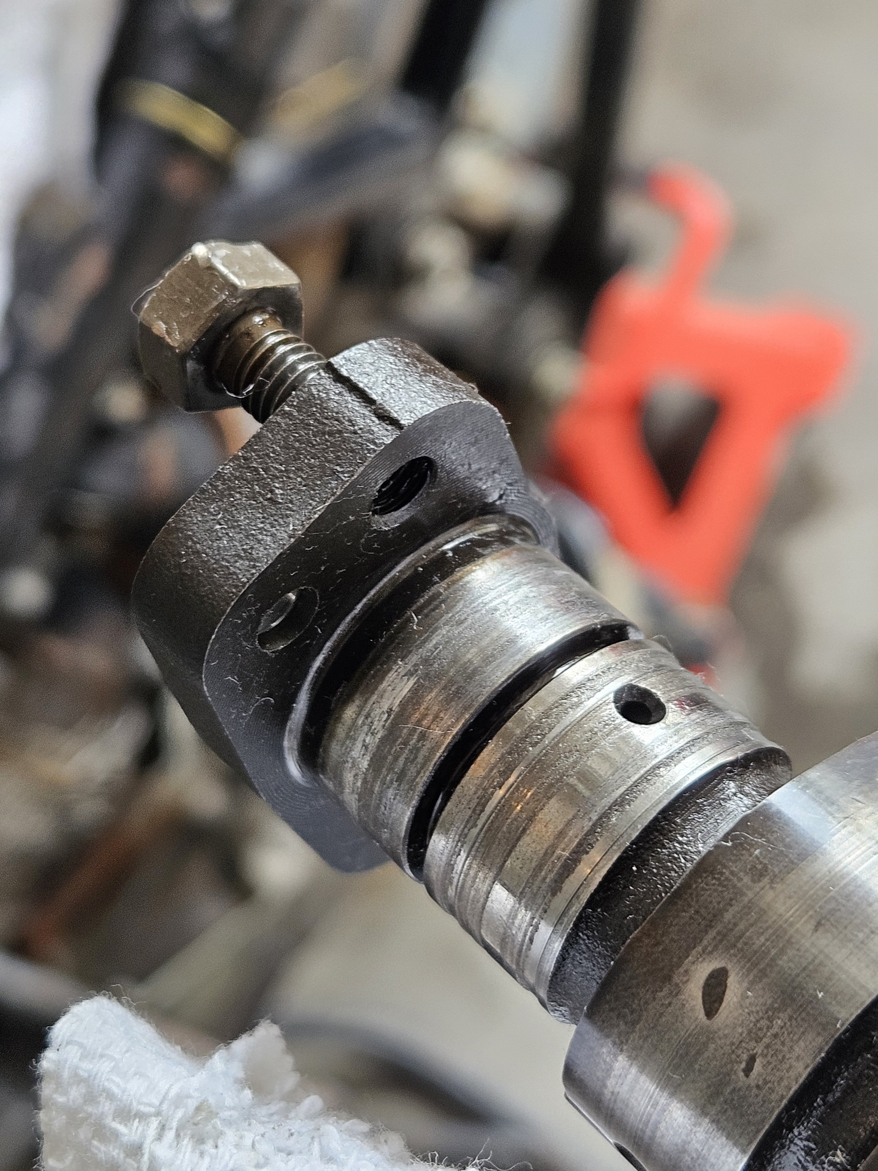

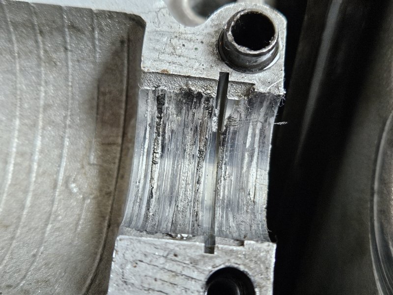

Here's some pictures, they look pretty chewed up. I know that it might be possible to grind down the "bearings" and insert real automotive bearings but I'm not sure if that would be worth the cost versus a replacement. The cam also looks pretty rough and I'm not sure if that's salvageable at all.
I think you are on the right track replacing the head, thats what i would do, machine work is not as cheap as it used to be and could exceed the price of a used head in good condition. I would look on Ebay and im not a big Ebay fan but when it comes to good quality used parts i have had good luck, there are somw quality seelers of good parts there you just have to look.
The inner most bearing would be easy and cheap to machine out and fit a caged needle roller bearing, which I've done several times before on honda engines, but that sprocket flange is a problem at the other end. On a honda you can fit a common ball bearing race on that end, but not on the suzuki.. It does look like a repair or replace of the head is going to be the way to go. I'd clean it all up and go pick the brains of a competent engineer, he may be able to build the bearing surfaces up and machine them easier than you think.

Ended up getting the cylinder bored and honed by G&H Discount ATV on ebay, $200 and included a new Namura piston and rings, a Hi-Caliber top end gasket set.  Picked up a used cam and head on ebay, they were both in pretty good shape to start, I cleaned up the journals and the cam, with some 1500 and 3000 grit with WD40, they came out beautifully.  Had the fight with one of the rockers, the PO broke off one of the valve cover bolts that holds the rocker shaft in place... Had to drill it out and absolutely wreck the shaft and even further wreck the valve cover, but at least I was able to save the follower/rocker itself, those aren't cheap.  Cleaned up the contact patch on those with the same 3000 grit and they polished up nicely.  Other than fighting ongoing chinese carb issues it runs great and has excellent compression now as you'd expect.
