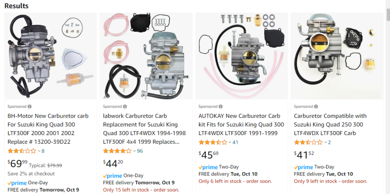

Did you ever get this fixed? I would check/replace the air filter and fuel filter a start and the rebuild the carb. However, depending on your budget, I would just buy and slap a new one on there. You can get them for under $50 on Amazon
Suzuki King Quad 300 Carb
I know this post is a couple months old, but have you had good luck with these carbs? I had bought a cheap one on Amazon awhile back for a mower, and it seemed ok for the short time I had it...🤷🏼‍♂️
I have actually, but I only buy ones with a high level of good reviews. I have found that on more than one occasion where I’ve had a part failure from something purchased on Amazon, I should have read the reviews!
