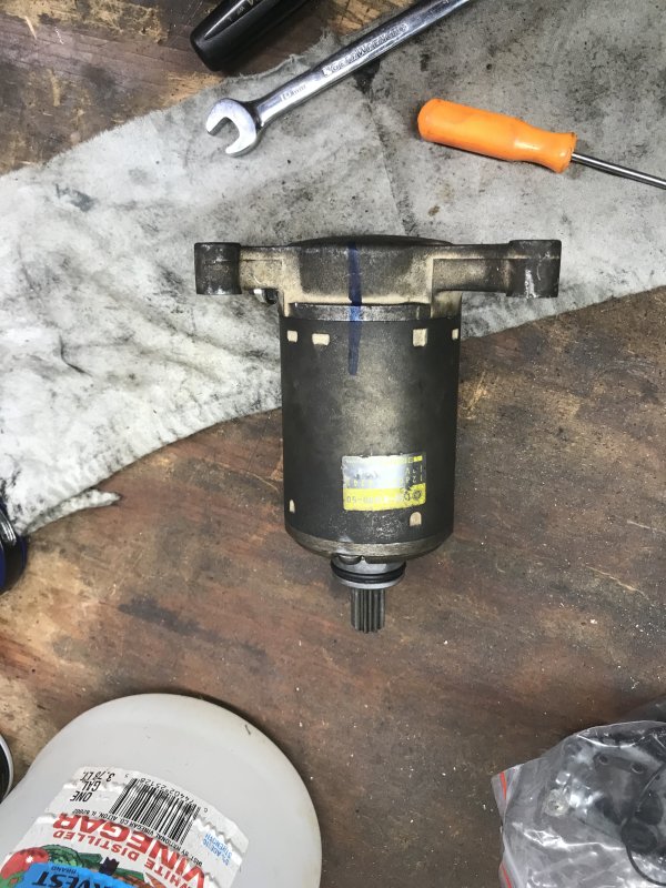

On a side note, i replaced the brushes on my starter, they were $10 off eBay and it worked. The symptoms of the starter was it was going slow, or not at all unless you tapped it. IF....you take your STARTER....apart, put a line down the side. I haven't taken motor theory class yet but, it was reverse polarity twice after i put it together, i guess i had the magnets in the wrong spot.
