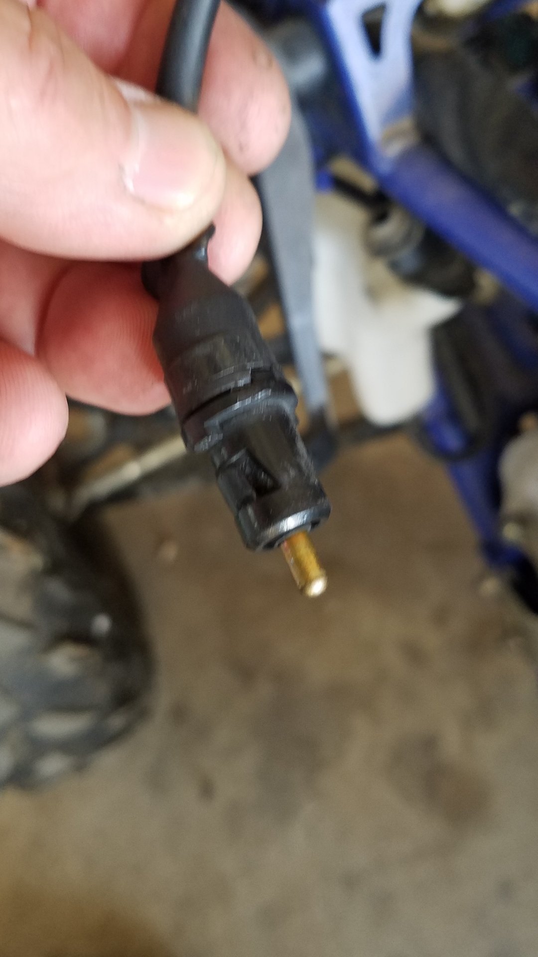

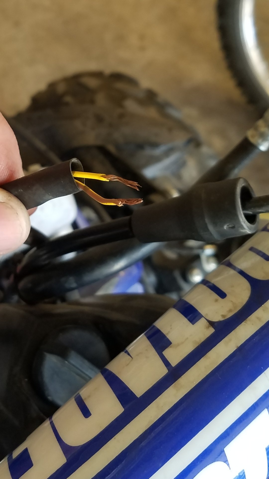

 I tested the fuel pressure. According to the manual it's supposed to be tested while the engine is running. I didn't have the right fitting to do that. But, I could test it without starting it and I did that. The pressure went up to about 45 psi (the book calls for 46) and then it would drop off. So, I figured a cheap fuel pump would tell the story. So after the fuel pump change, same thing. I adjusted the valves, just because I hadn't done it. Then the thing wouldn't crank over. Whenever it would hit the compressions stroke, it would almost stop. So I figured I did something wrong. I checked the cam timing and I was 1 tooth off and that made the changes that I made to the valves way off. I got that straightened out. Now it would crank over, but not start unless I gave it shot of ether. So, now it's getting no fuel at all. I changed to more expensive pump, and it did the same. Now, yesterday, my wife asked about these wires and this plunger looking thing hanging down. I said I didn't know what they were, so I grabbed the plunger thing and hit the starter and it fired up! And then died. It fired up a couple times, a couple of times it wouldn't. The plunger thing didn't have any effect on it. Or the other 2  wires. So, that got me thinking that there's a short or a loose wire somewhere.
I'm not sure what these 2  things are. They weren't hooked up when it came here.

Basketcases are always so much fun. There used to be a Raptor service manual in the downloads section so I'd start there and run down any loose wires and odd items hanging around.
Sounds like you do indeed have a fuel related issue but it could be harness or ground as much as pump. I think you're real close, just one more hurdle to hear it run.

I have a service manual. I just gotta get after it and get it figgered out. The owner is starting to get antsy. It's been here about 2 months already. But, I had to send the cylinder out for re-plating, etc. Shipping these days is a crap-shoot. Mightbe 3 days..might be 3 weeks... Thanks for the input and encouragement! :D
