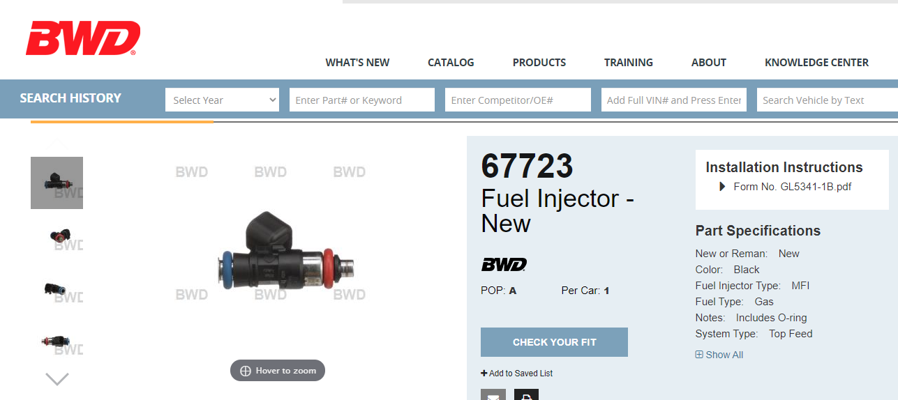

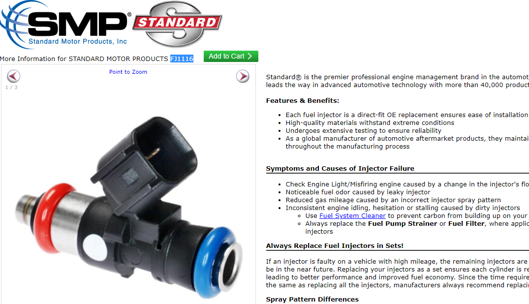

There are a bunch of aftermarket ones available but as far as Automotive injectors maybe start by looking at:
Standard FJ1116
BWD 67723
Not sure if the specs are the same though.
***This is in no way a confirmation of direct replacement for OE and just a suggestion on where to possibly start***
