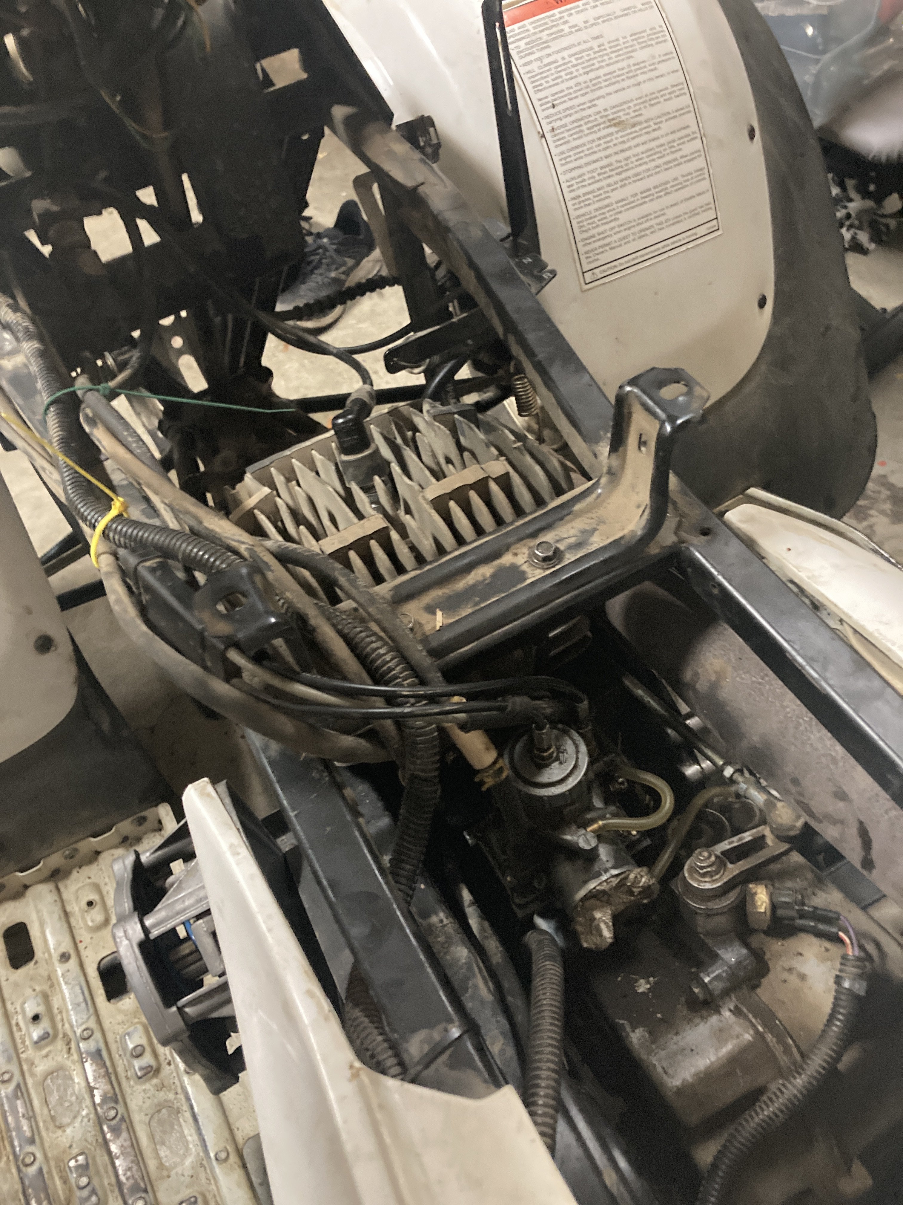

Hi, I am having issues with my TRX350D fuel pump. It suddenly stopped running so I have replaced all the fuses and cleaned all the terminals. I have fitted a new pump, fuel cut-off relay and rectifier. Still nothing!! The pump runs when attached to a battery. The engine will start on the choke and the filter fills with fuel but it will not rev and dies when the choke is closed. I have power to the relay but nothing at the pump black/white wire when cranking the engine. Any ideas where to go from here would be very much appreciated!!
