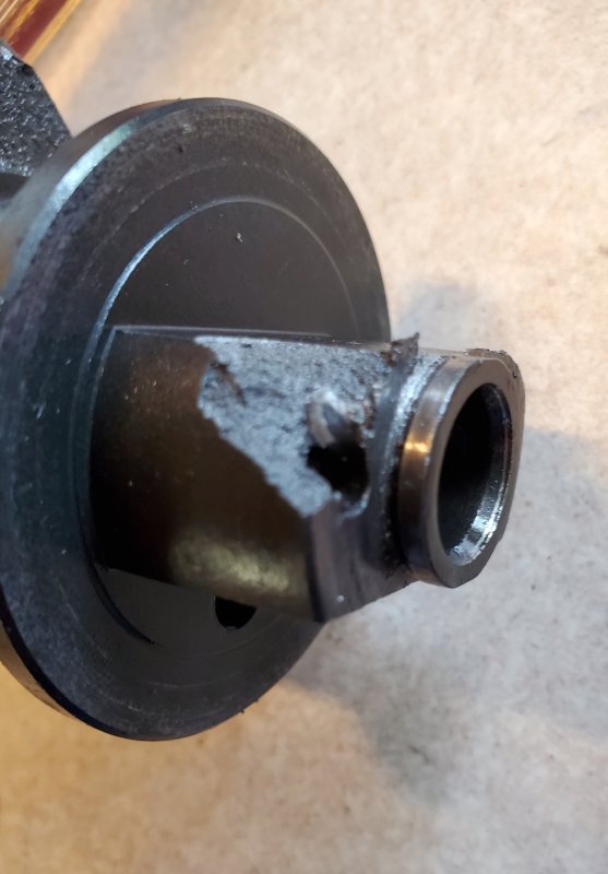

Somehow the pin that holds the timing great in place broke the the camshaft. I am trying to figure out how this happened. I found a small ballbearing in the head and after trying to figure out where it goes I think mystery solved. It appears like it fits in a hole on the back side of the exhaust lobe. anyone know for sure?
My guess is it came out of the hole it was in and got bounced around until it broken something. It seems like a really poor way to design it. I am guessing there was a spring behind that bearing that I haven't found yet.
