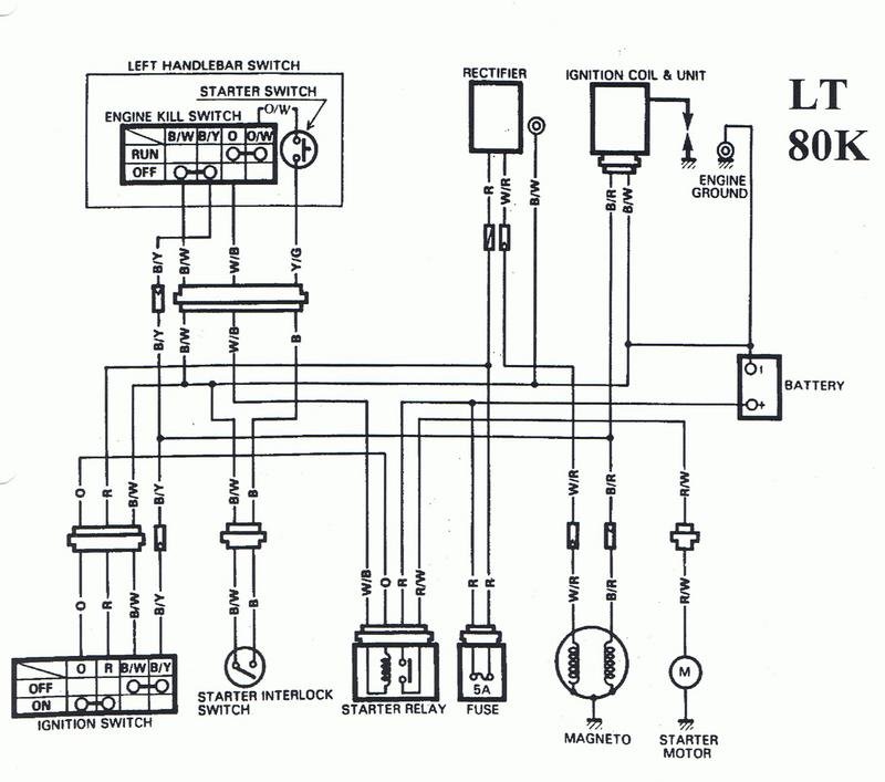

Hey guys, hope you can help me out here. I was gifted an early 90s LT80 and it had sat outside for a couple years. Upon inspection I noticed the wiring harness was all chewed up and had couple splices. I tried to get it to work and was getting nothing when I pressed the start button so instead of messing around with it more. I just ordered a new wiring harness along with a starter relay.
I have everything hooked up but the clip on the new harness for the CDI/coil is 4 prong when the cdi/coil is 2 prong. Is there anyway I can splice this into the two prong adapter or do I need to get a new cdi and coil.
Also is there a way to test the start stop switch on this as I’m narrowing down why I am getting nothing when I try to start it. Relay doesn’t even click. I have sliced the brake switch and the reset button wires together and am getting nothing. Shouldn’t it still be turning over without spark if the coil isn’t connected?
Please help and thank you
