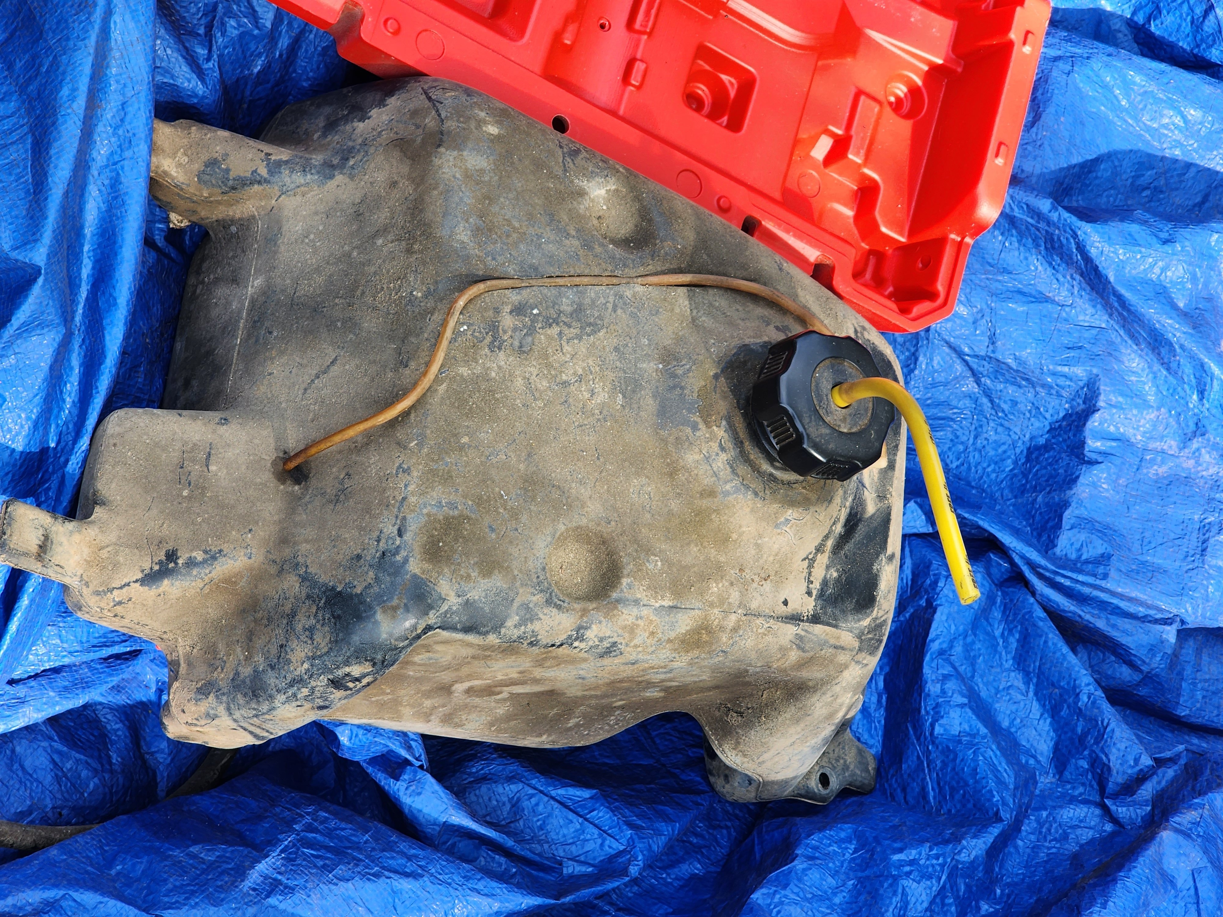

I disassembled everything to remove carb and replace. My problem is there's a small plastic tubing that runs from top of tank to somewhere but, the other end came loose but I don't know where it goes. I know I have the hose on the gas cap but, the other one has me baffled the service manual doesn't show. Any help would be appreciated.image.gif.559f8eb22172fe78bebe836373ebd3e5.gif 🙂

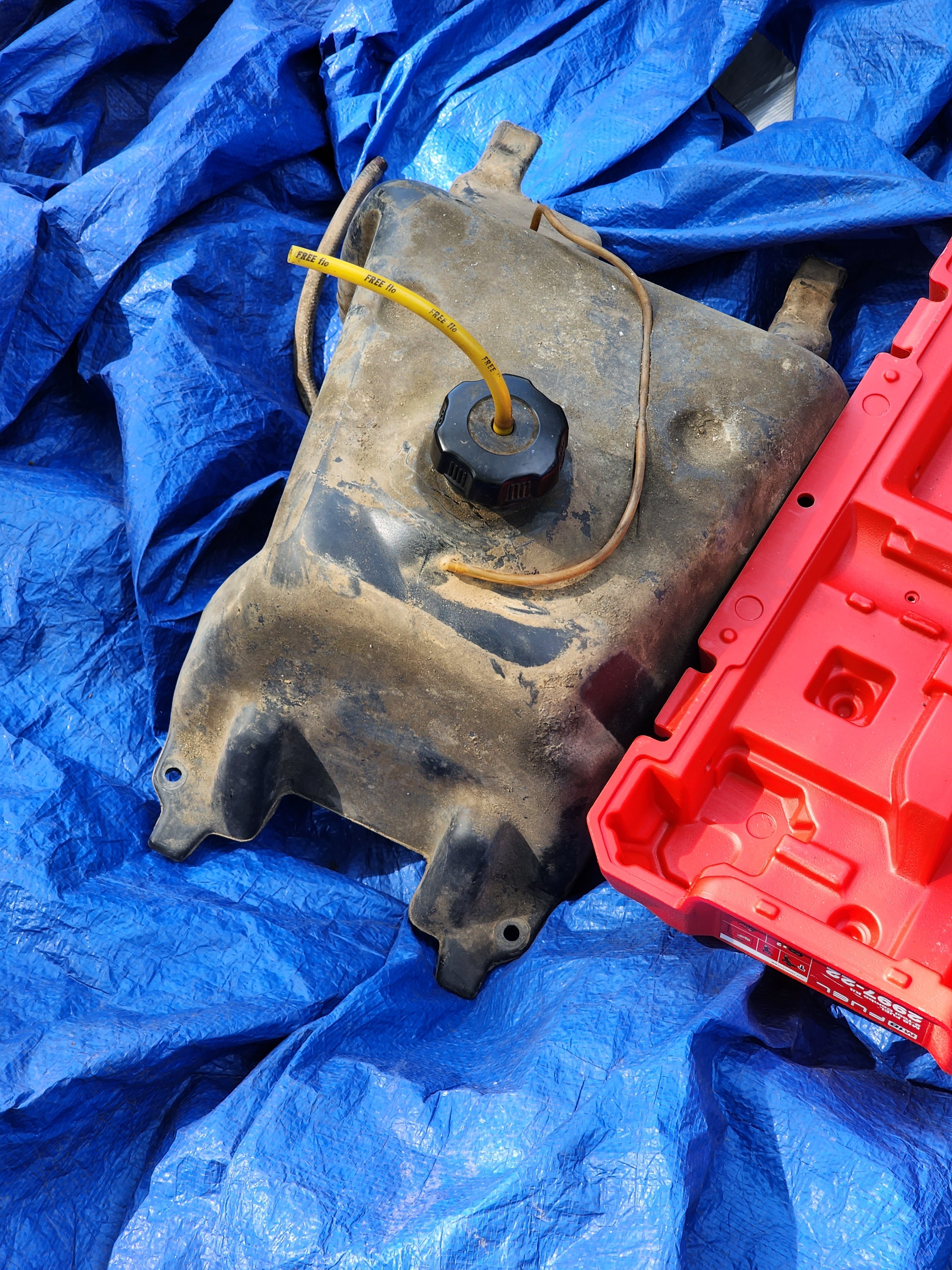

The hose in question is the one that's pushed into the groove on top of the tank. I'm thinking, it might serve the same purpose as the one coming out of the gas cap. Any thoughts on that? I'd just hate to put it back together and find out later, it had an important purpose as I'm in no hurry to take this all apart again LOL!20230531_154606.thumb.jpg.2d6bc4dcb1d43ee962ddca89e019795e.jpg20230531_154548.thumb.jpg.75b2635fdd3902ee3b6dc237ec011f31.jpg
  • Solution
Correct, vent/ overflow , don't like it much , if you fill the tank too full fuel will come out this hose, it just kind of hangs down by the frame. kind of annoying when trailering with a full tank
