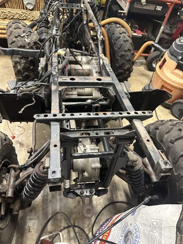

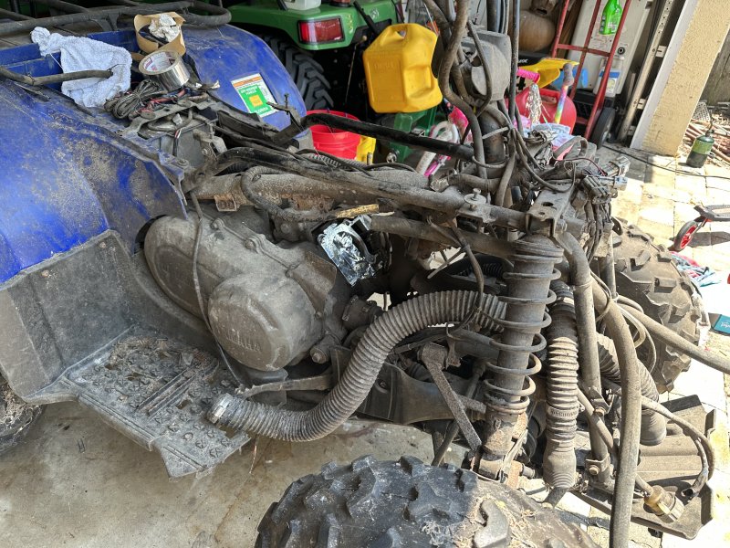

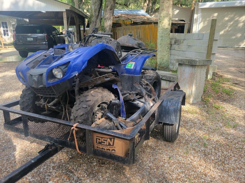

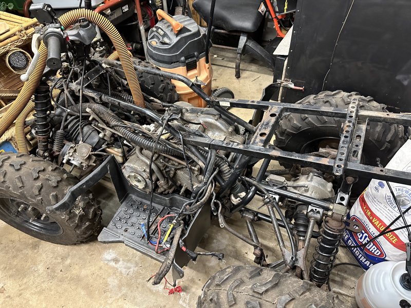

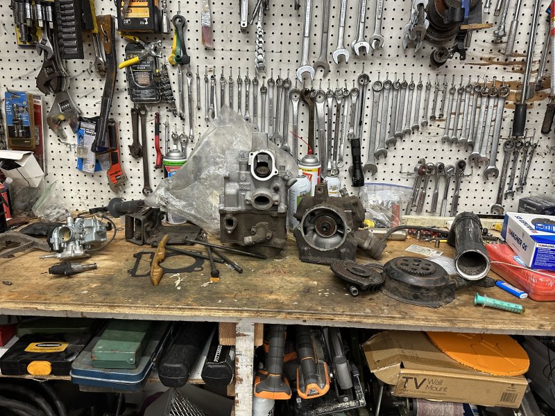

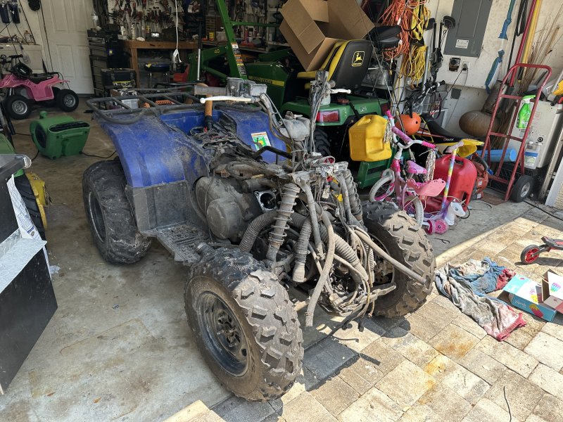

I was given a 07 big bear 400 with all the options. The prior owner ran it through water and it started smoking  so he took the head off and gave up. I have  a bunch of parts in boxes and did a quick inventory.  I need a jug, piston, rings etc and thinking it’s better to buy a complete top end. Does anyone have a recommended site to buy parts? I plan to go oem, no china junk but if there are quality aftermarket manufacturers I’ll do an upgrade.

I have a jug but the cylinder has surface rust and I need to look at it closer but I’m betting it’s scorned.  Piston is missing. Oddly I have two heads.   I can freely turn it over by hand. Prior owner thinks they got sand in with the water. I’m perfectly comfortable breaking the lower end down this one is worth keeping.
