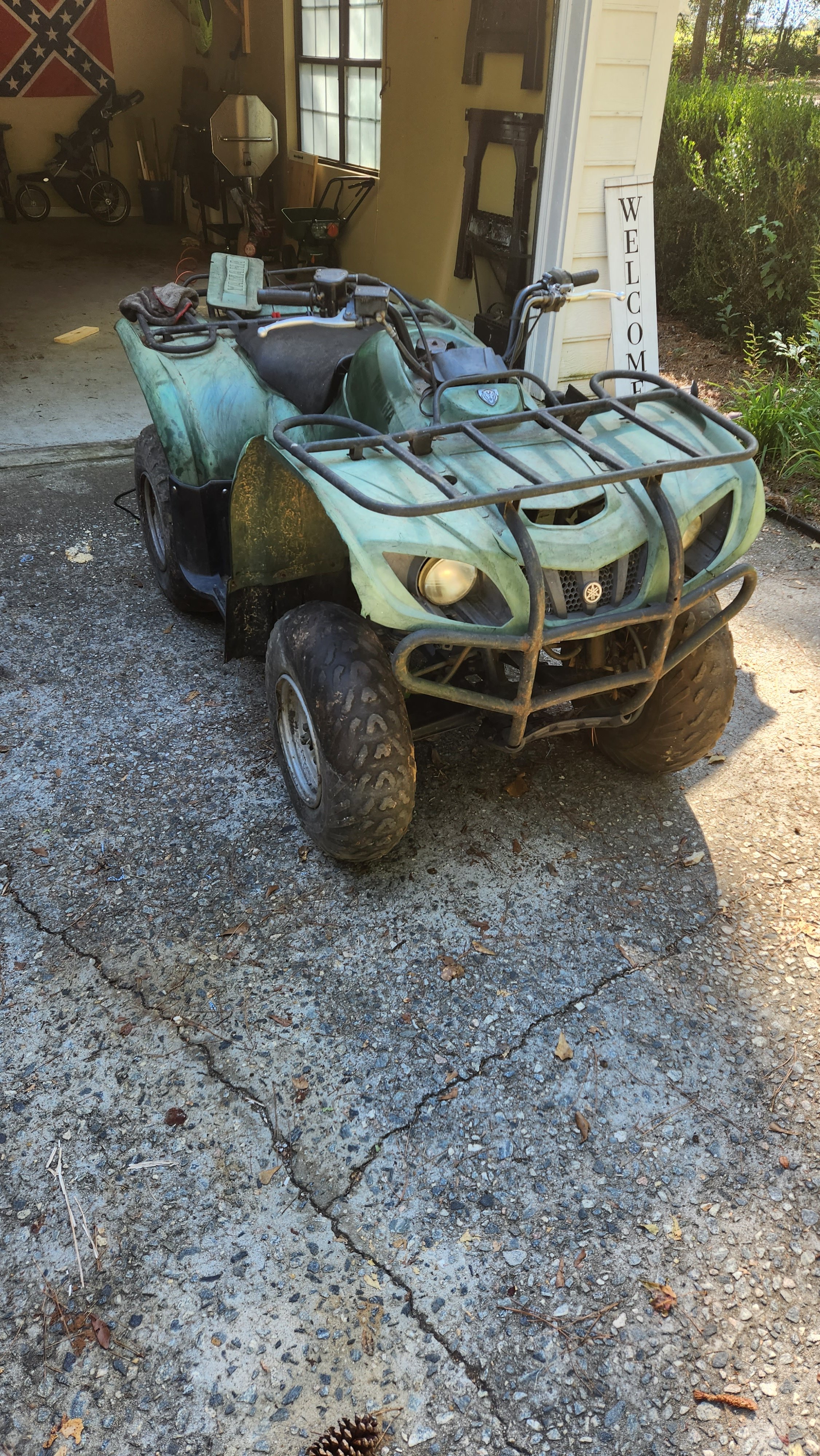

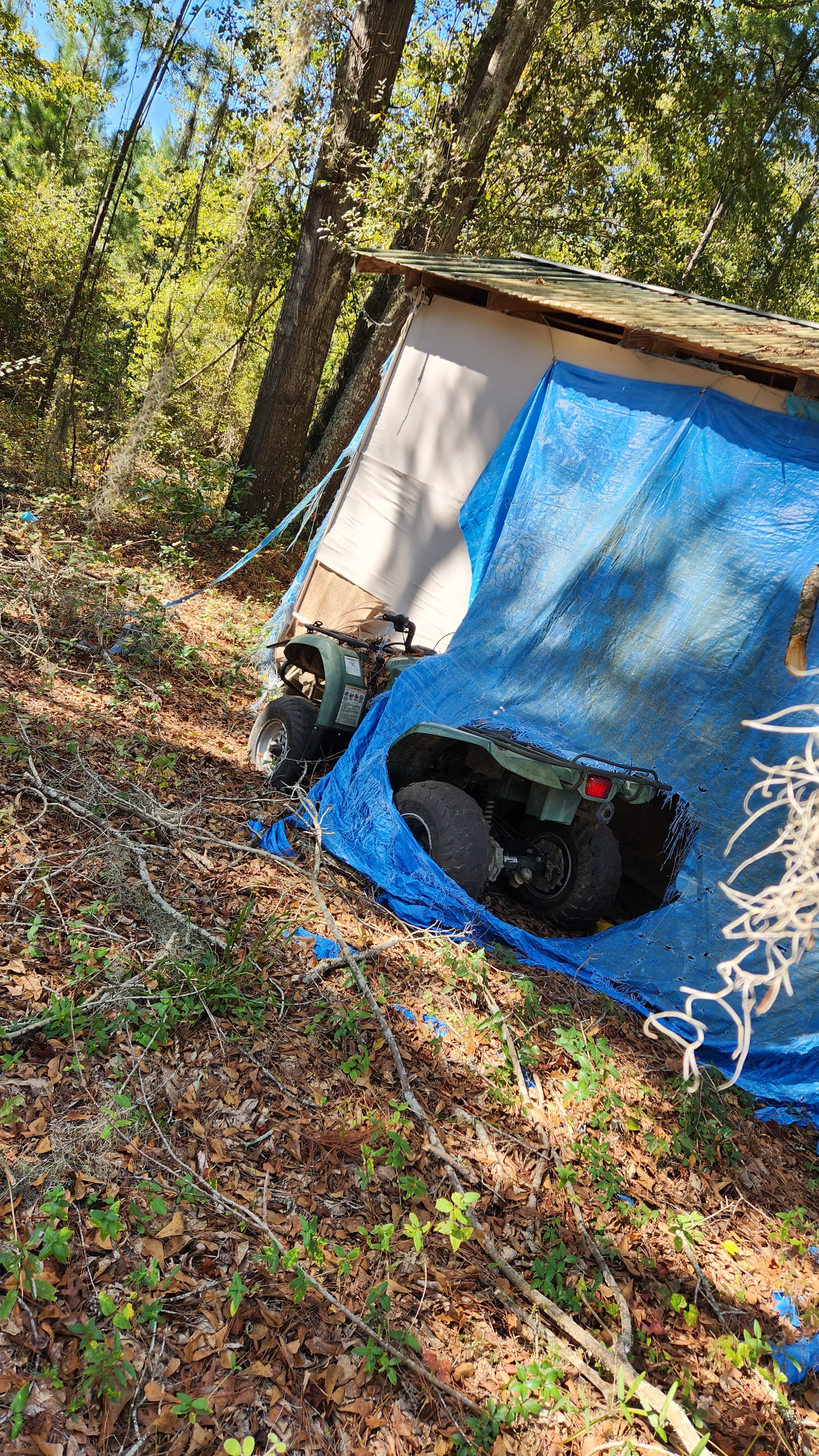

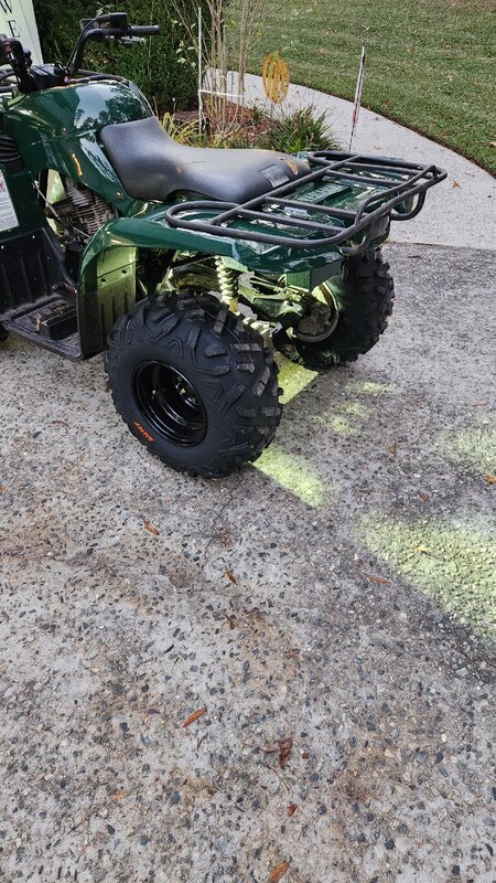

I picked up this 2008 Yamaha Big Bear 250 2 weeks ago. A guy that I hunt with parked it at the hunt club for a year or so before I asked him if he wanted to sell. He said " fill my feeder and throw some batteries in my cameras, and you can have it". Sounds like a deal to me!
I have attached some pictures of how it sat under a tarp in the woods and when I got it home and cleaned up a little.

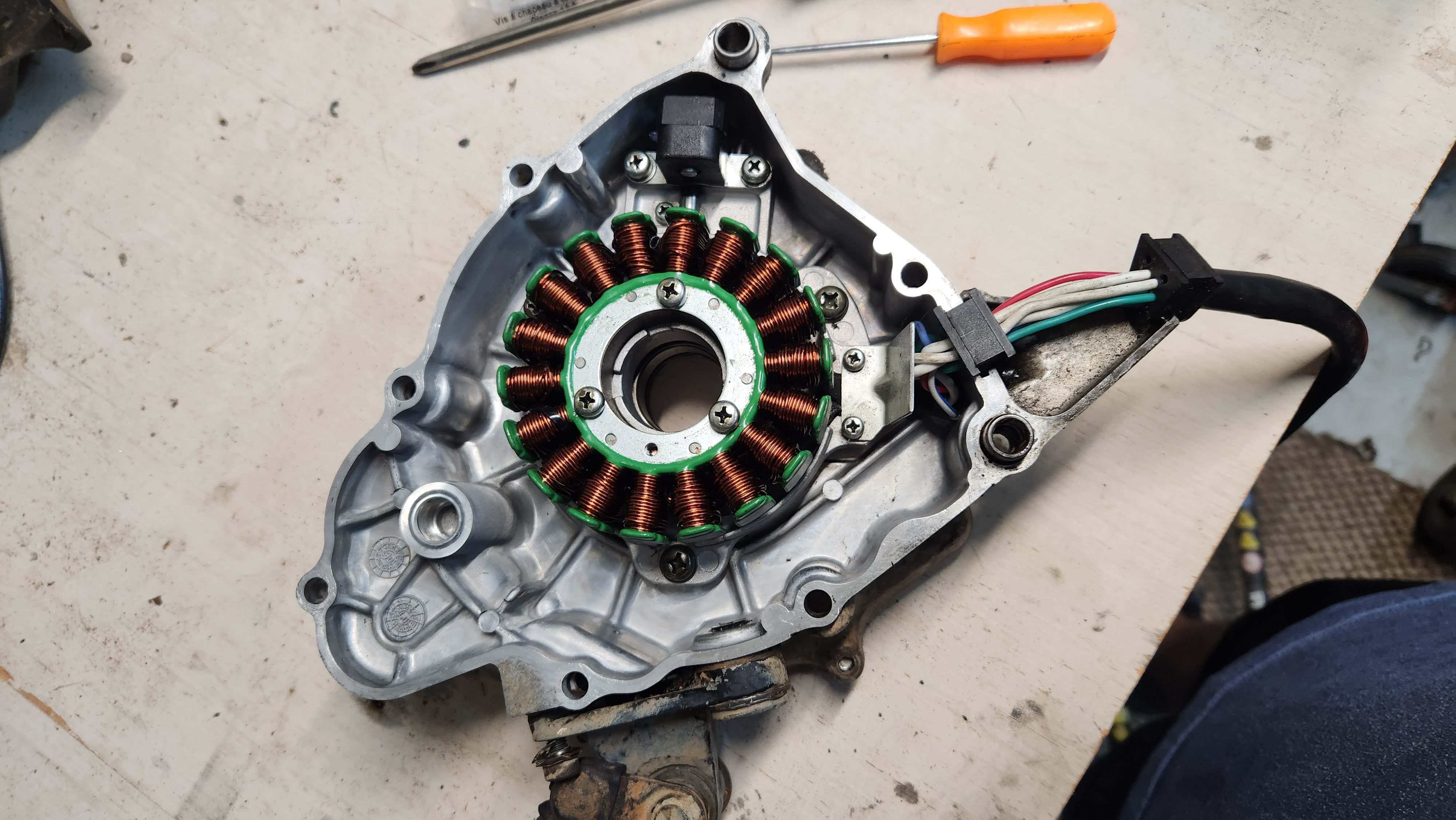

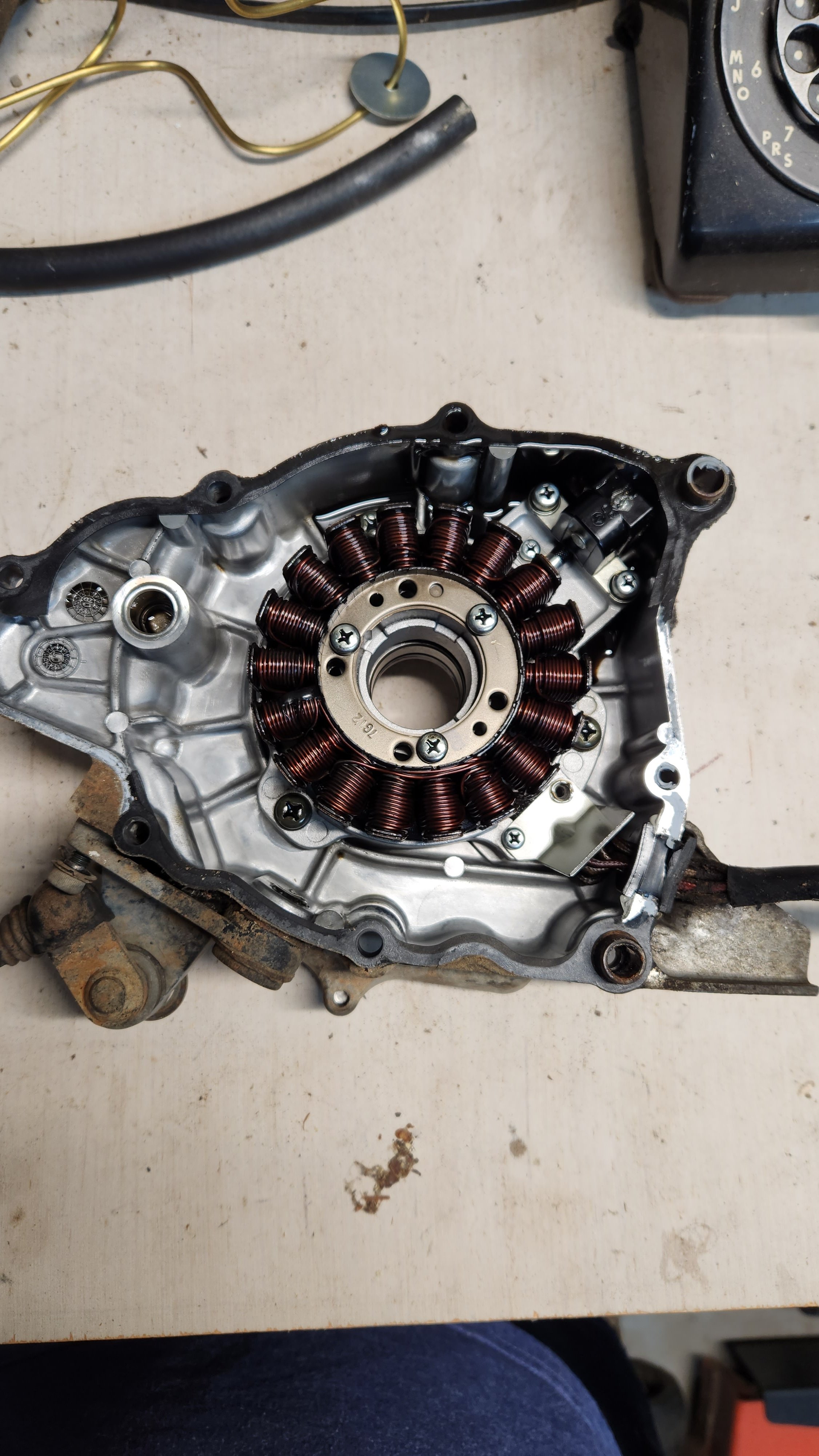

After poking around I managed to get it to turn over with the starter. I found I have a no spark issue...lovely. I printed some electrical diagrams and me and my multi meter got to work. Found I had 2 out of the 4 wires chewed off on my stator harness. Decided to order a new one and install.
Tonight the new stator showed up, tore it down to get to the old one. Only had ro drill out 2 bolts to get cover off. Not bad. Gonna run to store tomorrow to grab some replacement bolts. Until then, this is where I'm at
Took a picture of the old stator

I'd have to re-pin and terminate the plug for me to keep using the old one. I assumed it was from 2008 which is why I just went with a new one. I'll probably just try and fix it to keep on the shelf for a rainy day.

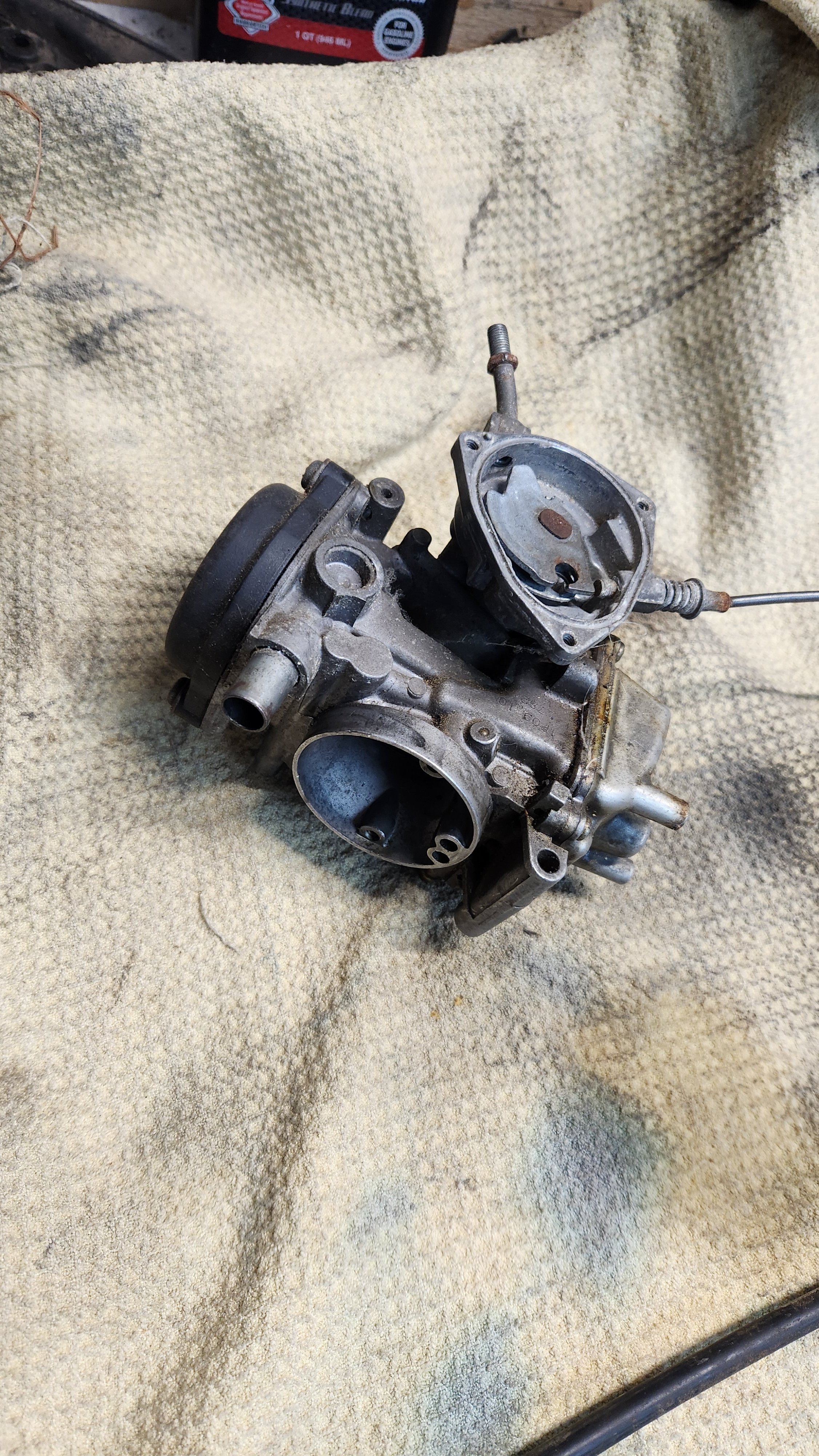

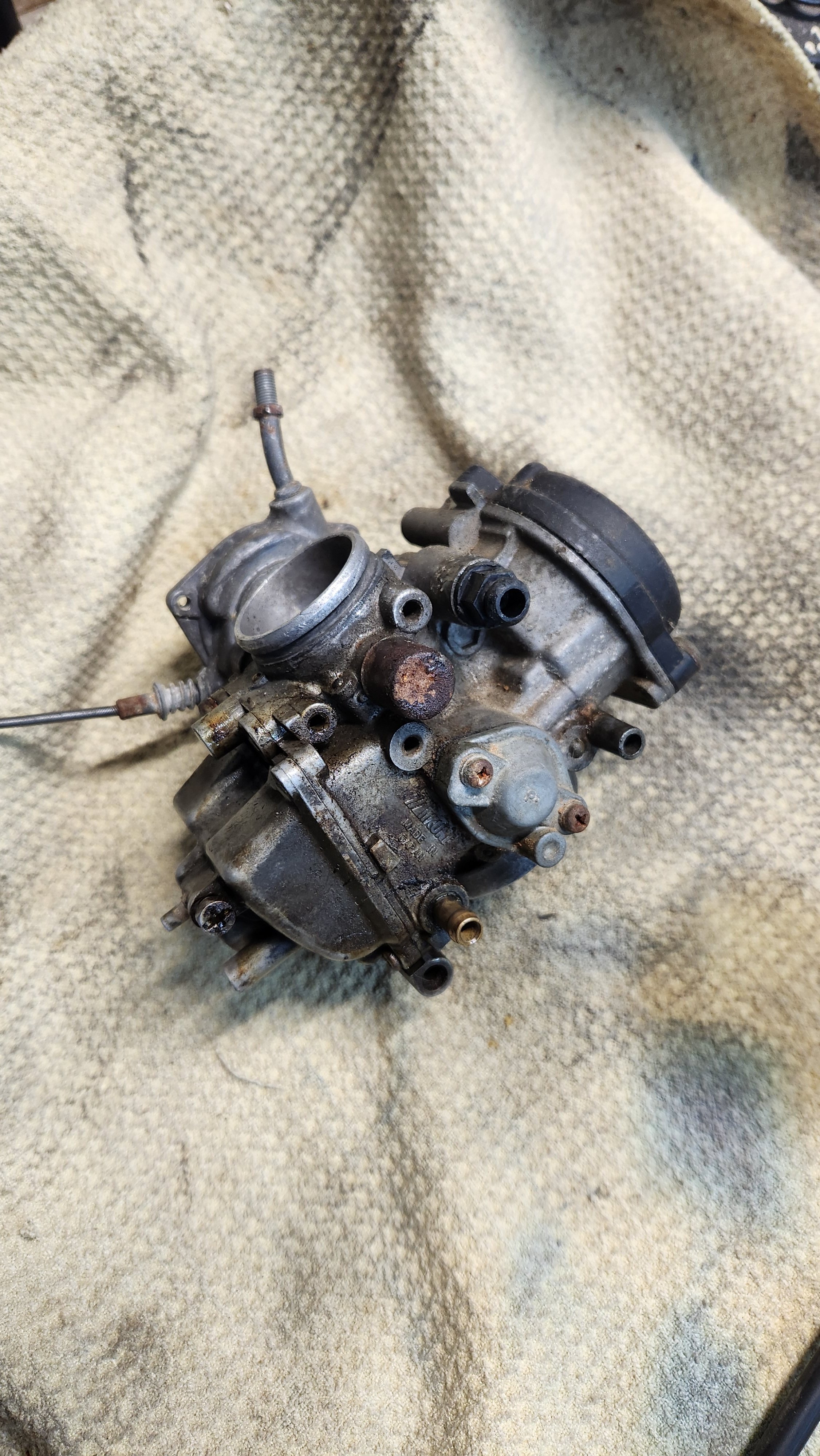

Haven't had much time But got the carburetor taken off and found the choke plunger was missing, that's probably my high idle issue. Anyways, decided to tear the carb apart and clean it up. Currently waiting on a rebuild kit to show up in mail so I can get started. Also need to locate a throttle cover or make one.

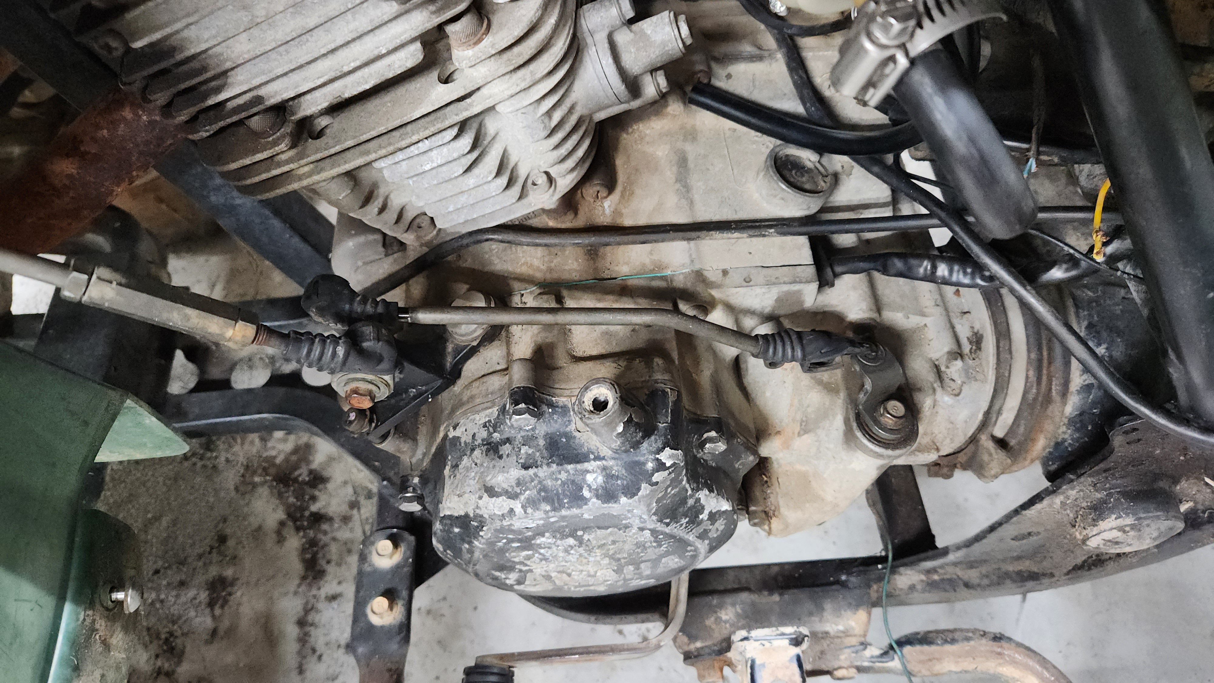

I tested that today. It does the same as mentioned above in all gears. Jerky and noisy. I did take the side cover off, found some metal shavings in the oil filter housing. I'm not 100% sure how to test clutch, but I'm guessing the ol tranny is shot.
2 minutes ago, Gwbarm said:
Is this a 2 wheel drive or 4 wheel drive
2 wheel drive
1 hour ago, Mech said:
It's not likely to have blown all it's gears.. I'd check the final drive where the driveshaft joins the engine..
Okay. I'll take a look at that next!
Good! I like those 2wheel drive ones so light and easy to handle, fun to ride.  I would jack the rear end up to proceed with the diagnosis, then you can turn it by hand in all the gears and get a good feel of what its doing. Evan start it to get the revs up so you can better pin point the location of the noise. I hope its not too bad.
Thanks for the tip, keep em coming! This will be the 1st time I've worked on an ATV, I'm eager to learn. I do come from an automotive background so I don't mind turning some wrenches!
5 hours ago, Mech said:
Yeah as Gw suggests, jack it up and use the brake to apply some load and then put your fingers on the final drive and see if you can feel the jumping in that cover, or the rear diff.

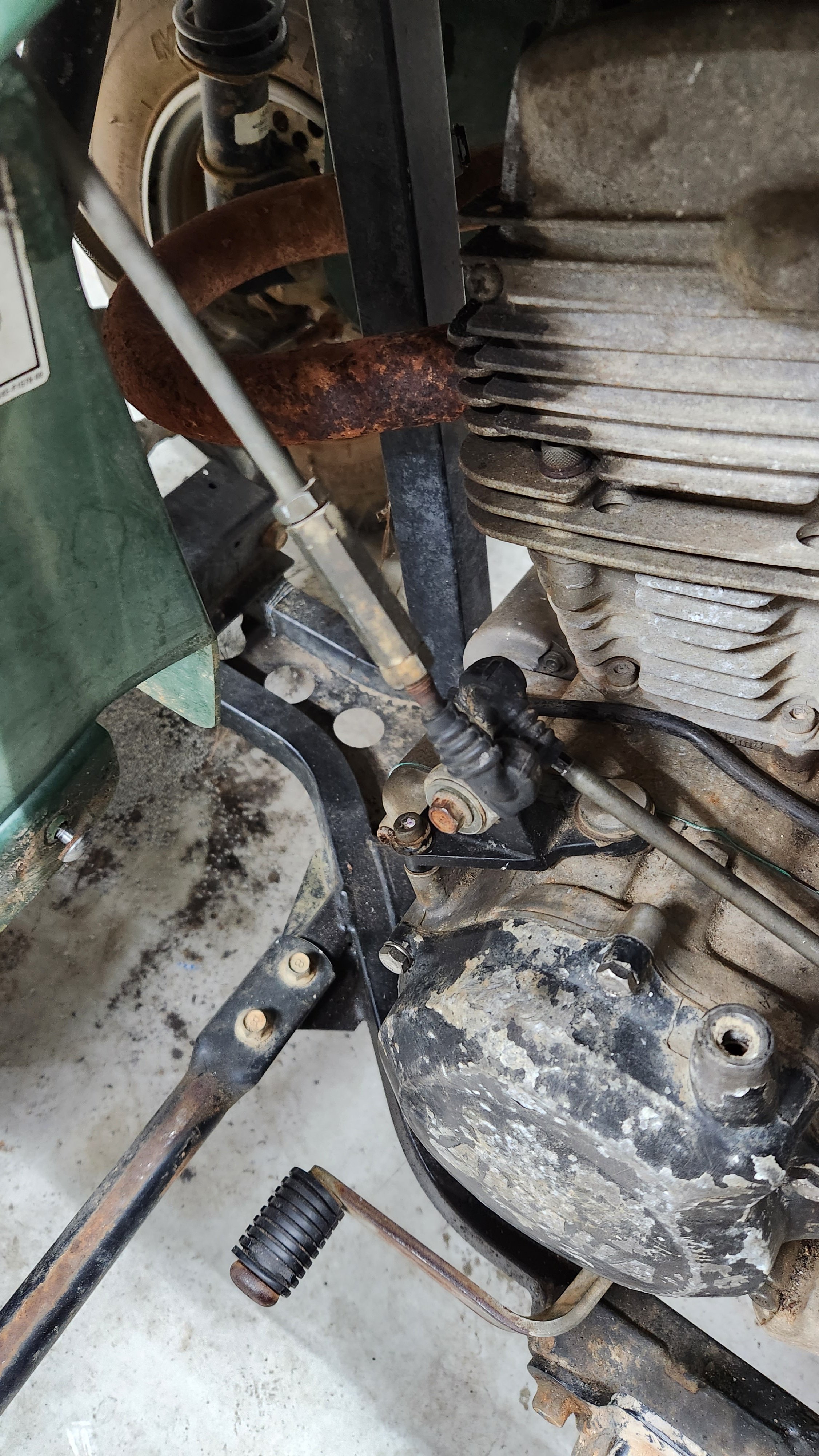

Well boys, we did it! It's fixed! I put the rear wheels in the air and poked around a lil. I found the Forward and Reverse lever wasn't correctly adjusted causing it to drag under a load.  Once I reseated and adjusted that, the old girl rides like a dream.....aside from that busted wheel bearing 😂😂
