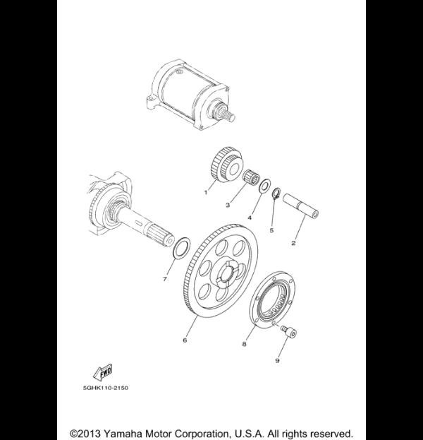

The starter shouldn't be moving once the thumb's off the button, and it shouldn't be touching anything except the gear it engages with, and that gear shouldn't be turning because that gear engages with another gear that has the sprag clutch to only let it turn the crank but not get turned by the crank once the engine's running, so neither gear nor the starter should be turning once the thumb comes off the button.
Compare the old and newstarters, and perhaps strip the brush end and body off the old starter and then fit that starter into place so you can see and turn the armature, then try turning it both ways and one way it should try to turn the engine and the other way it should only turn two gears and/but slip the sprag clutch so the engine doesn't turn..
That part #8 is the sprag clutch/one way clutch and bolts to the flywheel, Once the engine starts and the thumb's off the button none of those parts except for #8 should be turning. When the starter operates the sprag locks onto the big gear.#6 and gets turned to spin the engine via the flywheel. The idea would be to check none of those gears are turning once the engine has started. If you started the engine with the new starter in there, and the new starter was turning when it shouldn't be, it would act like a generator and put out some small voltage, up to about 6 volts probably.. You could check whether there was a small voltage on it's terminal when the engine's running which would indicate the sprag isn't doing it's job ad that the new starter is turning when the engine is running.  Then to figure why the new one turns all the time when the old one didn't.
