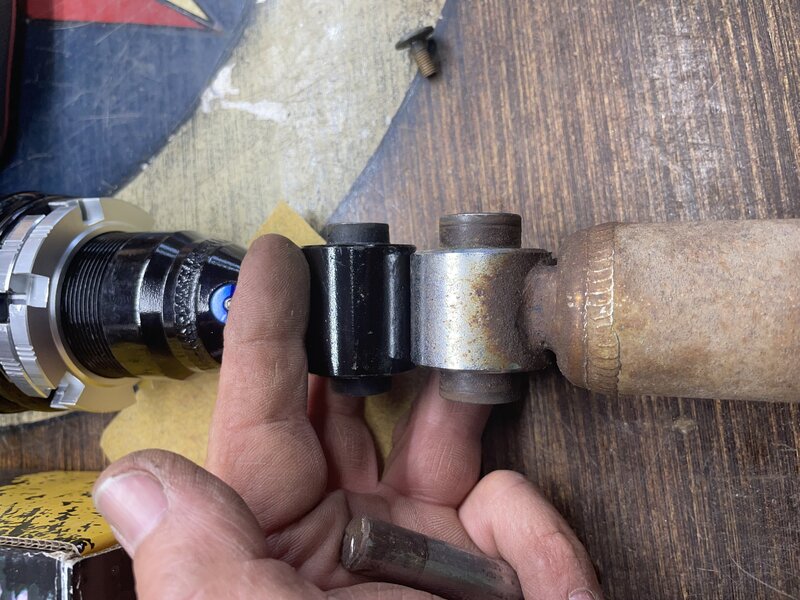

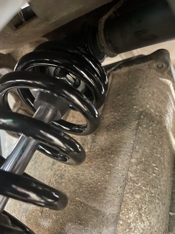

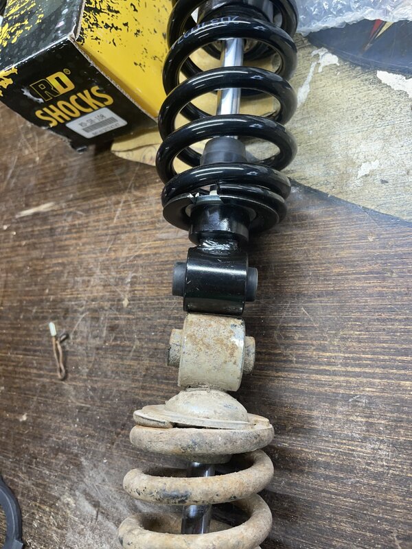

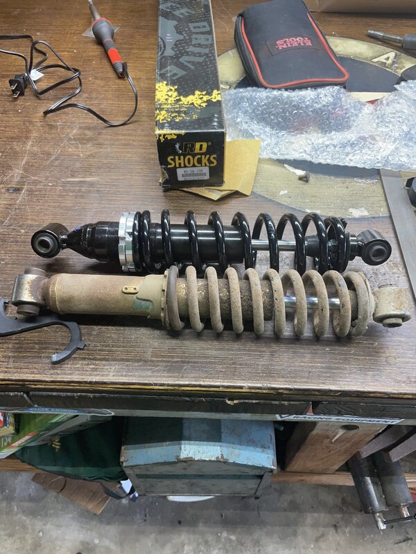

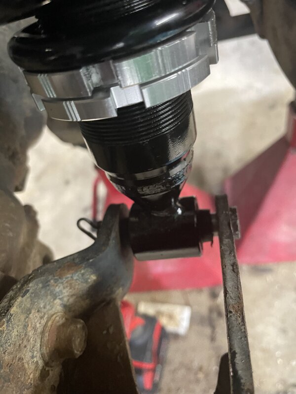

Sorry I suck at these forums so if you see this submitted under update status, my bad. Anyhow this is a new shock for a 96 Yamaha Kodiak 400 4x4 it fits my 96 Yamaha Timberwolf 250 4x4 perfectly. Little narrower are the bottom than the original but everything else is perfect. I extended it to almost a half in from full extension because I’m pushing 350 pounds.  It rides and hold me well. So if any of y'allRace driven shock. have been looking for one and didn’t want to do the research here it is.
