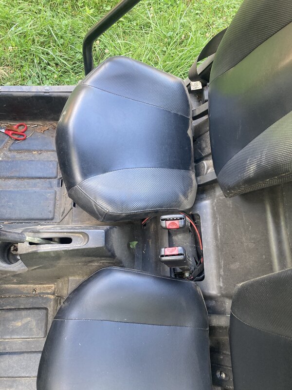

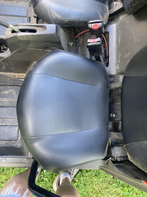

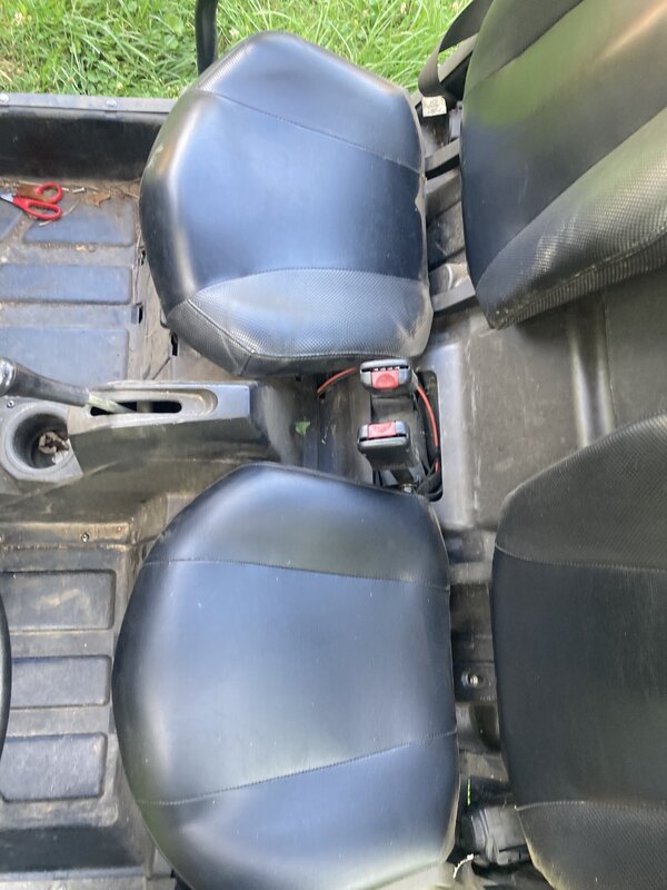

I found some seat covers on Amazon for $35 and decided I would give them a try.  I took the old cover off and cleaned the foam with bleach and water solution. I left the foam in the Sun and it killed off all the remaining mold. I watched a few YouTube videos and bought some stainless steel staples. The cover went on with a lot of stretching. I paid a lot of attention to removing wrinkles and getting the seams straight. There were a lot of temporary staples needed to tack after stretching. I took my time and the seat turned out great. I will take pictures for my next post. Thanks for your posts
I promised to send pictures. Also I recommend getting a pneumatic stapler from Harbor Freight or you will find that the hand held staplers are hard to work with and do not drive the staples deep enough. Additionally I recommend YouTube videos by “Old School Auto Upholstery “ for the techniques necessary for this job. I’m very happy with the results.IMG_2359.thumb.jpeg.43ff81160f5096134fa9d6c1ef6dc273.jpegIMG_2359.thumb.jpeg.43ff81160f5096134fa9d6c1ef6dc273.jpegIMG_2360.thumb.jpeg.03352cf883c5bb8e36369139852f59b4.jpeg
Tne seats look very good, you did a great job. I agree with the pneumatic stapler tip, every time i do one i say im going to have to get a better stapler, last one i did i got an electric stapler it didnt do any better than the mechanical one. I will have to try a pneumatic one.
No i havent i have mostly done ATVs and Motorcycles and they came with custom fit covers. From the looks of your seats the back should also be a custom fit cover cut and sewed to fit the OEM seat foam, there should be some for sale they just slide over and tied at the back to make it tight.
