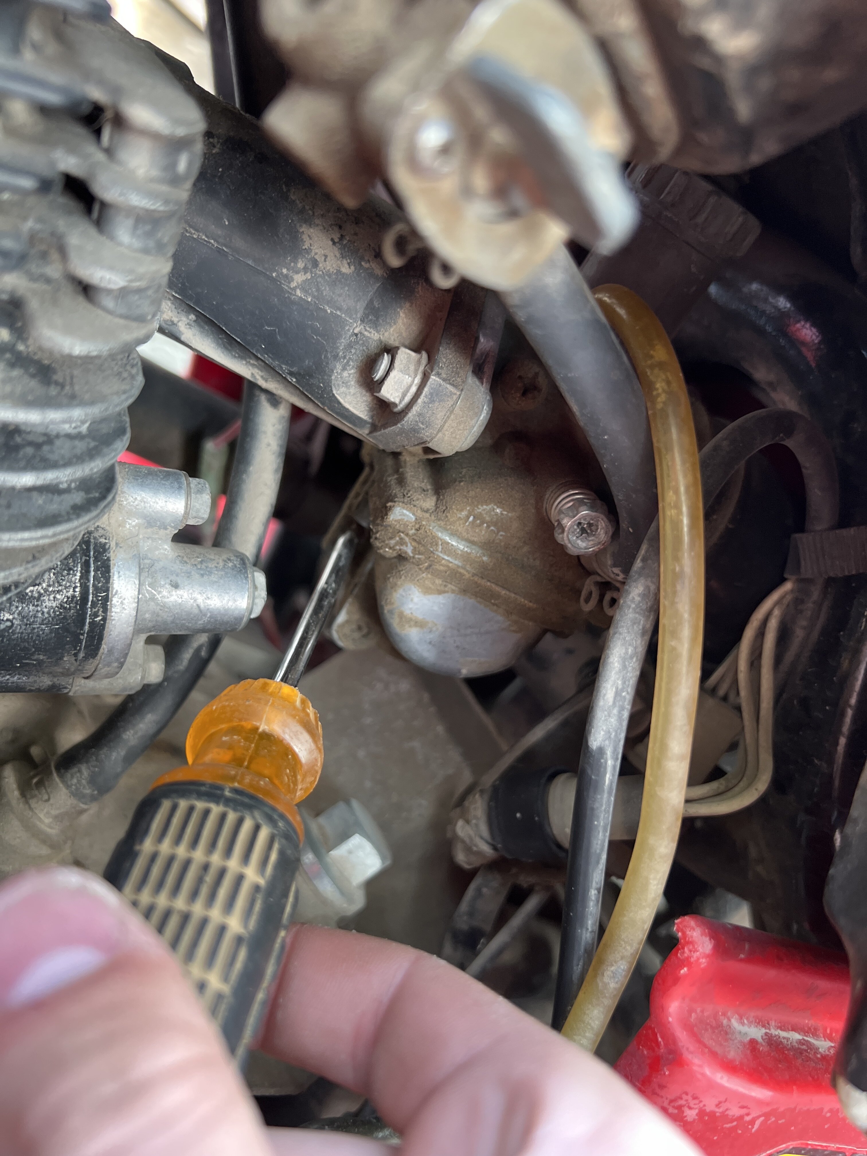

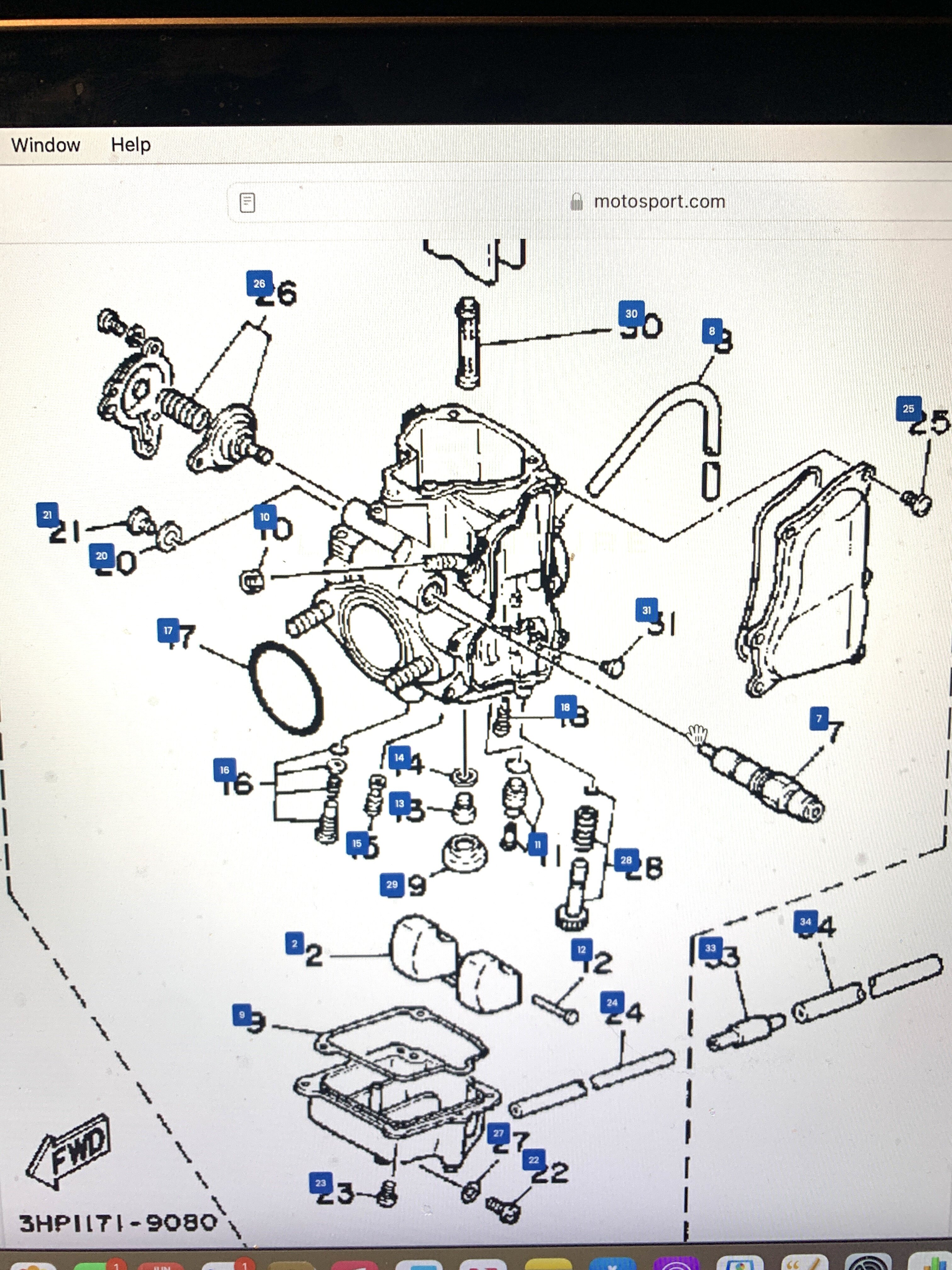

I just pulled up a diagram of your carb. i cant really tell which screw you are pointing to with the screwdriver, but the fuel mixture screw is # 16 on the diagram, and # 7 is your choke plunger, make sure its not stuck. That carb does not look like its been rebuilt recently, you might want to pull it and make sure everything is right.
That's a different carb Gw.. This looks like an old cable on slide carb.
That knurled knob on the side of the carb is the idle speed screw, and the idle mixture screw will be underneath at the front I think, pointing downwards and up a tube/drilling. Where that screwdriver is pointing to.
I noticed that also , but this is the one listed for the 90 Moto 4. Maybe has a different carb or is  a different model, i looked at 89 and 90 and the carb  was the same. I thought the knurled knob was the mixture adjustment also , but i had never seemn one with a knurled knob.
Oh the knurled screw might be a mixture screw, in which case it will be either forward or back of the slide by a half inch or so. I think that is in the center-line of the slide and touches under the slide to hold it up to idle position.
Still not sure about the carb, but i tool a closer look at your photo and oomed it up , it does look like that could be the mixture screw, but i dont see how you are turning it at that angle, thats makes more sense that the one with the knurled knob would be the idle adjustment screw, although it appears a little low on the carb.
Well the screw that I was pointing to was flathead and brass so that’s why I thought it was the fuel screw, but good news I messed with it a little and was adjust those two screws and I think I got it running pretty good. I had originally bought it from Facebook marketplace and I hadn’t run in a couple years and there was a bunch of stuff missing, so thanks for your guys help I really appreciate it I’ll send a before and after picture for you guys so you can see
Also sorry gw but that is definetly not the the carb on my quad haha
I knew that when i sent it, i was really sending it for reference, according to motosport thats the carb that came on it from the factory. Glad you got it running better, keep up the good work and you will be riding soon.
