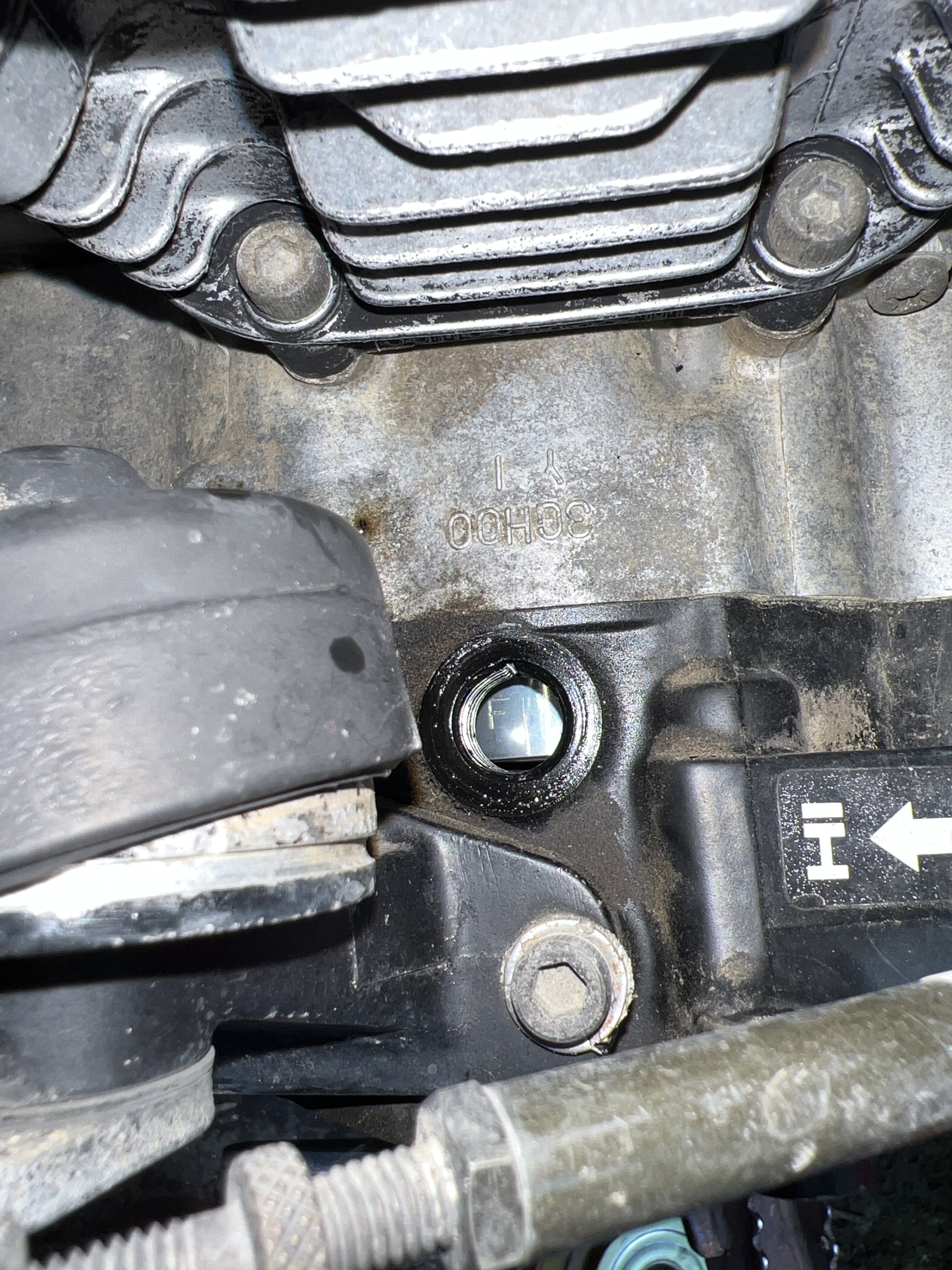

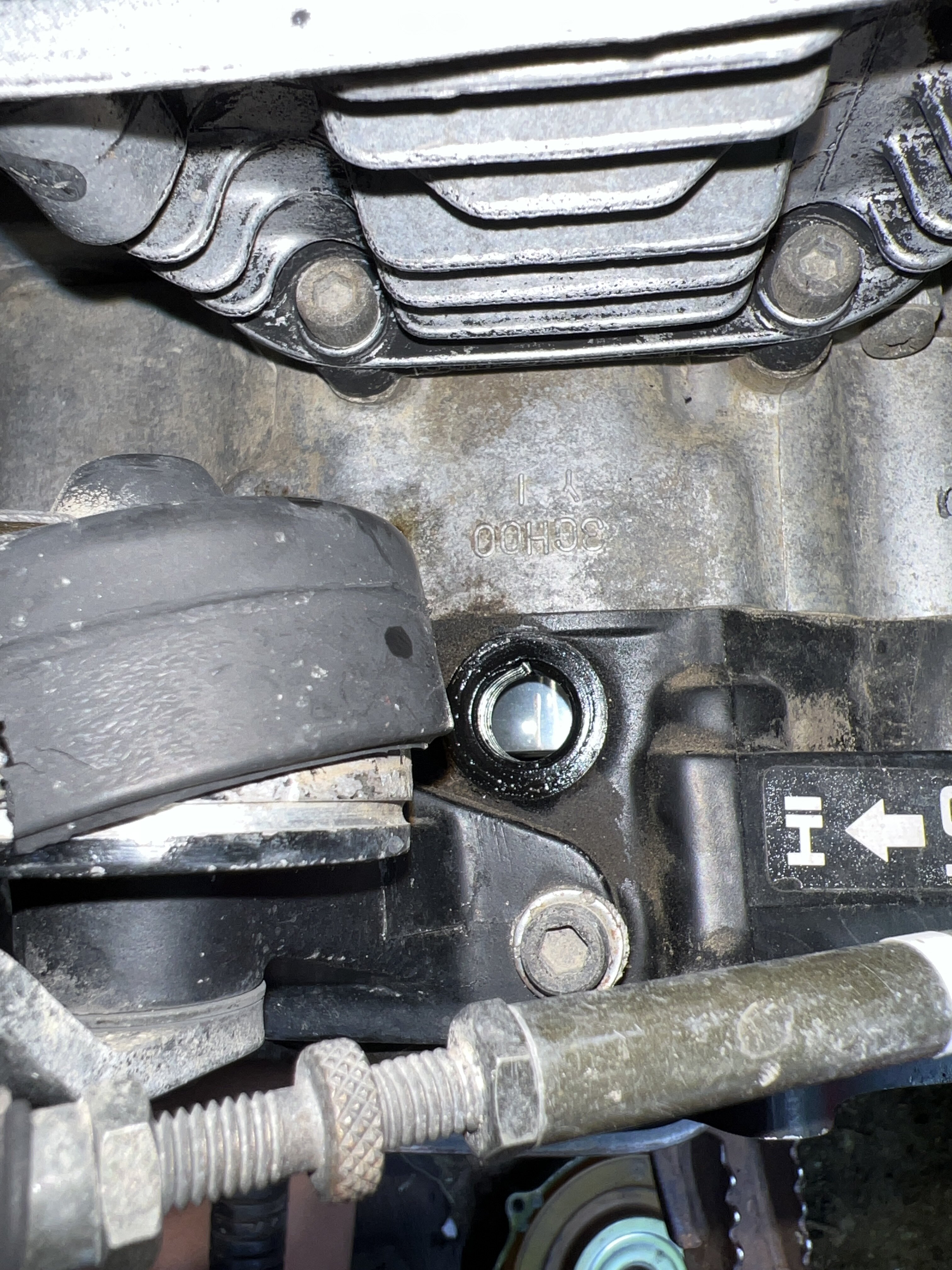

 The other line should be top dead center, some have a T beside it but i didnt see one on yours. and the F is when it fires. It looks like yours is in perfect time, they most always are, timing advance is controlled by the CDI, yours is so minor i dont think that is the problem, i think i would try the next size larger main jet.

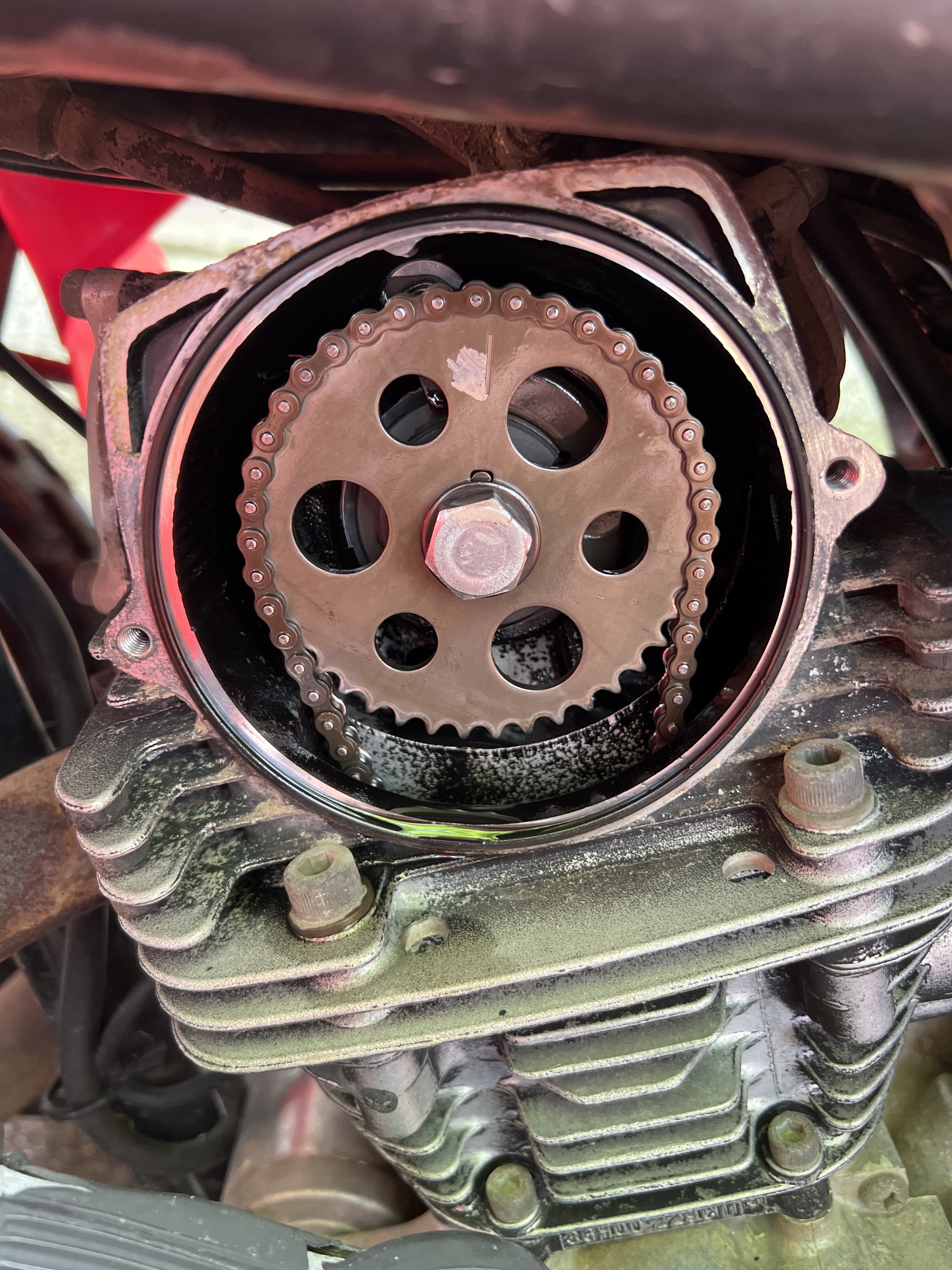

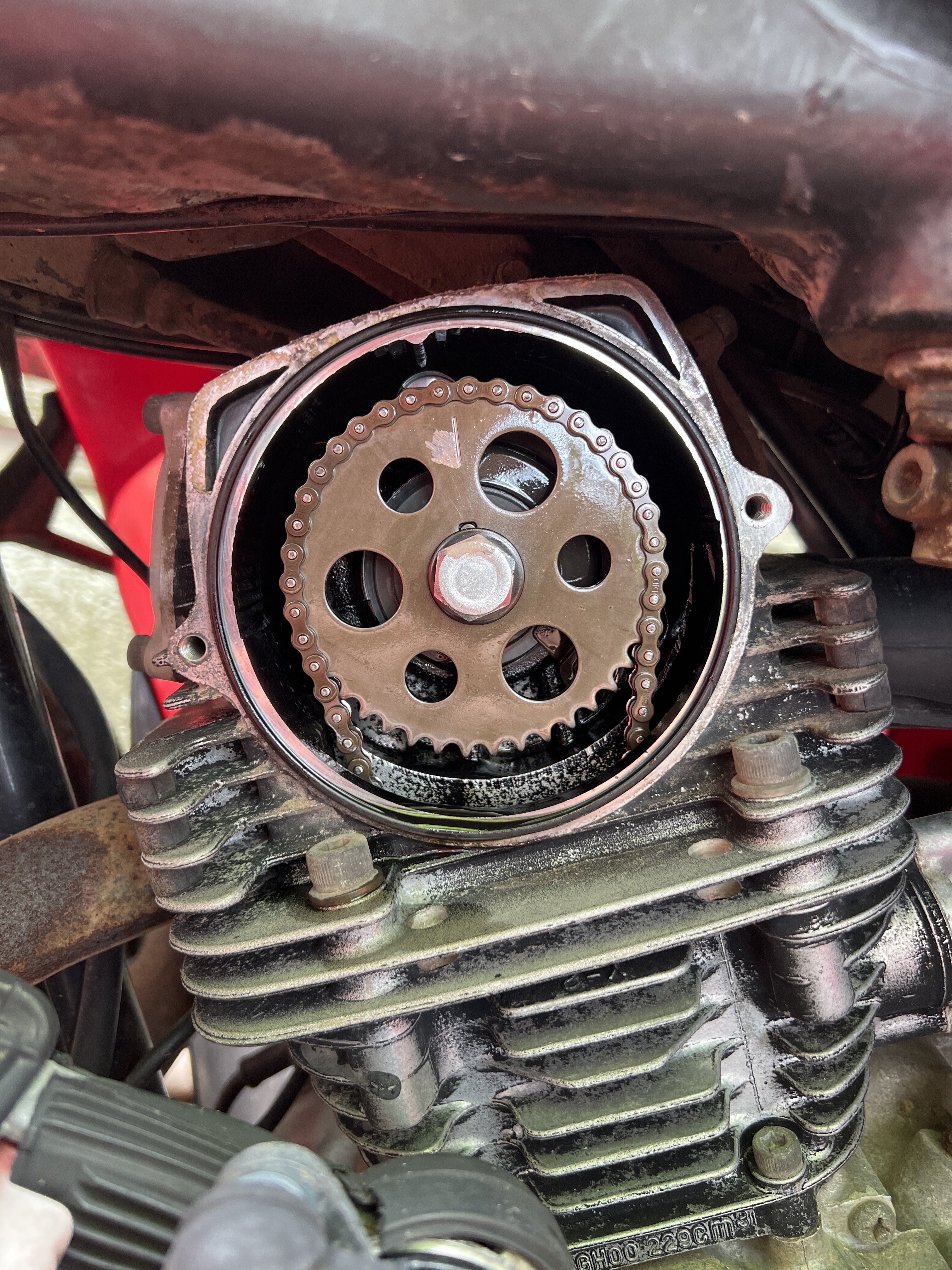

The cam timing is meant to be done using the T mark on the crank. The mark on the cam sprocket should be within a quarter of a tooth of perfect. That timing mark is almost a whole tooth out.. which may be right if you were using the F mark, which is for ignition timing and a bit advanced of top dead center. If that was on the T mark though then it could be improved.
I don't think that's your problem though, not the fact it's a bit out, they run fine like that, but, if there is too much slack in the timing chain it might make it surge. You could try adjusting the chain and then checking how much slack there is in it. Or check the slack, then try adjusting it to see that the adjustment is doing something..
To check the ignition timing you use a timing light and at idle speed the F mark should line up, then as you rev it the flywheel should appear to rotate under the light until you see two parallel lines(I think(, to indicate full ignition advance. That full advance should be at fairly low revs still, perhaps two three thousand, and then the timing should stay between those two lines. If the timing goes past those two lines it's too advanced.
