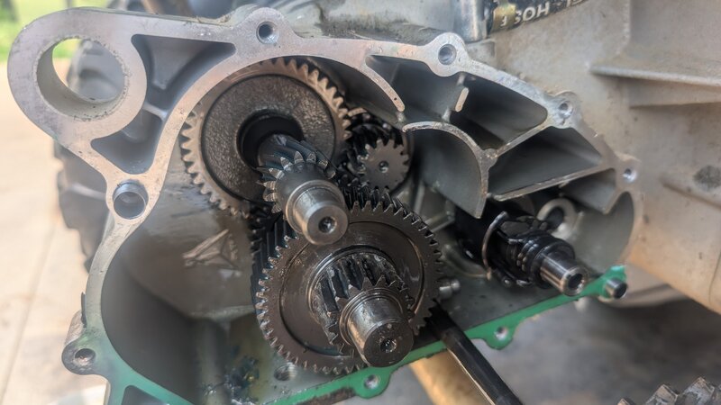

Just purchased the subject 150.  It makes a crunchy chunky sound when reversing. There was a lot of slack on the chain so I assume that was it, but when I took the chain off I noticed that the transmission output shaft has a lot of slop in it. I have to assume that's not normal. Can anyone confirm?

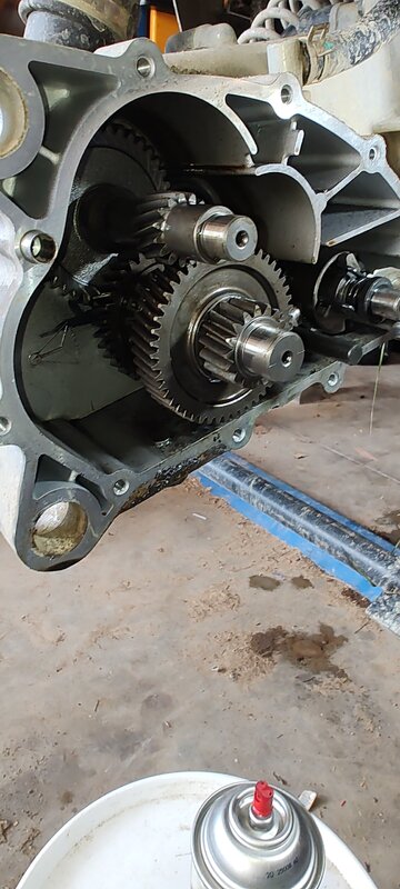

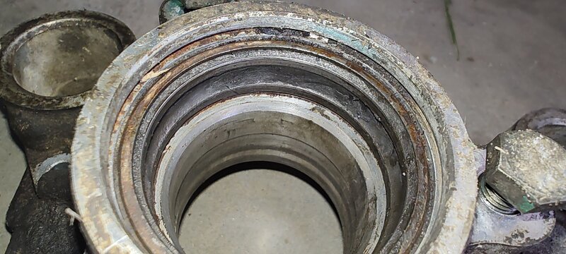

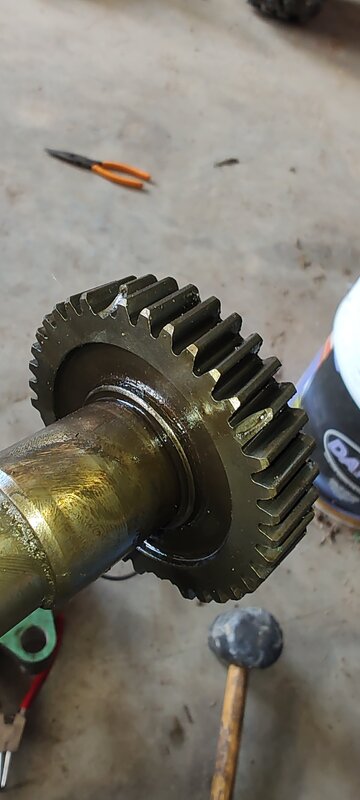

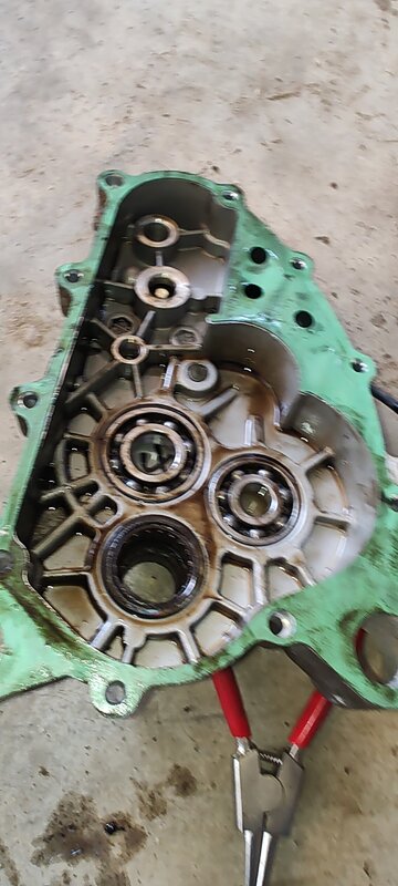

Wanted to add that I have now removed the transmission cover and found the problem.  There was less than two tablespoons of gear oil...  The transmission output shaft bearing was destroyed and the gear on the shaft is missing partial teeth at three spots.
So, oil, gasket, bearing, and gear I should be good.  I'm just glad I caught this before the transmission Frank totally.
