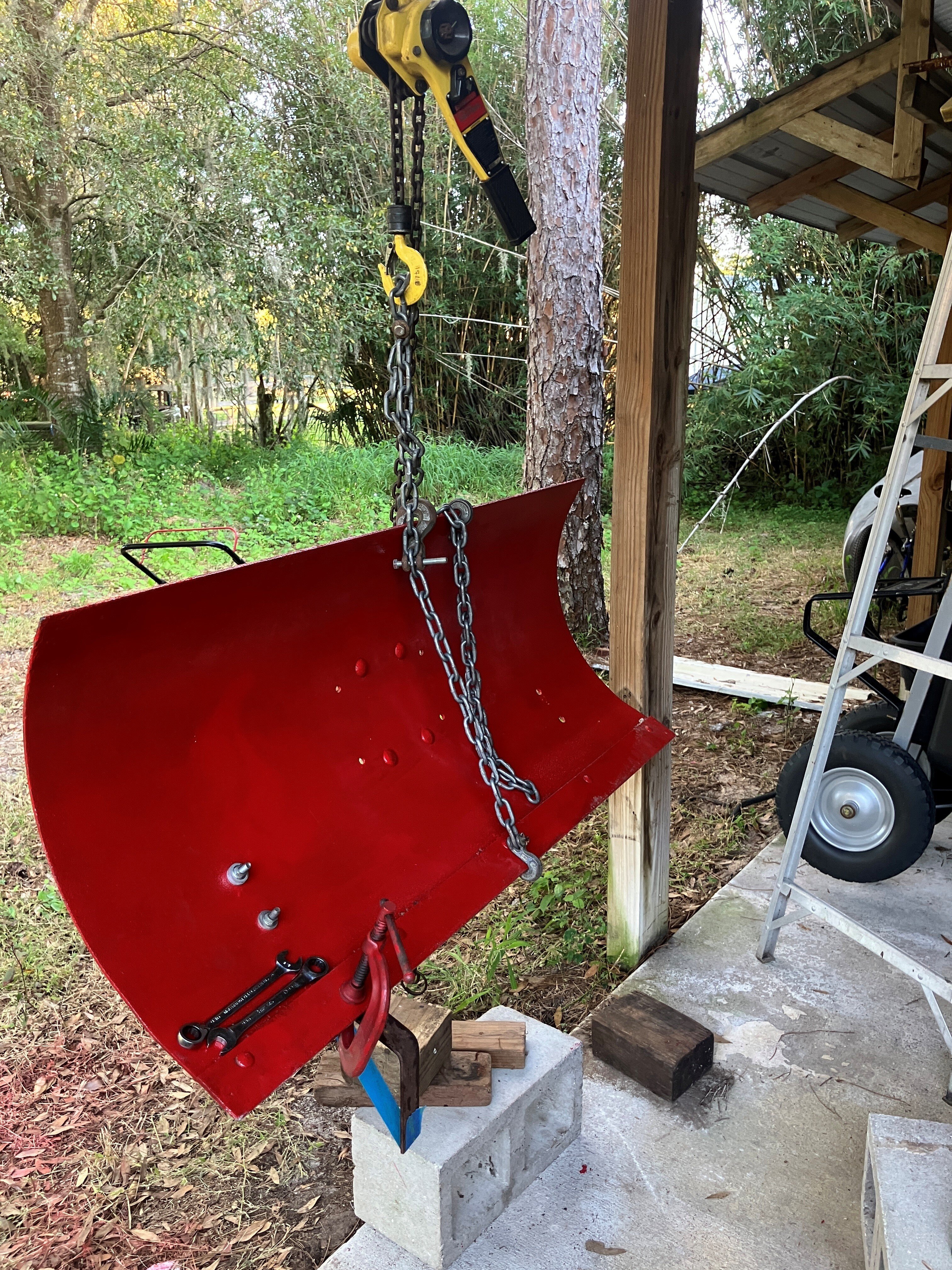

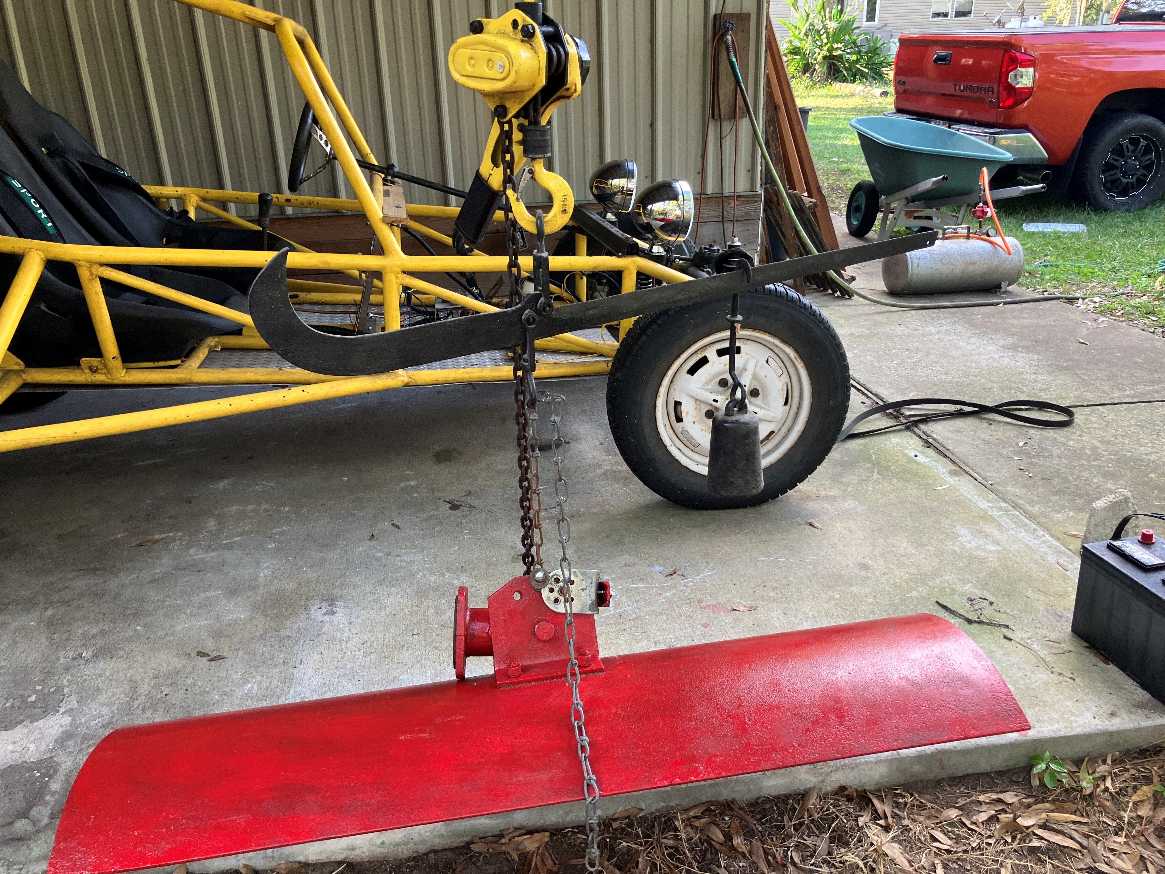

I got grandpa's Gravely snow plow out of scrap pile and repainted and made skids for bottom of plow (with help from Mikeexplorer)  pictured is on Grandpa's old machime. Mine is in WVa.  don't know about fitting it on my SXS or the Foreman.  Two sets of skids one 2 inch clearance and the other 1/4 inch clearance. It is 48 inches wide , 3/16 inch steel...heavy!  but evenly balanced when on the Gravely.
The snow plow mounted has slight down pressure and plow can be easily lifted buy operator pushing down on handle bars.  Going up hill requires operator to lift handle bars to overcome drive torque and keep plow down.
