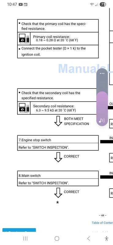

Need a little help fixing a no spark issue. 2002 BT with the 2 wire ignition switch. I have 4 stators and 2 CDI's and 3 coils to test. The new stator reads 218 ohm, and .2 ohm, the one that came out of it reads 50K and .2, the other is 132 and .2. All of the coils are 0.00 ohm, and there is no way to test the CDI that I know. I have also confirmed the replacement stator pins match the factory locations. I did try to test milli-volts at the coil to see if it was getting any signal from the CDI but nope. IDEAS?580930464_10231274362983475_2810713110069776492_n.jpg.348c09b7dfbccf104f7f10108b0979b4.jpg

Thanks for the input. The pickup coil has a range of 197-231 in the manual and mine is at 218, my primary coil is at .2. So according to the manual they are both in spec. I also checked AC voltage and it was in spec for another page I read. I am getting nothing at the orange wire going to the coil primary. I put my fluke on AC milli volts and get nothing. So no signal from the CDI? I have an original CDI and a fleabay CDI. What are the chances both are bad?

I have 3 coils (photo above) and tested all three. The primary on all 3 was 0.01 so I think my auto ranging fluke was ranging in the 200k setting. The secondary coil was between 6 and 9k on each of them. It looks like they are good. Thanks for the straight forward questions. It is helpful to go through the basics step by step.

Yep, that is what I am talking about. Look in my picture and you will see 3 in the upper left corner.
