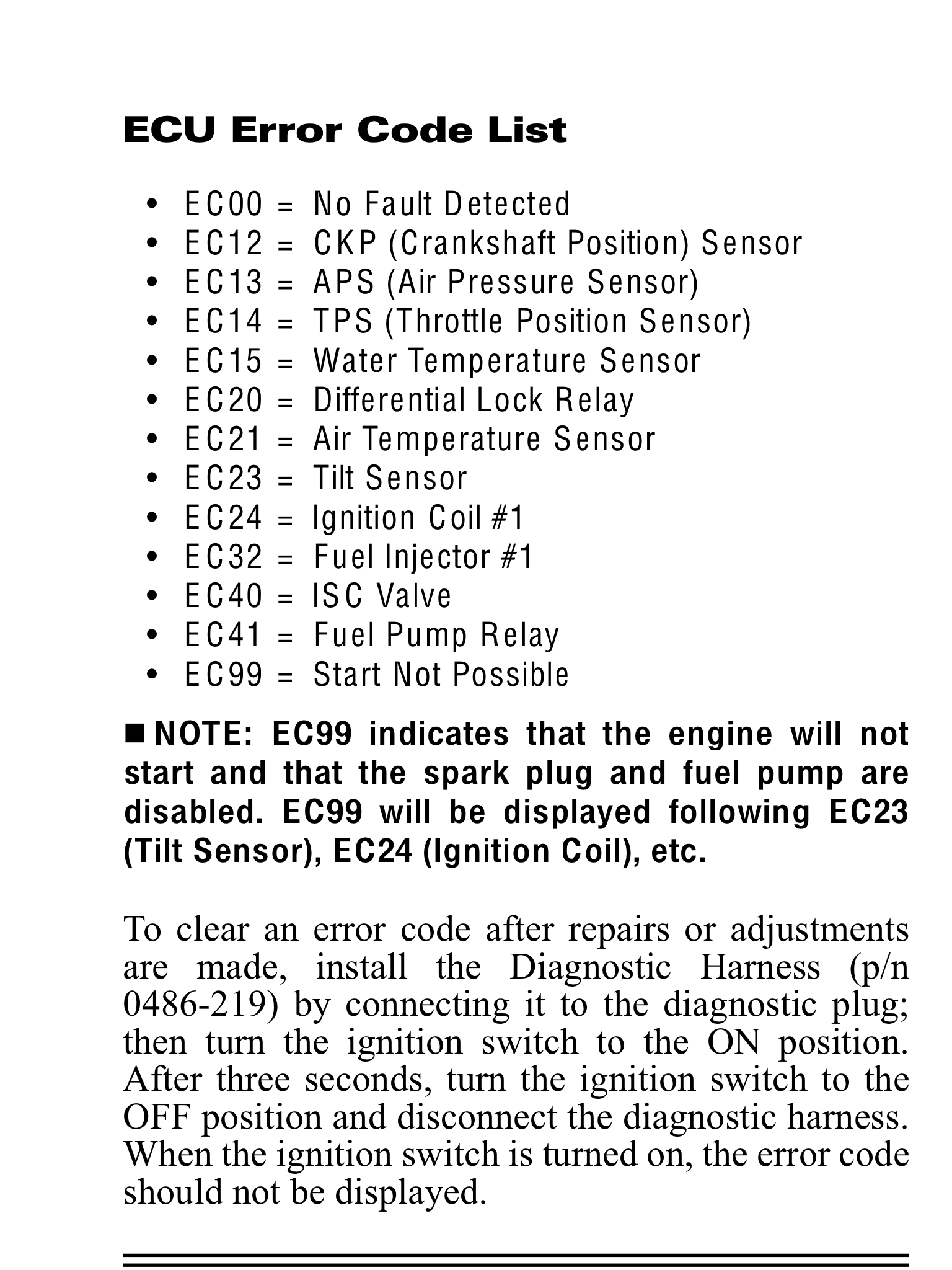

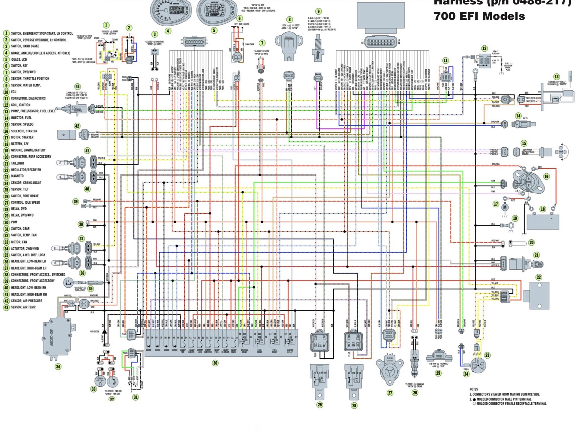

here are some codes from the manual. Also the wiring diagram because I believe multiple codes at once is telling me power to all 3 sensors is interrupted. See wiring diagram attached. Possibilities include bad fuel relay, chaffing fuel power wire, or what I’ve been dealing with on my quad is corrosion of connectors in the ECU plug.
