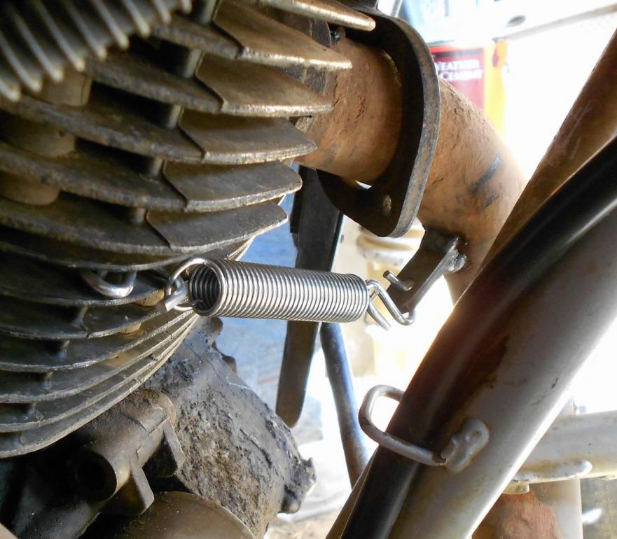

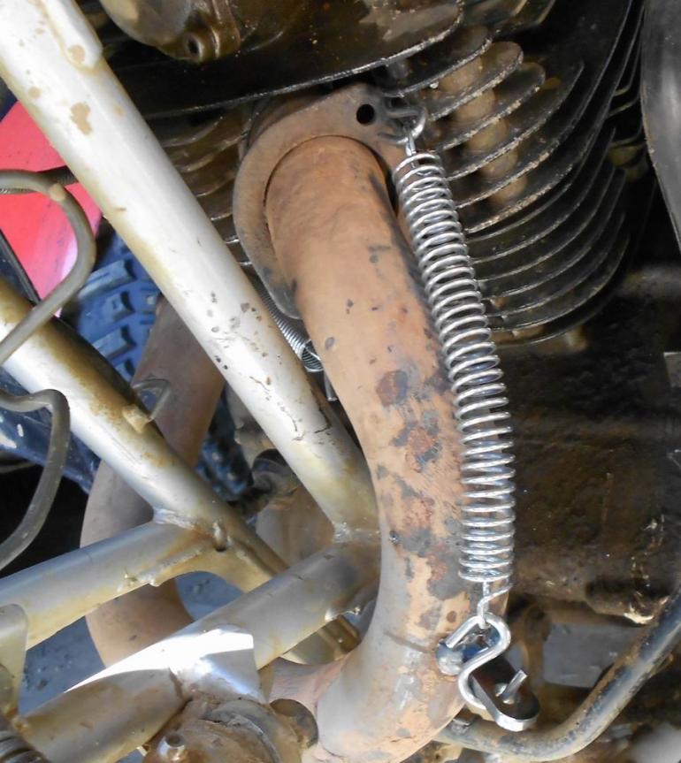

Guy at work gave me a suggestion. In which case it worked.
Update on this. I broke a tap in the hole that was missing a stud. It was stripped out so I drilled a bigger hole and tried to tap it. Broke the tap and when trying to shatter tap to get out it broke out the hole. Not getting anything in that spot. The broken stud I center punched it but the drill didn't like the center. It moved over and messed up that hole.
