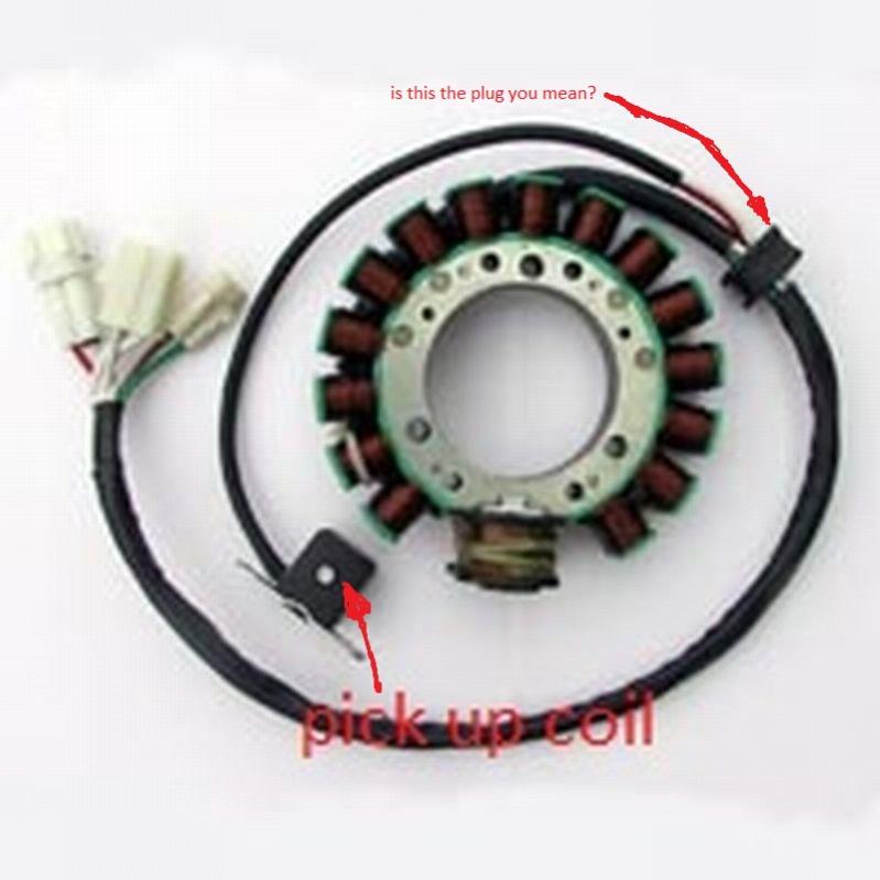

My sons 2000 yamaha warrior will not start. It will turn over but not fire. There is no spark @ the Spark plug. I can pull it off and it runs great. I tested the stator and the ohms were very low on one of the plugs. should i test anything else?? and if so how??? (i will apoloize in advance...i may not know the proper names of some parts..I have never done anything like this....I'm just a mom trying to fix sons bike...if i can. :frown:
I changed spark plug. Made sure wires going to spark plug had good connection. Tested the ohms from the wires coming from stator. One read 291 and the other much much lower, although i can't remember the exact #. sorry. I should have given you more info. hope this is better and thank you so much.

The screws that hold the pick up coil in are really tight and I don't want to stripe them. Any advise. Sorry fpr type
o'S I am using phone with gloves on. Didn't want u to think I was completely stupid. Ha
Edited by yamamama
mine were in tight too, sometimes if you give them just a little tightening, just to move it ever so much, it breaks it free. then you can back them out. you can also try keeping the screwdriver in the slot, and tap it with a hammer...

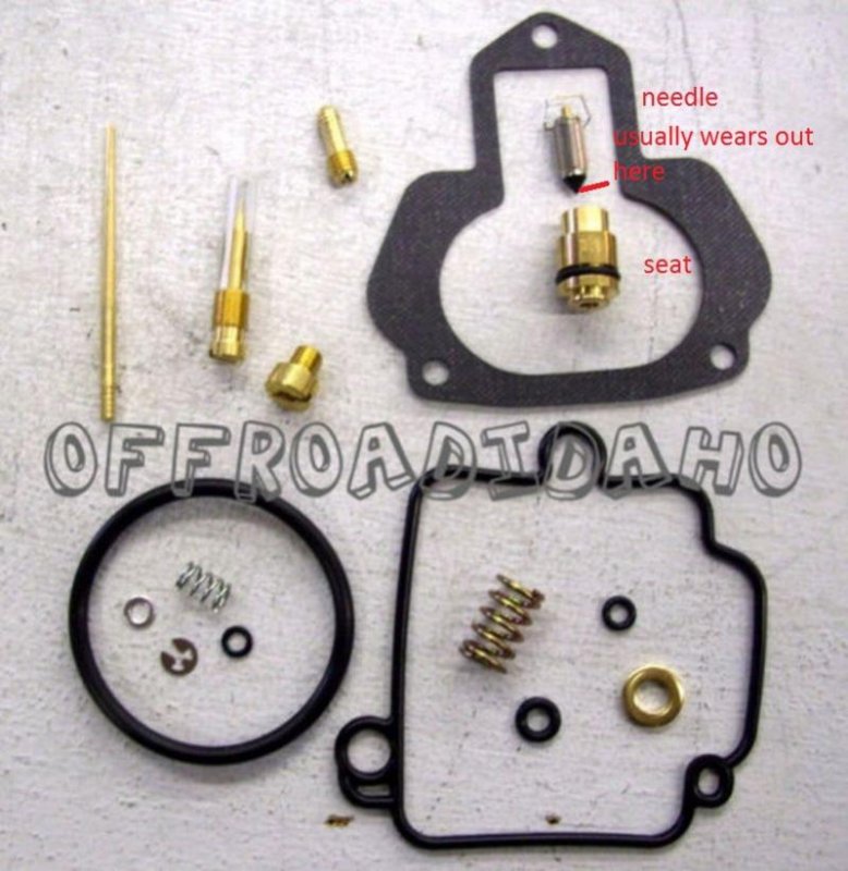

ah right on!! just time and perseverance is the key. i'm, struggling with a carburetor right now and all i want to do is find my sledge and put it out of its misery :laugh: but that's why i just took another break away from it .... good news yamamama !!
Will try just spraying carb cleaner 1 st (. Sorry for bouncing around..easier to post here by phone). Also,I only here the soud when in 4th and 5th gear. Don't know if that helps any
