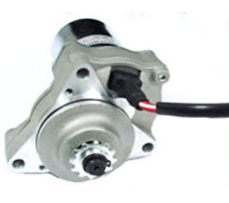

So you tapped it with a hammer and it started? If so, you may just need to replace that starter motor. I would test a few times again when it doesn't start. You can find these online and if it looks like the image below you can get it on Amazon for @$24
MEERKAT 50 ATV STARTER MOTOR
Yep it started then took it outside it started again. Went to start riding and it cut out, tried the tapping again didn't work. Do you think the valve could need tightening? It was fine all day yesterday running with no problems first time. I'm so confused lol
