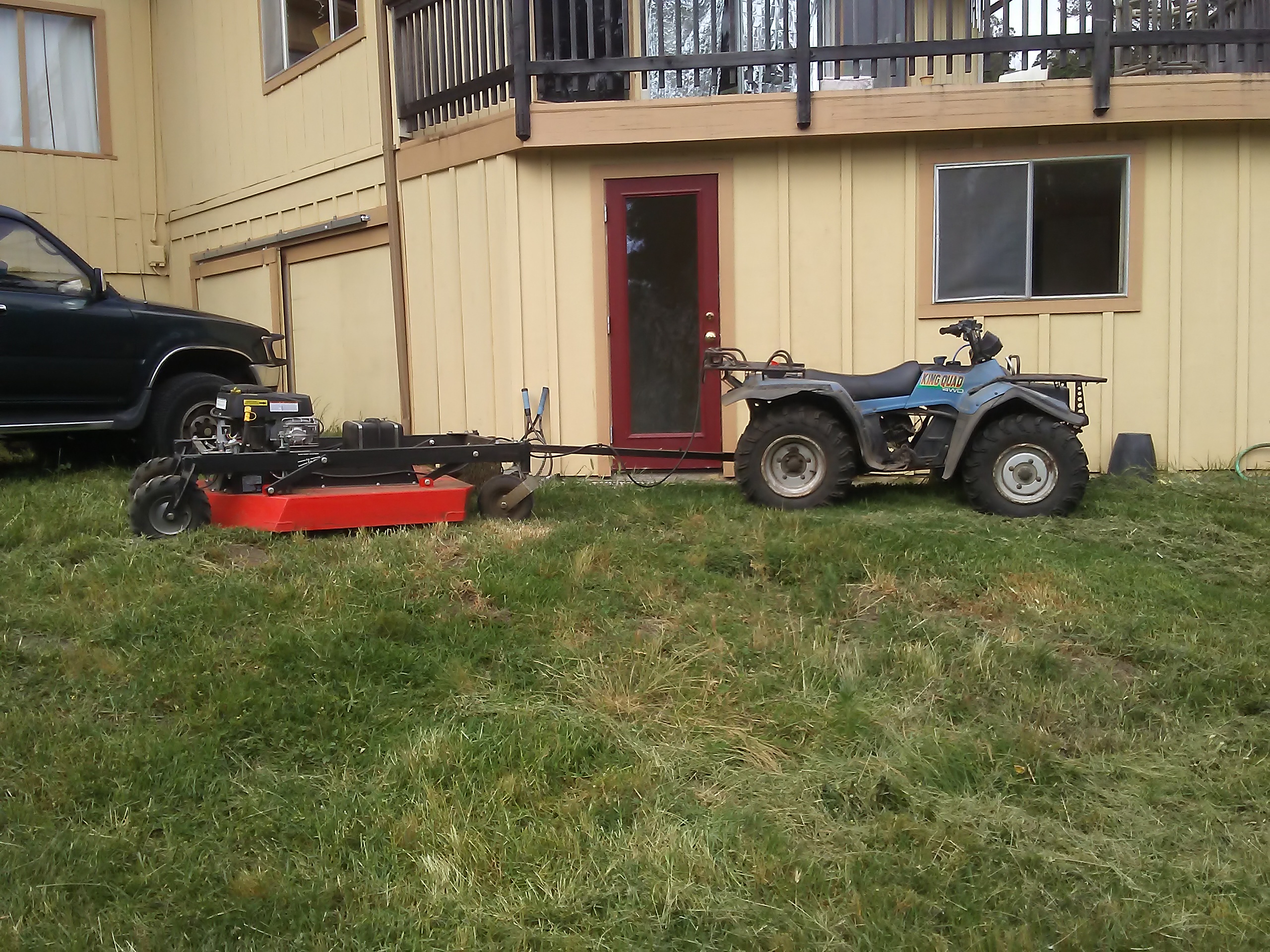

Thanks for the input, did order new switch from Caitric got it yesterday and changed out. However the new one is mis manufactured as it has to long of a sleeve and not enough thread length to allow tightening down securely. Guess that's why it was so cheap🙄 So since I had the old one out, cleaned all the contacts, new dielectric grease, metered all connections and it looked good, so plugged it in and it fired right up everything working. Time to go mow!
