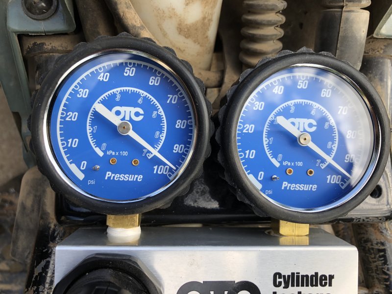

Leak-down shows no issues, either warm or cold (even did it with the oil filler cap off...just in-case of a plugged crankcase vent):

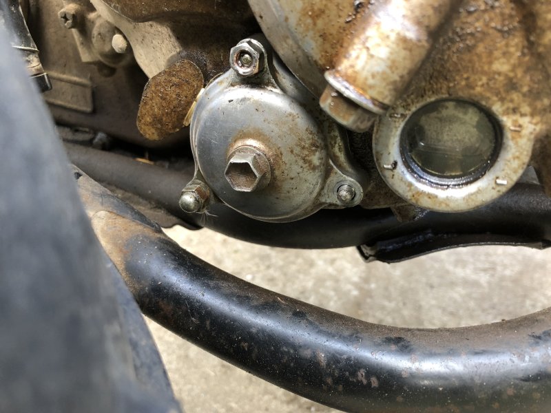

I can't tell if the bike is burning oil or not, as the seller left me a little surprise (yea, it drips from the cover ~10x/minute while the engine is running):
I'd expect blue smoke on starting it this was a valve issue...but there's no hint of smoke when the engine is started/ran cold. I'd expect a leak-down to show pressure losses if this was bad rings...but cylinder holds pressure whether hot or cold.

Oh, and a straight compression test shows ~148PSI...well within spec.
