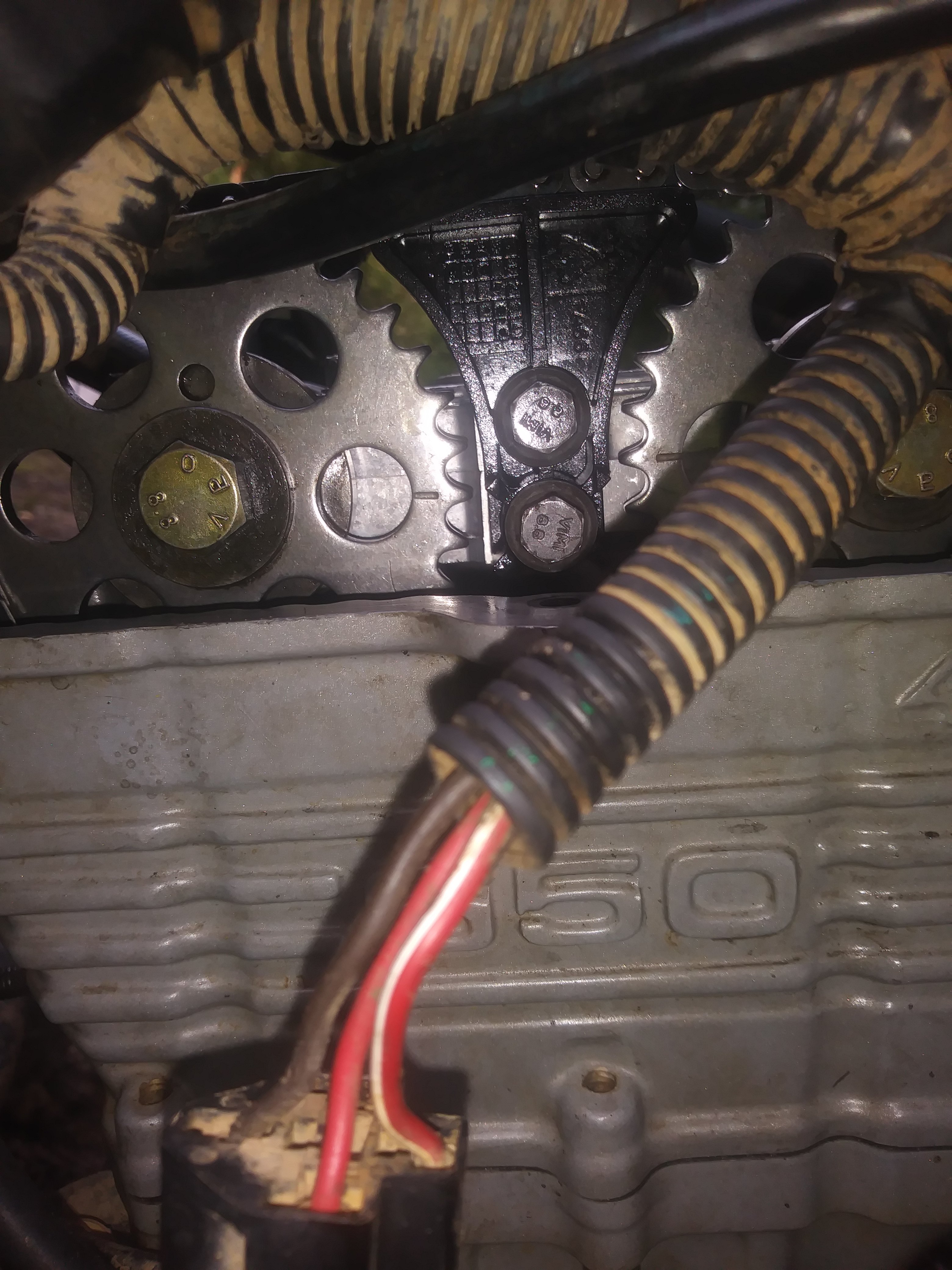

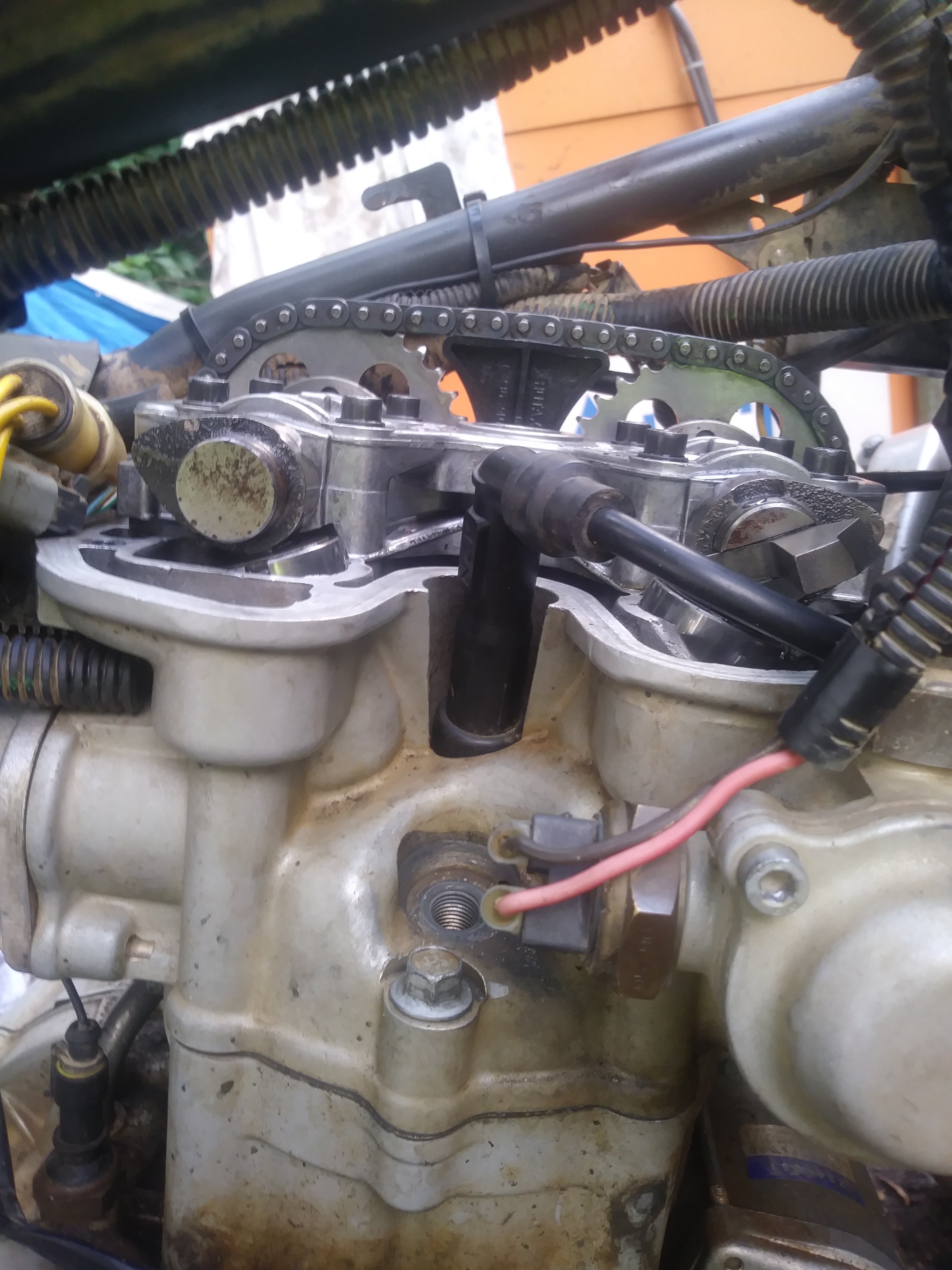

Ok guys needs some help asap ready to set this thing on fire..thing would never start valves were tight i adjusted the calves to correct shims on intake n exhaust have plenty of clearance in between cam lobes n shims..problem is i done set tdc about 10 times now its dead on..will not fire one hiccup sprayed gas into carb while cranking n while not all it does is make a loud backfire n some flames come out. Its like valves are tight but  there not.idk how it could be firing wrong with it at tdc. I need help asap
It’s most likely 180 deg out of time. It’s very easy to make this mistake.
There are also a few different marks on the flywheel. Make sure that you have the correct mark and make suite it’s on the compression stroke when aligning with the cam.
Aside from the few things listed above the only other things I can think of is the timing chain is jumping off of the sprockets ? Or the pick up coil is loose delivering the spark at the wrong time.
Yea figured it was out of timing as well but set it tdc then aligned cam marks parell to head cams facing away from each other.. There is only one mark on flywheel. Other marks are lil punch marks about 4 or 5 of them around flywheel..tensioner is working properly so its not jumping teeth..sounds like it sparking at wrong combustion..how would i check to see if its not 180 out?

You are missing something. I looked at the manual and can see that there is only one timing mark that’s labeled “c” ?
The  lobes state they should be facing downward and there is a small hole on tye cam sprocket that should be on top ?
I would go back double check that. If all looks right then I would look at tye triggger cool maybe it’s loose ?
Can you post a few pics of the timing marks you see on tye engine as well as the top end cam and sprocket ?
Yes i pulled head off to instalm new shims.no guy said all he did was changed starter clutch n it would never fire for him after that so i reset timing n still nothing. Cams dowward as in tapered part touching valve buckets? If thats the case then yea there off. I have them at 45° facing away from each other as cam sprokets marks are parallel to face of head.

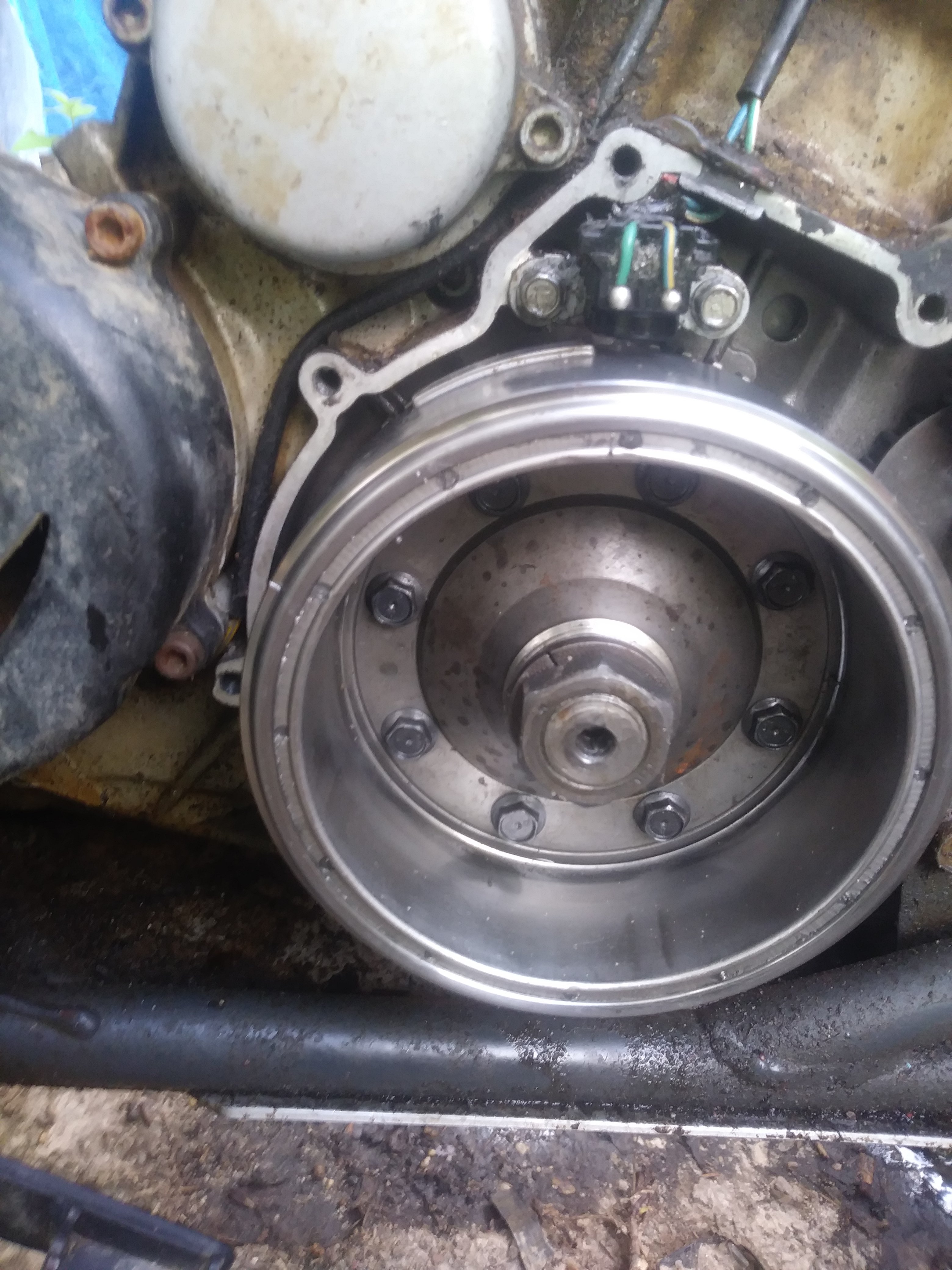

I dont get what he was doing when he said he reaches his hand around on clutch side n rotates it.? Does the pick up coil have to be aligned up with that rasied edge on the flywheel. Cus the way i have it at tdc pick up coil isnt in center with it.

Also when at tdc everything lines up on top end except for flywheel mark doesnt line up on case mark.pickup coil instead lined up with raised edge on flywheel either idk if that's normal or not.?
